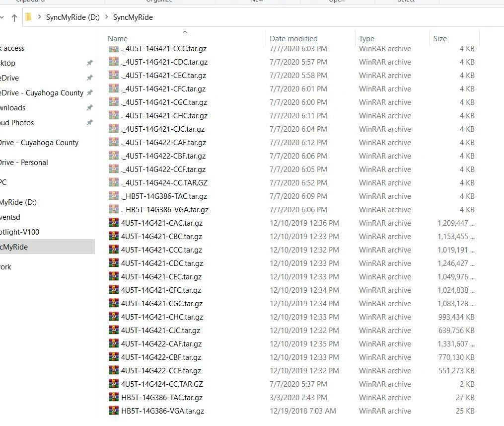

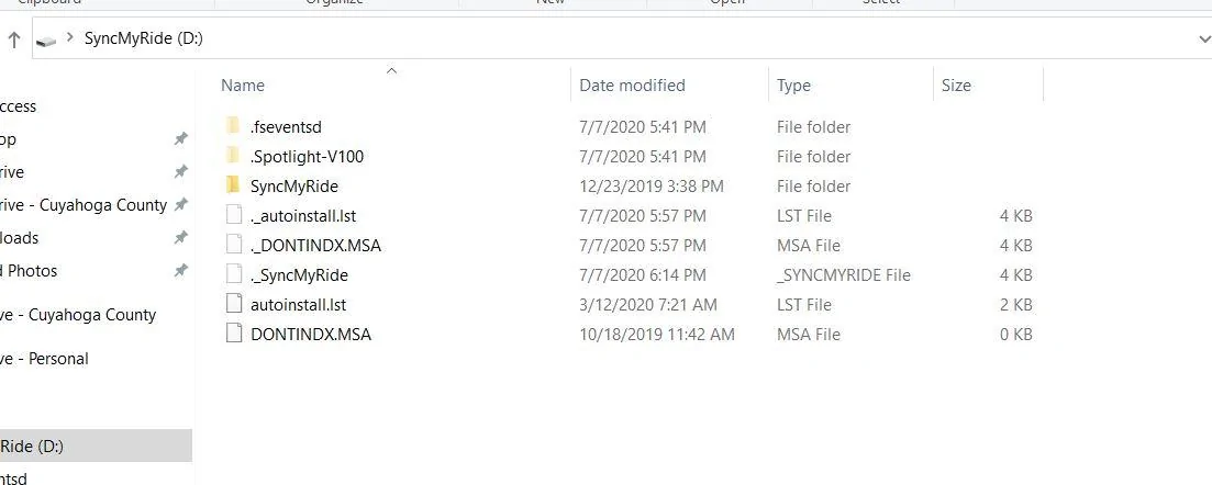

I seem to have issues with Sync even acknowledging my USB Drive. It keeps giving me an "USB Not Supported. Please Remove" error. I am using a Cruzer Glide 16GB, formatted to exFAT like it says, and placed the files on the drive correct (I think? See attached) per the Ford instructions (The three files from the Sync3 zip and placed the License File in the SyncMyRide folder).
Note, the below attached photos show the jump drive AFTER attempting to install the update. I also used a W10 laptop and Macbook to format/add files. Neither worked.
