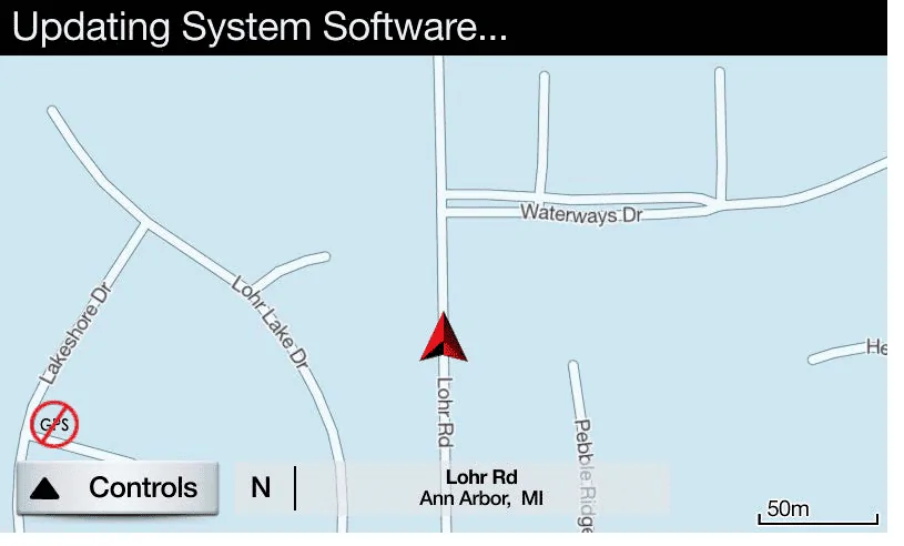

Quick question. When it's updating the software, it should say "Updating System Software" up top the whole time, correct? (See example picture)
I see it for a brief moment on my display and then it goes back to displaying the time.
The USB became very hot to the touch after a while. It's a Sandisk Extreme pro 3.0
I used it before on my last update.
You do not have the file structure correct in the USB. The software is very intolerant of any structure errors such as duplicate files, extra files or misplaced files. If done correctly the updating system software will remain on for the duration of the install, which takes ~ 57-60 minutes. Others here stated just under an hour but someone stated 90 minutes.

You do not have the file structure correct in the USB. The software is very intolerant of any structure errors such as duplicate files, extra files or misplaced files and it will abort like you experienced. If done correctly the updating system software will remain on for the duration of the install, which takes ~ 57-60 minutes. Others here stated just under an hour but someone stated 90 minutes.
1. File structure- USB 3.0 drive, formatted exfat, labeled SyncMyRide
2. File structure-The root of the USB drive should contain 2 files and one folder named SyncMyRide. The files are named autoinstal,lst and dontindex.msa
3. File structure- The Sync my ride folder should contain 15 tar files, one of which is the license file. The easiest way to ID the license file is its size. It is 2KB
I really did not notice any file name changes in the diag screen in either SW versions or APIM/IVSU versions. At the very end there is a short flash saying it is ok to remove the drive then it reboots. There is another very short flash saying software updated.
* I used the USB port closet to the driver- turned off auto off feature, turned of auto stop feature and most importantly sat at the beach watching people walk and surfers sailboard while it worked.
IMO, a very clunky procedure with lack of clarity to install.
