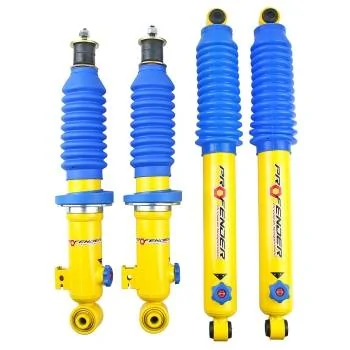

I know the O.E. Fox suspension on the F150 Raptors is rebuildable.
But I'm not sure on the Tremor suspensions. I'll bet the OP can find out though.
If I were a Tremor owner with no plans to upgrade my suspension, I'd be scanning for low mileage takeoffs to store for future use. I can't imagine a person lifting a Tremor would want more than about $300-$400 for front strut assemblies and rear shocks.
I am very happy with the adjustable profender-shocks from thailand (the land of the ROW Ranger). They fit my needs very well. very cheap in comparison to the fox and the usual FoMoCo aswell. Easy accessible knob to adjust rebound and compression. … ? and it works! soft for dailydrivin, firm for the days carrying loads or want to shred.
UPDATE: seems they didn‘t sell the “budget line“ in NA … payed 350€ for the set last year. And Yes, the colors are a mess…?
