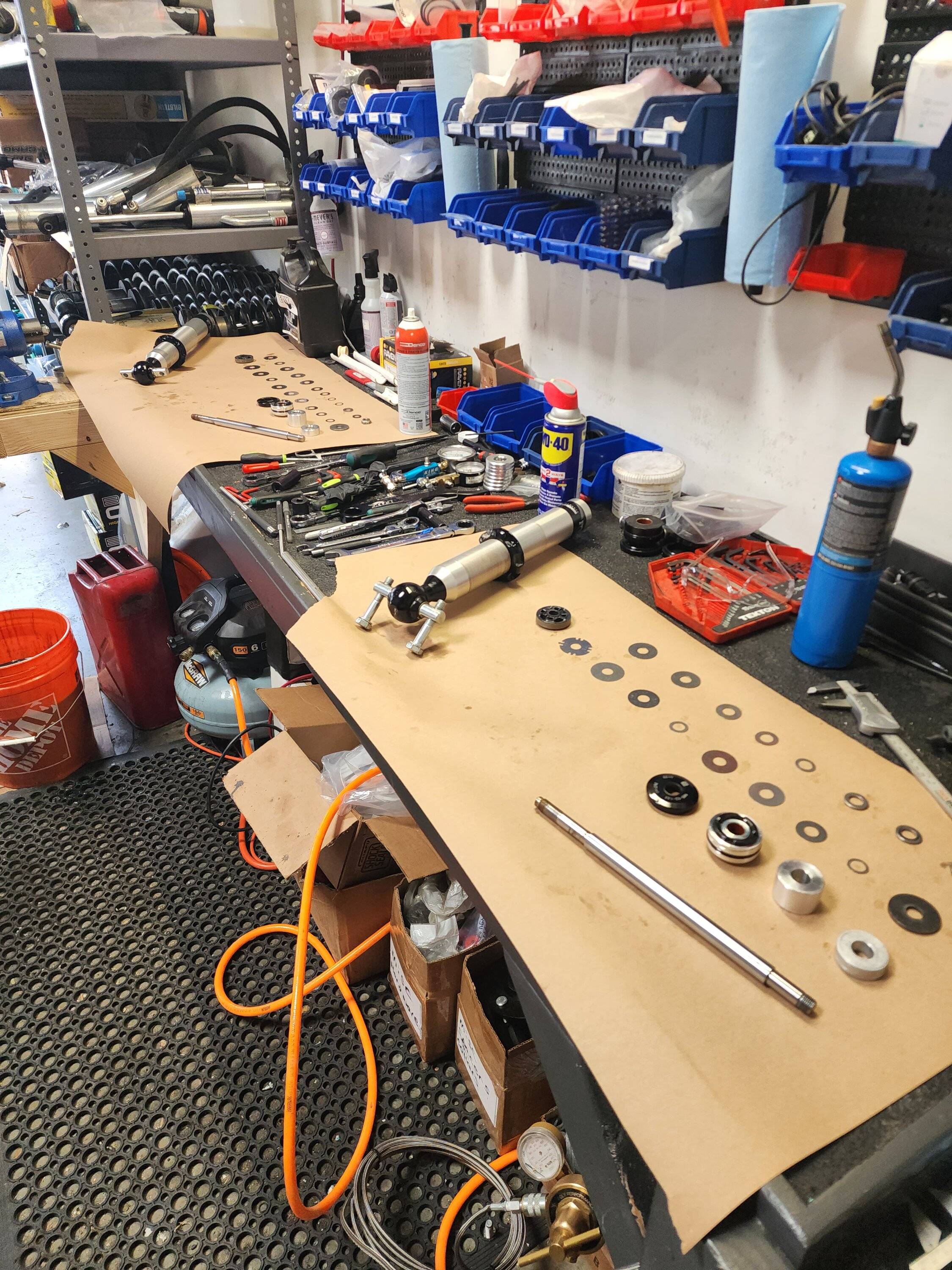

We're planning on doing
I wonder if most folks that buy Ford Performance Fox are even aware that they need to be rebuilt? Glad I went with Bilstein.
It's not as simple as Fox vs. Bilstein. These are very different shocks. You should buy a shock for your use and budget. There many quality brands but some need service.

Fronts are apart now. Everything on the shock it self is identical except the valving...
So which one has softer valving? Are the internal volumes essentially the same so that only difference is in valving? Would an average enthusiast even be able to tell the difference between the two on their own truck?

So after reading this, watching the YouTube videos on both the teardown/rebuild (), am I understanding right that the Ford kit seems to be valved to be firmer? As most my driving is on road and only a few trips trail riding each year, would the Ford variant be better?
@Stic-o the video was super helpful! I was looked around the channel and saw the Fox 2.0 on the Ranger review with the guys as well. Seemed like the consensus was that the Fox 2.0s felt almost too soft. Did I get that right?

Yes, the consensus was that the Ford variant was firmer, but never got a chance to run the two versions back to back. Would the average person be able to tell? Probably not. The Fox's were soft, but really geared to doing off road more offen.
We're actually planning to pull the eibach off my truck soon, and move on to Dobison IMS.
