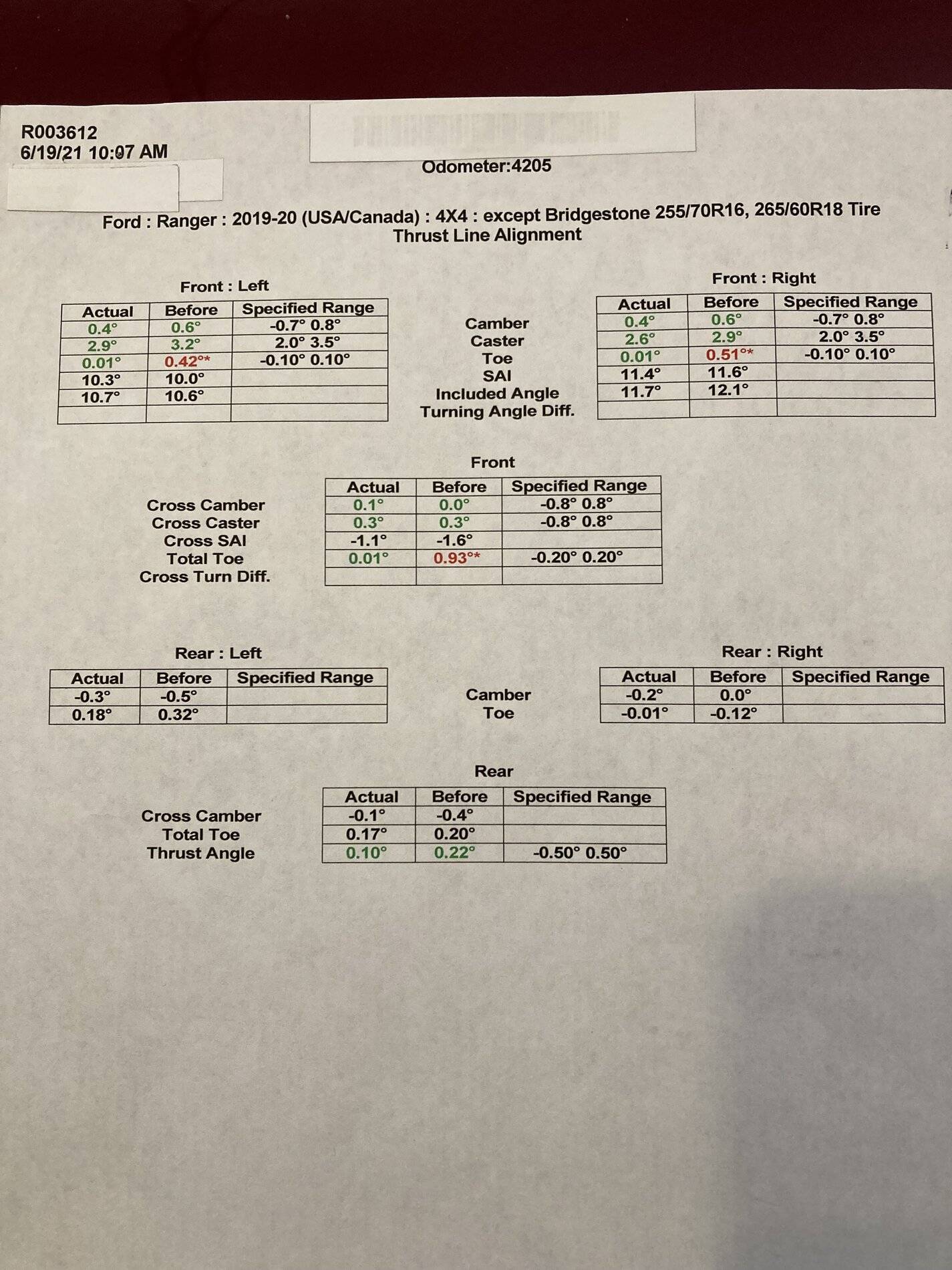

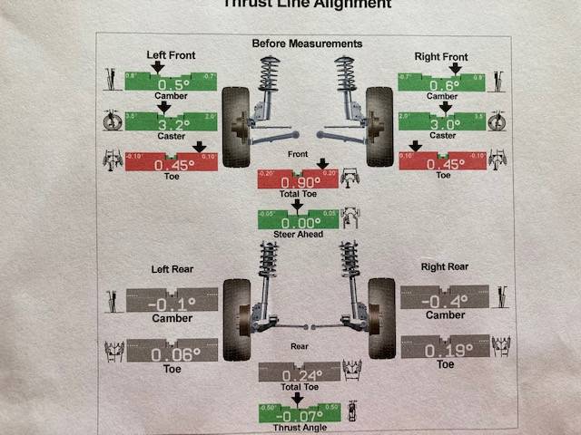

I was surprised at how little the Ford/Fox kit affected my alignment.
here are the numbers from my alignment after I installed the kit myself.
it appears the only thing that needed adjusting was Toe

Hilarious. I broke down and got an alignment. Why would you trust ANYTHING that someone from the 'dealership' says??? Do they ever tell the truth?
It is interesting to me they talked you OUT of something. Every time I go to the service dept they always try to sell me an alignment. regardless of why I am there.
The second interesting thing is your numbers were identical to mine.
