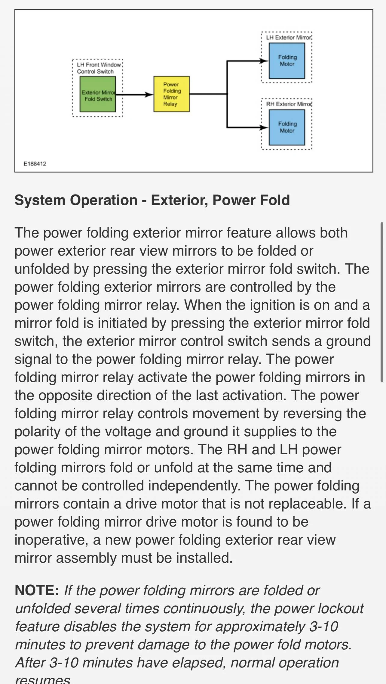

I know this is a old thread. But the Ranger folding mirrors are not controlled by a module.
Correct they are controled by the relay which is controled by the switch only. Thus, no auto fold without adding the aftermarket module.

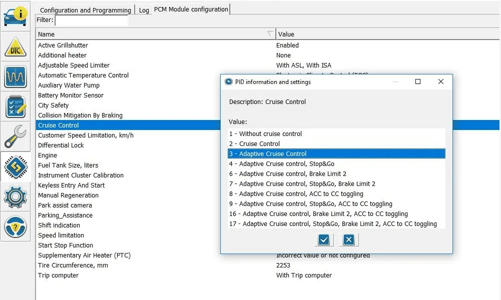

Question on making changes to the PCM - Does anyone have the GUI or "easy mode" option?
I don't in the current release of FORScan, only hex edits.
Mike, do you have a full version or the 2 month extended "free" version?
