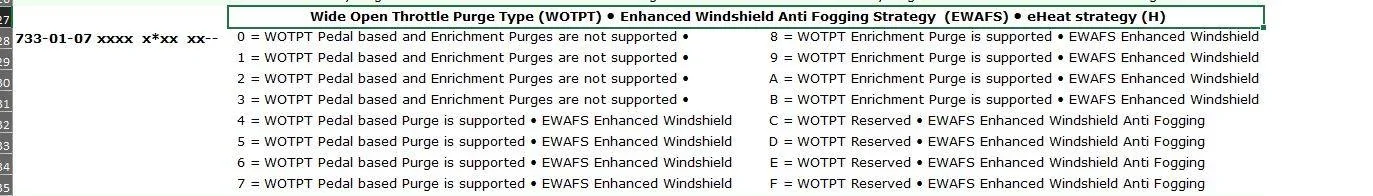

Saw this over on the F150 forums. This was one of the most irritating things the ranger would do in winter time, flippimg to fresh air every 10 min... Maybe it will work for you guys. I just did it on my F150 but it'll be months before I can test it.
If you want to give disabling it a try:
HVAC
733-01-07 xxxx x8xx xx (If OEM is A)
If you have a OEM as-built other than A, reference the spread sheet to find the correct value.
SSM 50015 - 2020-2021 Various Vehicles - Enhanced Windshield Anti Fogging Strategy (EWAFS)
Some 2020-2021 Ford and Lincoln vehicles are equipped with an anti-fogging feature known as enhanced windshield anti fogging strategy (EWAFS). This feature automatically adjusts airflow in the cabin to prevent the windshield from fogging up and may be perceived by customers as irregular climate control functionality. To reduce fogging, the EWAFS functions include: the air condition (A/C) button may turn on and off automatically, recirculated air may turn off automatically in all air modes except MAX A/C, recirculated air may also turn on and off automatically in various airflow modes in order to improve heating or cooling efficiency, and in auto climate control, high humidity conditions may automatically engage A/C compressor, increase blower motor speed and/or direct more air to windshield. Continue to monitor the Workshop Manual (WSM) for EWAFS updates.
https://www.f150gen14.com/forum/thr...an-list-database-spreadsheet.1578/post-154137
