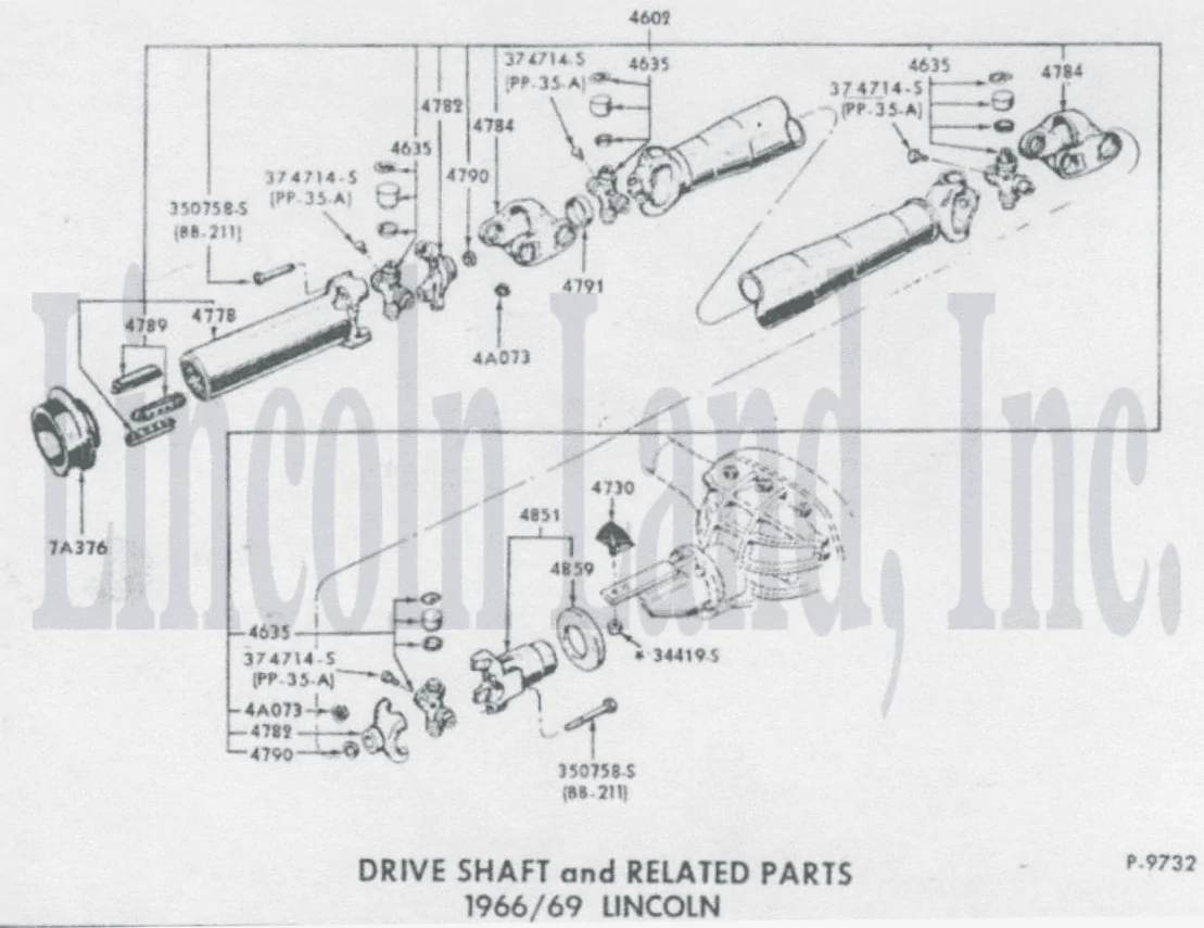

Smoothest drive shaft I ever had, the OE one in the 1967 Lincoln Continental. Worst driveshaft to replace the u-joints on, also the 1967 Lincoln Continental. 4 u-joints, with centering bearings at the front and back of the shaft.
Those had double Cardin joints, the back of the trans pointed down so far that's all they could do to keep it smooth, miserable U joint servicing.
