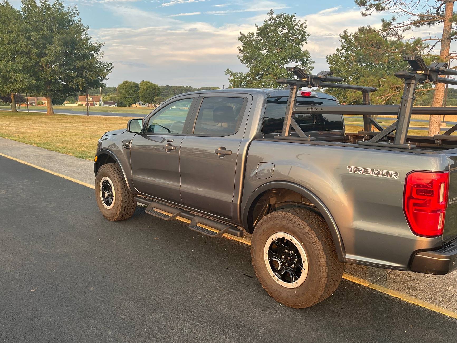

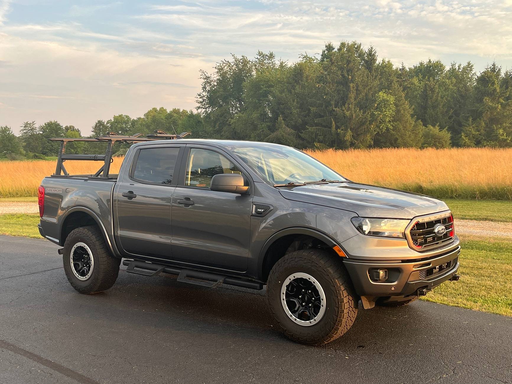

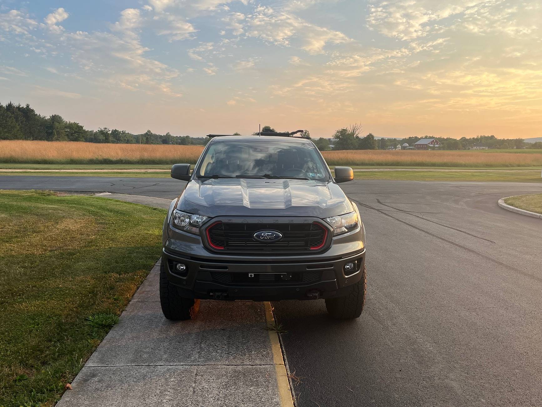

I struggled with what to put on my 2023 Tremor and ended up with using the ReadyLift 2” leveling kit and their anti-intrusion beams.
We followed the instructions and only put in the top spacer, but another member said he put in top and bottom. I asked him to post a few additional pictures, but no luck yet.
Truck still isn’t level, but between the additional space provided by the lift, the new intrusion beams and the additional offset provided by the new wheels, I was able to get full clearance for 285/70/17 tires, so mission accomplished.
