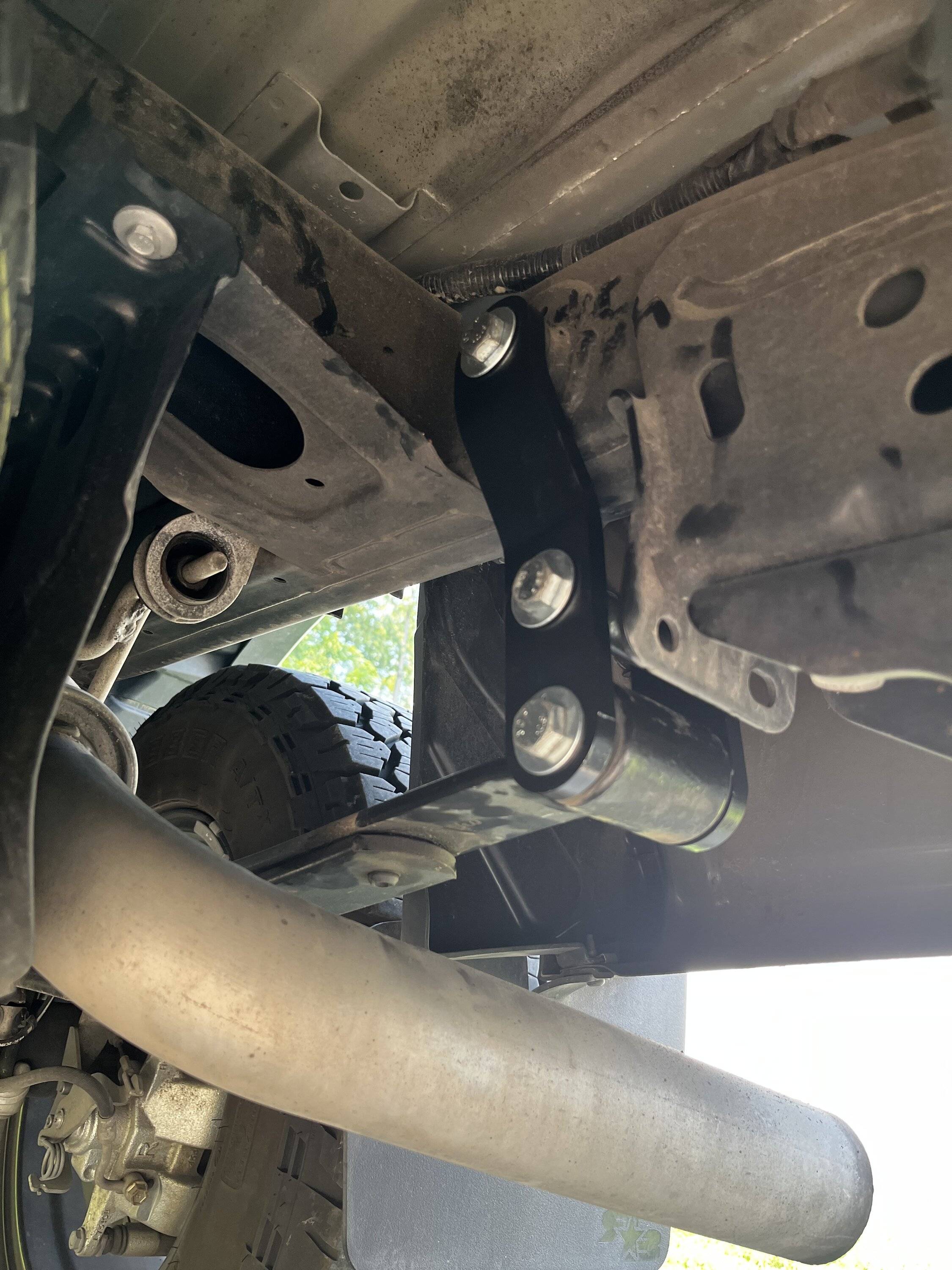

Try doing a BDS rear shackle lift to improve the rear pinion angle.
Has that worked for others? Seems dropping the carrier would accomplish the same thing.
My Tremor sits way high in the rear as is. It would be even worse with 1" added. Granted, I do have a 2" FRL level on the shelf. I've been holding off installing until I get the shudder figured. I think it would be a stinkbug with that BDS shackle even if I had the level kit installed.
I saw two mounting holes on those shackles. Is one stock height and the other lifted?

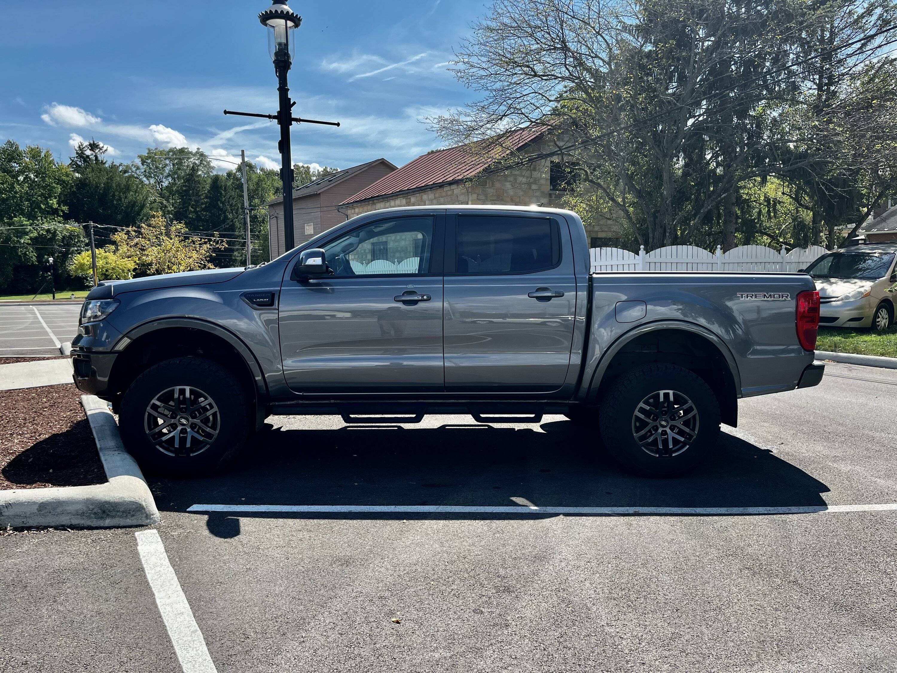

2” front level with bds shackle lift.
That looks pretty good. Did you have a shudder that was cured or minimized after the shackle? Assume the tremor rear shocks are long enough for the added height? That 2" level seems a little taller than advertised. Regardless I'm interested.
Its hard to describe. I am not sure if it was a shudder or just hard shifting at low speeds. I am thinking more of hard shifting.
I installed the BDS shackles the same time as my CAI and the strange shudder/shifting behavior seems to be gone for now.

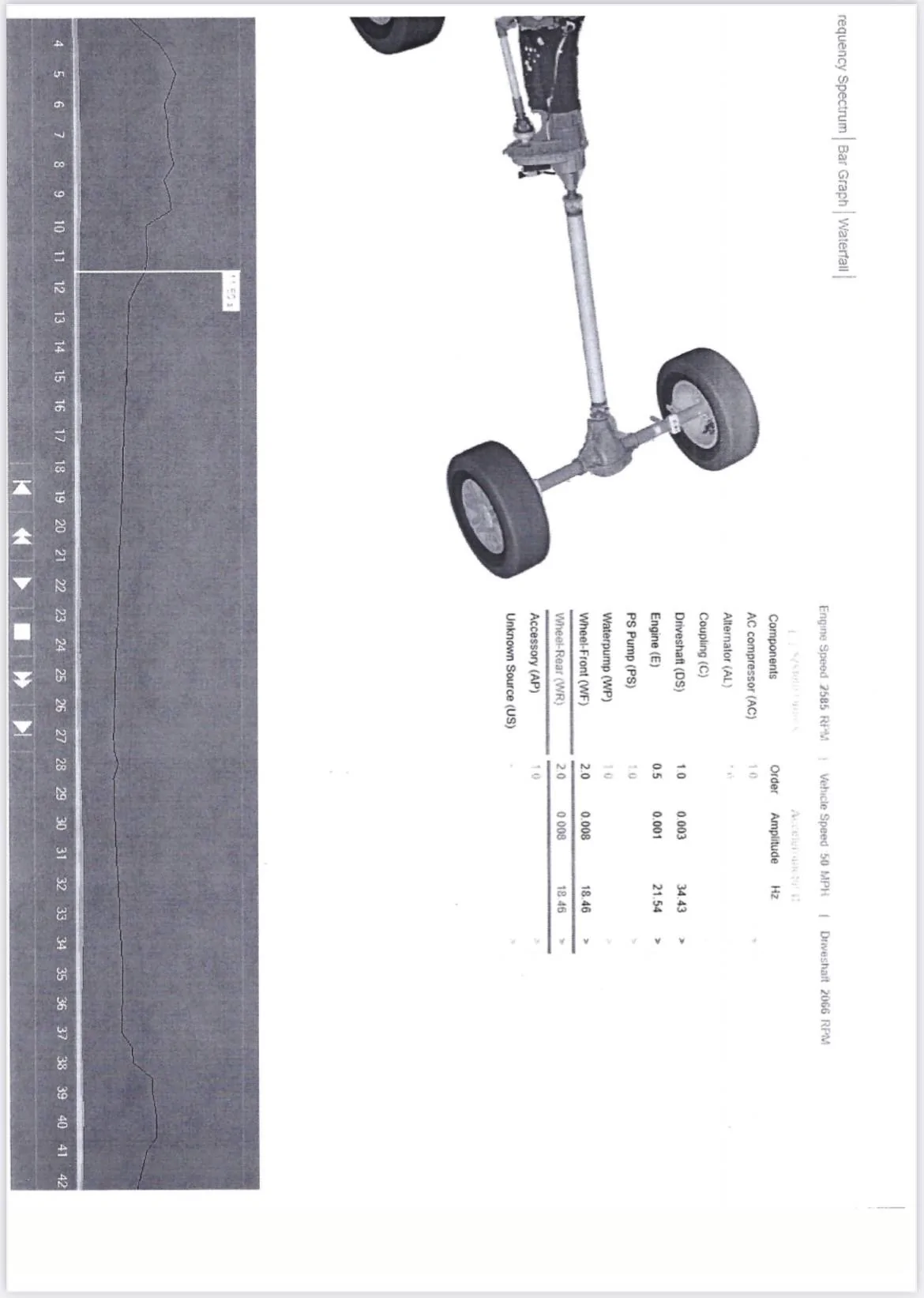

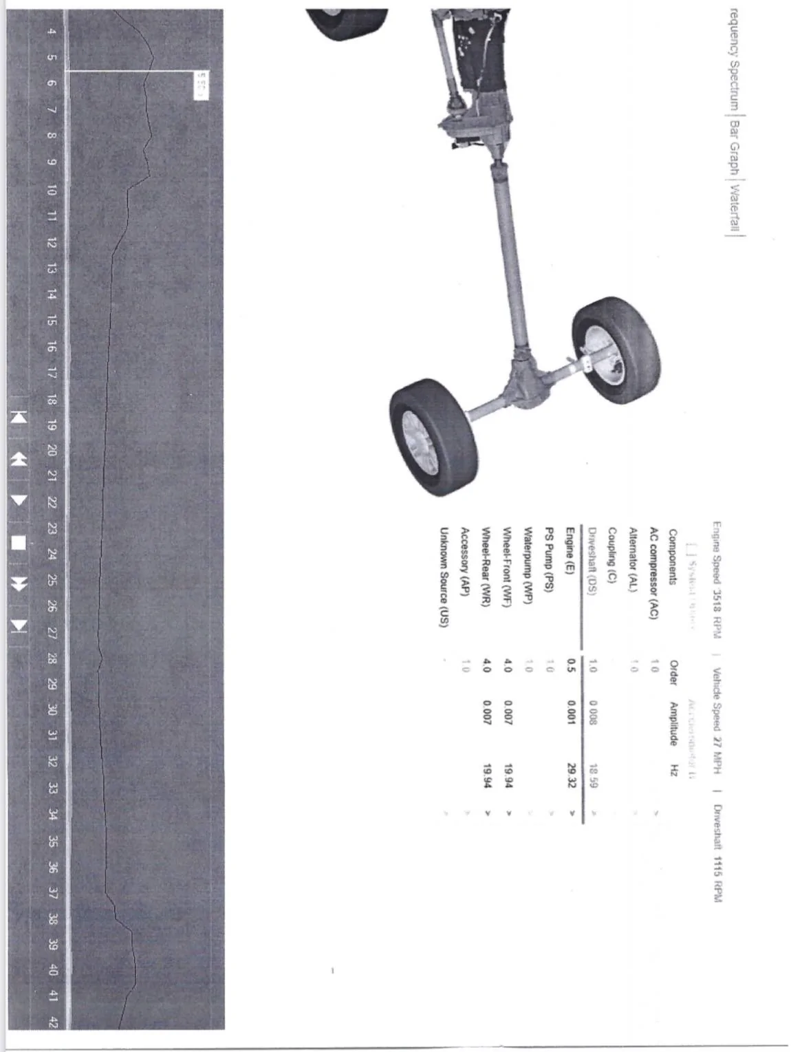

im sure someone mentioned here before but dealers (should) have gadgets to test for vibrations other than the employees seat of the pants. Phil explained it to me a while back when i was having issues with vibration. If i find the post i will put it up in here.
Stevedbvik1
Oct 4, 2021
2,771
8,369
2022 Ranger Tremor XLT
It’s called a VCMM vibration analyzer. My dealer used it to pinpoint a tire vibration issue on my Tremor. Still had to have Discount Tire find the specific tire by RoadForce balancing seeing the dealer did not have a RoadForce balancer
7,142
24,337
thank you !
