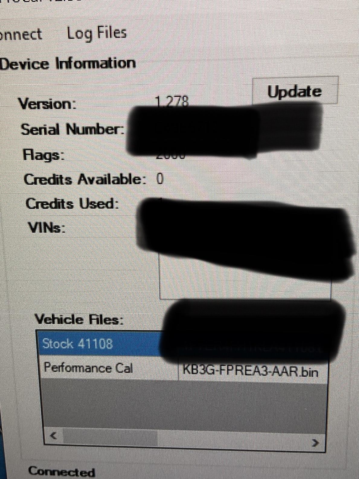

I bought a used Windows 10 laptop and installed everything just fine. When I heard there was an update I plugged my ProCal into the same PC and it won't connect. Windows Registry Error. Can anyone lead this non computer guy in the right direction?? I'd like to add the update......
I did my update a while back and I got a similar error. I had not used that particular laptop for awhile, so I ran some Windows updates, then updated to the newest version of the software (not the newest version of the tune). It installed an additional .NET update, then everything worked as expected.
Thanks man! I'll give that a try.

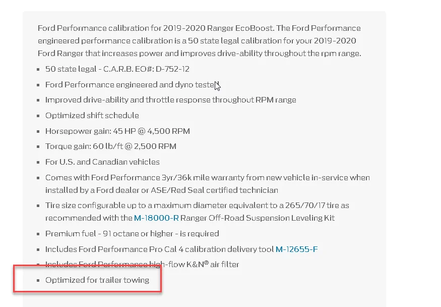

Maybe this means the release for the 2021 model is close.
This statement on the product description on the ford performance website is definitely new
I got the tune from FP for 2 reasons:
The torque improvements (for towing) & the Factory warranty.
So when I saw this, I went to my dealer for the update. At first the Tech couldn't see the update, but they disabled the Firewall in the shop and it popped up.
I've put 1000 miles on my truck since, and I am glad to report that it feels better than the first tune.
The engine revs up a little longer from first to third. The shifts are smooth and solid.
And now I have the piece of mind my tranny is safe. (Haven't towed with it yet with the new update....)
