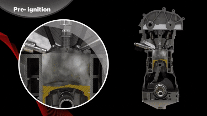

A tune requires higher octane because it advances the timing to achieve a better burn of the air/fuel mix.
Advanced timing can lead to pre-ignition with lower octane fuels.
Higher octane fuel burns more slowly and is more resistant to pre-ignition so timing can be advanced to create more power.
There is not more power in higher octane fuel, the higher octane allows you to tune your engine to get more power.
All that said, if a tune requires higher octane you need to run it because lower octane fuel can damage your engine.
Think of it this way:
The piston is coming up in the cylinder on its compression stroke. You want the fuel mix to be ignited before the piston is at the top so that it can get the maximum expansion to push the piston down for the power stroke.
Ignite the fuel/air mix too late, and the piston is already on its way back down and you will lose much of your potential power.
Ignite the mix too soon and you will try to push the piston back down before the crankshaft has come over the top of its revolution, like trying to push the crankshaft backwards. This is very bad and you hear it as knocking. It WILL damage bearings.
TLDR:
Lower octane fuel can burn too fast causing the mix to ignite too soon and cause knocking, which will damage your engine and your wallet.

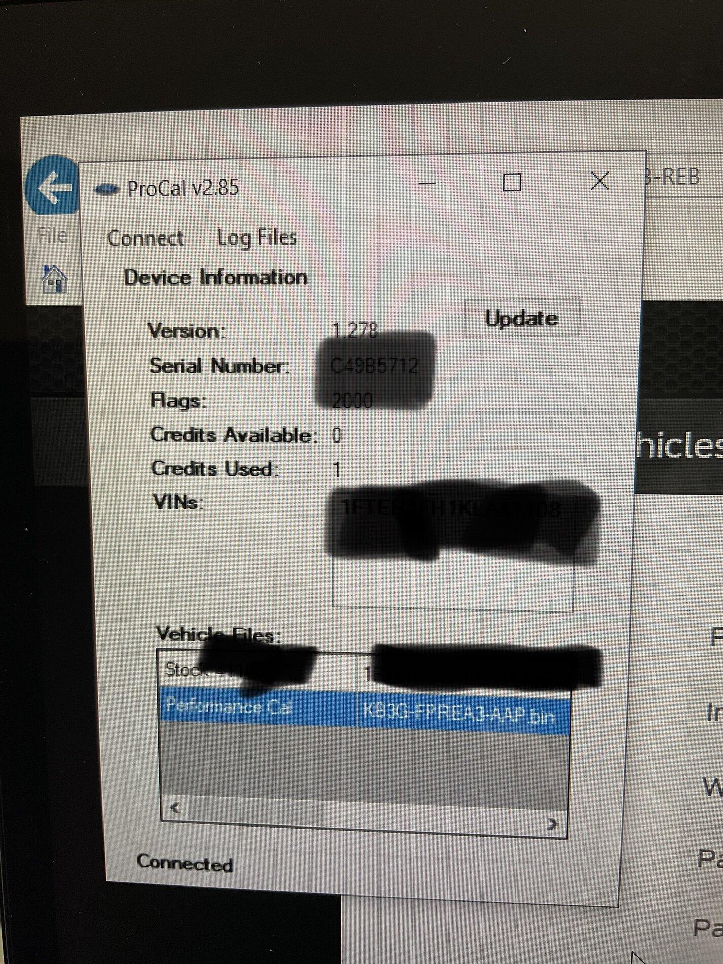

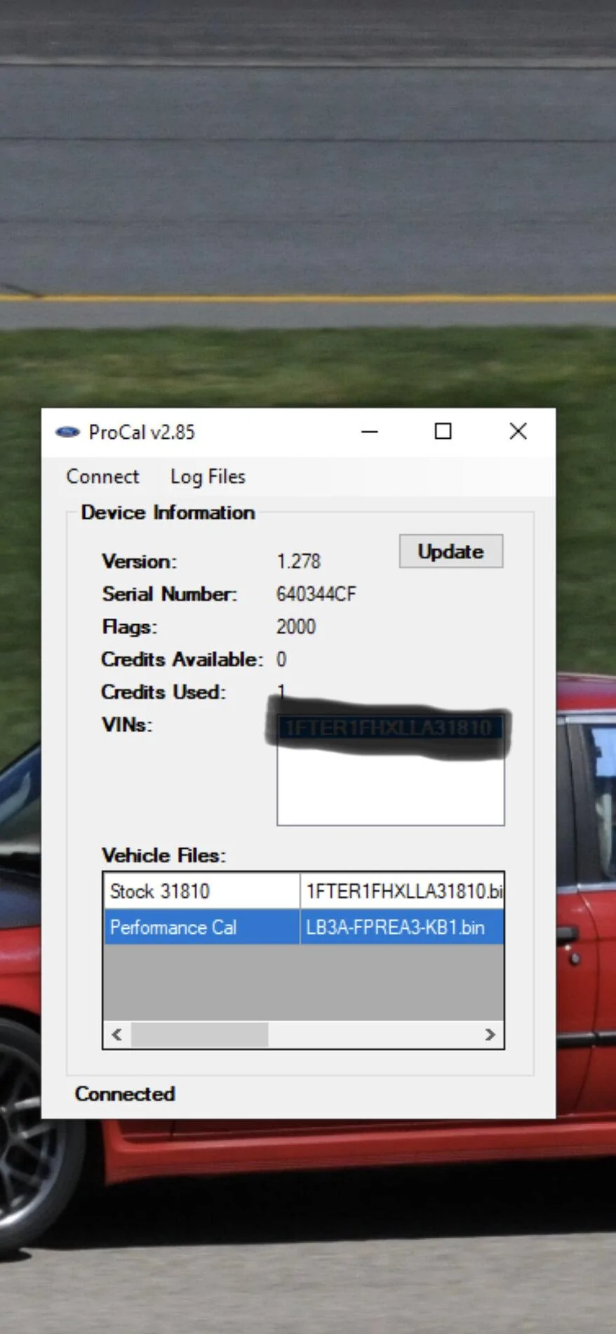

My .bin did change. It used to say A4P at the end and now says AAP. The tune was certainly updated for towing use. I received an email from Ford Performance about it. Perhaps try again or take better note of your original bin as the change could be as subtle as mine. P.S. to everyone that attempted to black out their serial # and/or vin I can still see them. It could be my monitor. Also, the VIN # isn't even blocked out on the .bin file.
I thought they were blacking out something else because I see VIN on both, do far.
I thought they were blacking out something else because I see VIN on both, so far. .šŸ¤”
