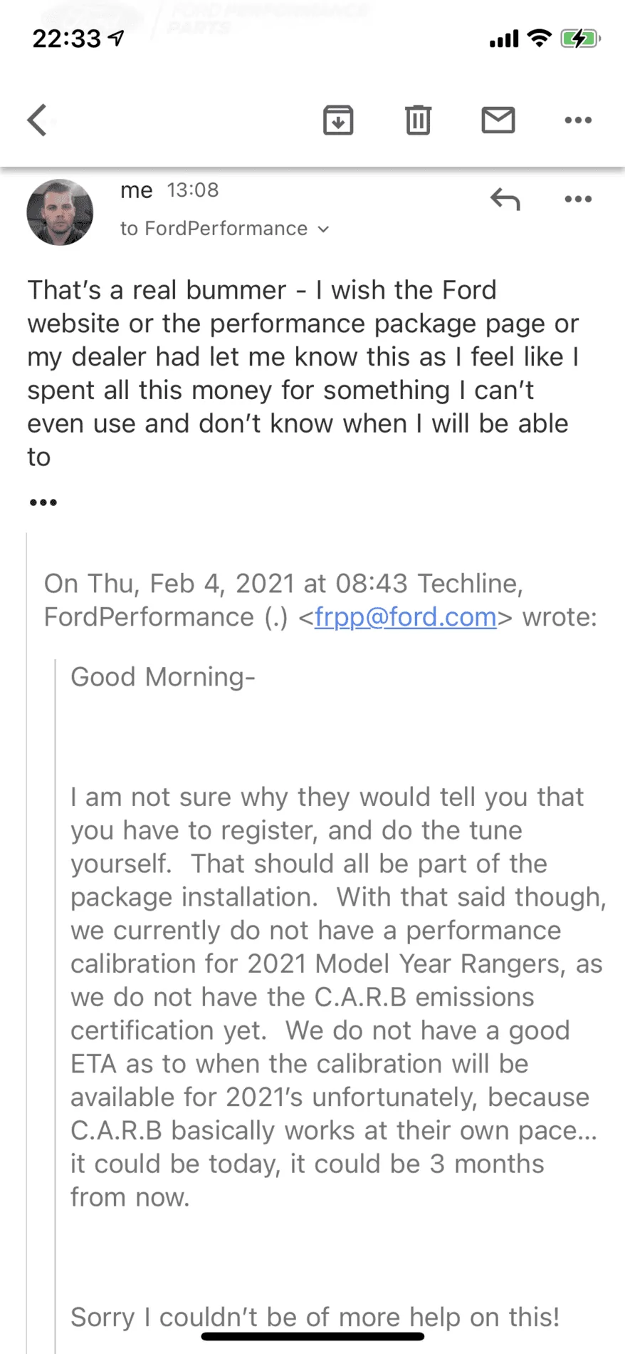

Too late, already registered to my vin. States that it is an “invalid strategy” when it tries to upload my current tune. I have contacted Ford performance to see what they are willing to do as their website mentions nothing about not working on 2021, my dealer knew nothing about this, and my dealer had to give my vin to them when they ordered everything.
If I hadn't called ford performance before buying I'd be in the same bad spot as you. ☹
