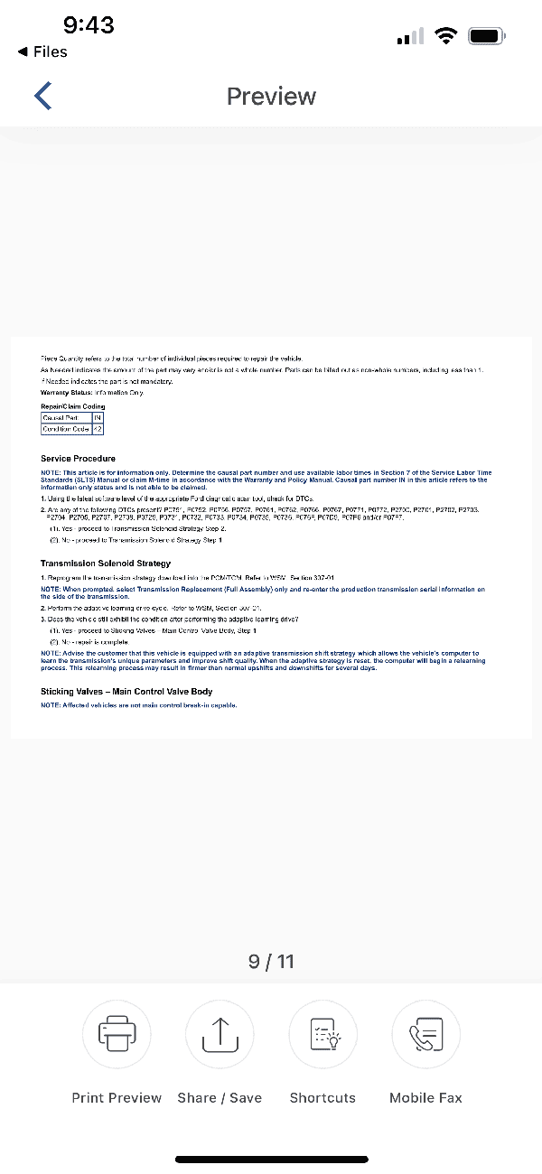

I read the TSB as codes or these conditions?
John, my truck experienced the shifting issues, but didn't have any codes with it. That is also the way that I had read it. They also quoted it as the first step of the TSB was completed on the invoice as well.
Same here - this is why I say that, the TSB says
One of the following vehicles:
- 2019-2023 Ranger
• Equipped with a 10R80 transmission
• At least one of the following conditions:
- DTC P0751, P0752, P0756, P0757, P0761, P0762, P0766, P0767, P0771, P0772, P2700, P2701, P2702, P2703, P2704, P2705, P2707, P2708, P0729, P0731, P0732, P0733, P0734, P0735, P0736, P076F, P07D9, P07F6 and/or P07F7
- Harsh engagement
- Delayed engagement
- Harsh shift
- Delayed shift
One of the following conditions.
Unless they test drove it and said nope nothing to see here...

And even the steps confirm that
