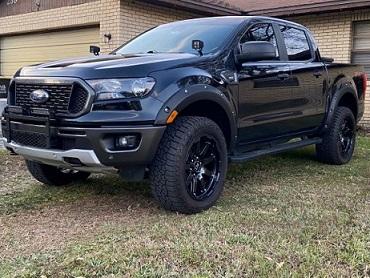

I installed the ready lift anti-intrusion beams. They are impressively beefy, and add some needed clearance. I currently have a 275/55/20 tire (2" level), and with the wheel locked both directions there is still plenty of room. My rim is 9.5" wide 12mm offset. I would think I could fit a 33"x11.5" tire, based on the additional room available.
Their advertising states "Retain the safety and security benefits of occupant protection." Ask them to send you some sort of certification documents that provide evidence that their anti-intrusion beams are stronger or even the same as stock.
Buyer Beware...
