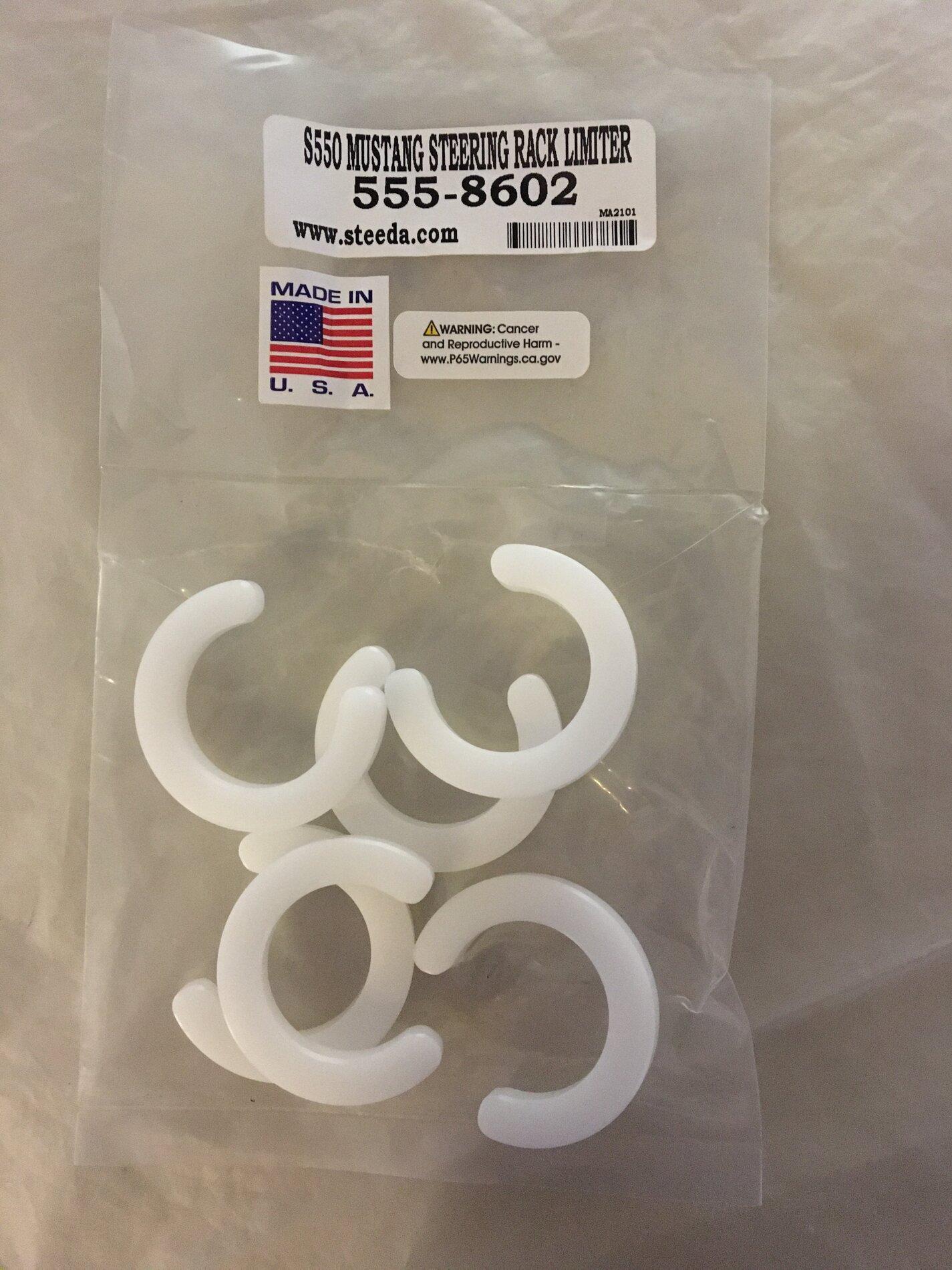

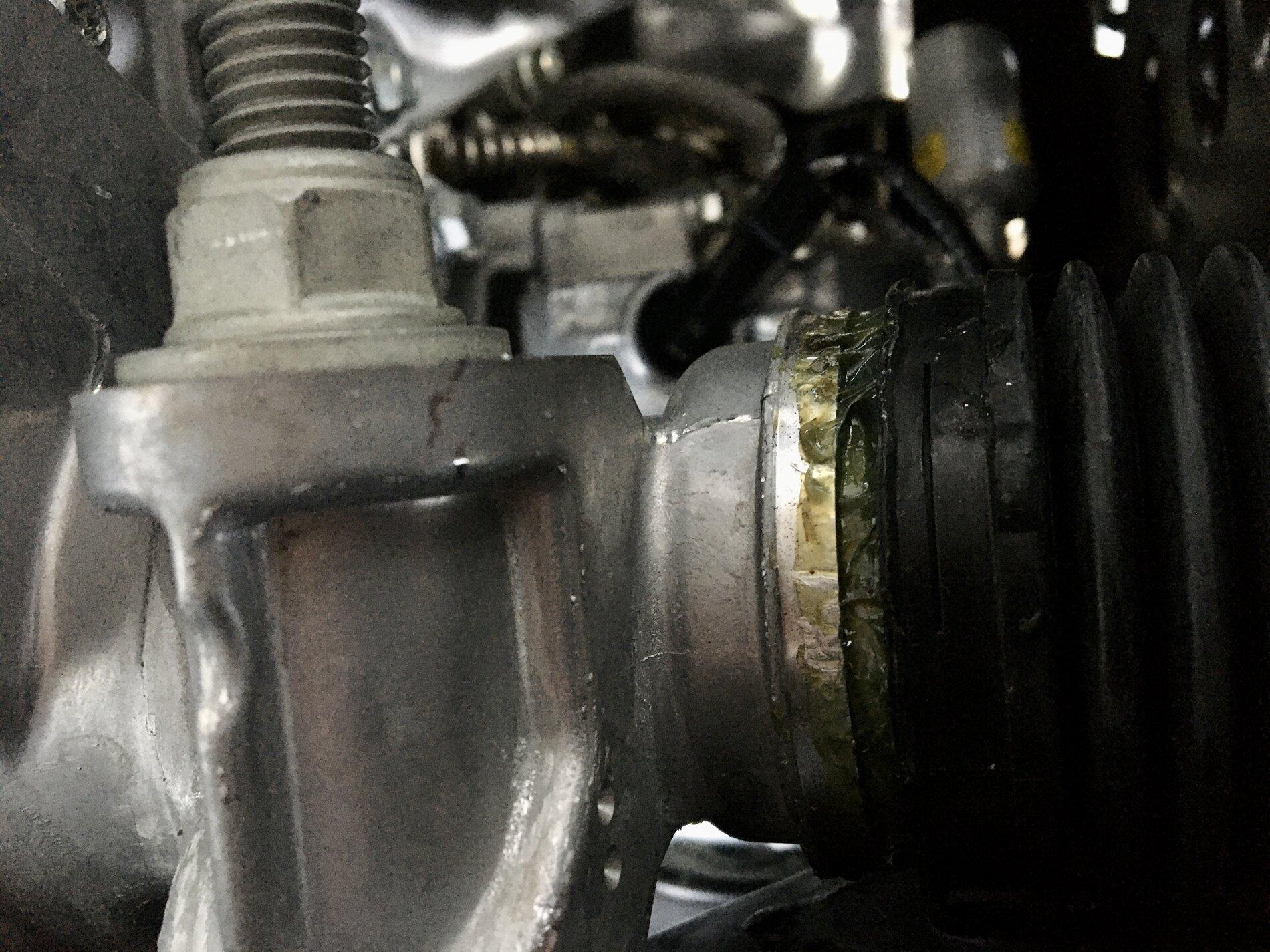

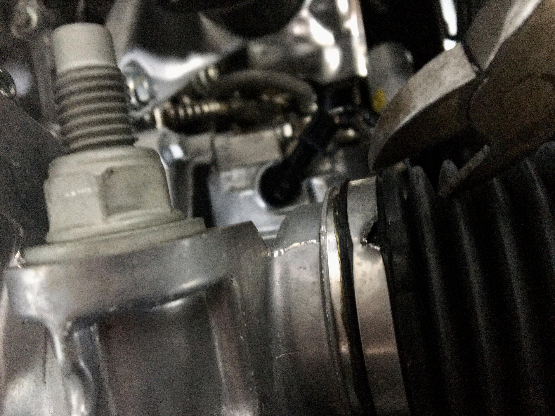

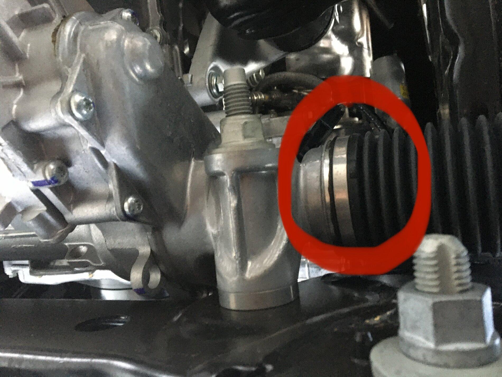

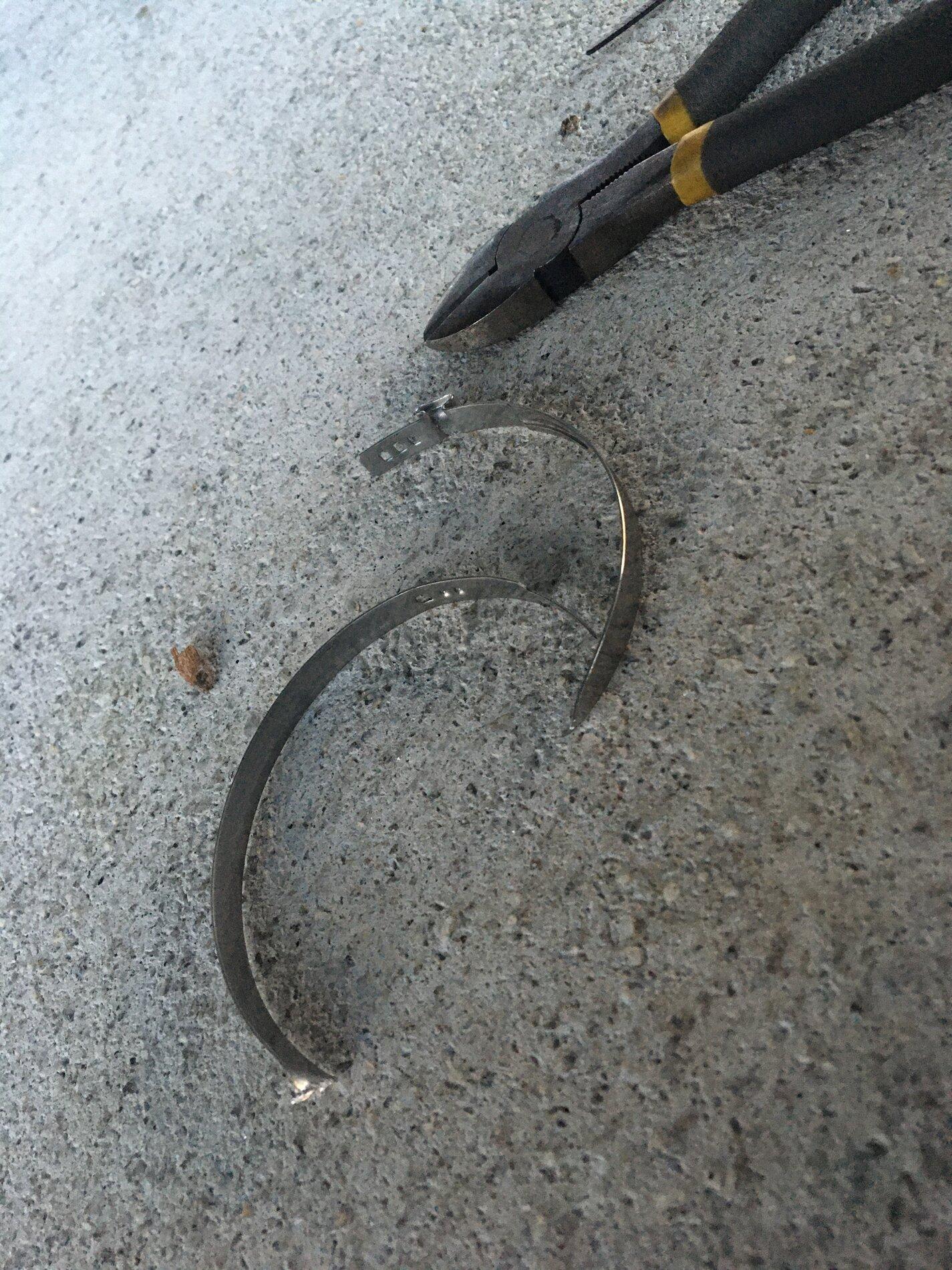

Hi fellow 5gers! I recently upgraded my factory +55 offset steel wheels to some 0 offset steel wagon wheels with 265/75/16 tires (32” tire). Love the stance and handling, but with no leveling kit (and I don’t plan on getting one) I was rubbing the factory crash bars before full steering lock was achieved. I looked into aftermarket crash bars for 5g rangers but wasn’t thrilled with non-OEM spec bars should I ever be in an accident or the labor involved to remove the factory crash bars.
When researching an alternative, I discovered what are known as steering rack limiters. Various vehicles (Mustangs / BRZs / Etc) have kits for this to not rub fender liners when running wide front tires. I found that new Mustangs run a similar electronic steering rack like our Rangers do, and that Steeda made a kit for 15-21 Mustangs that want to run wider S550 front wheels.

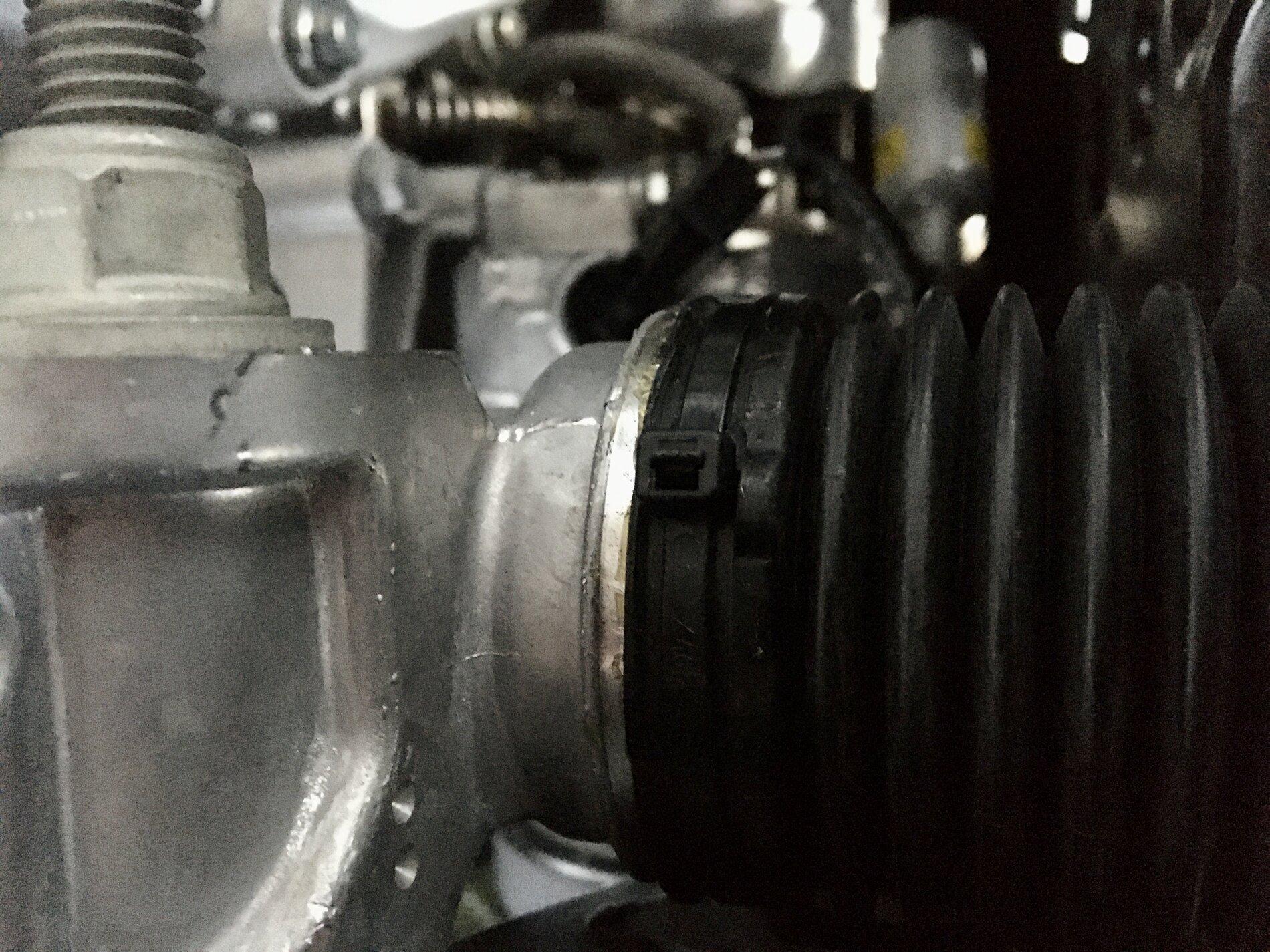

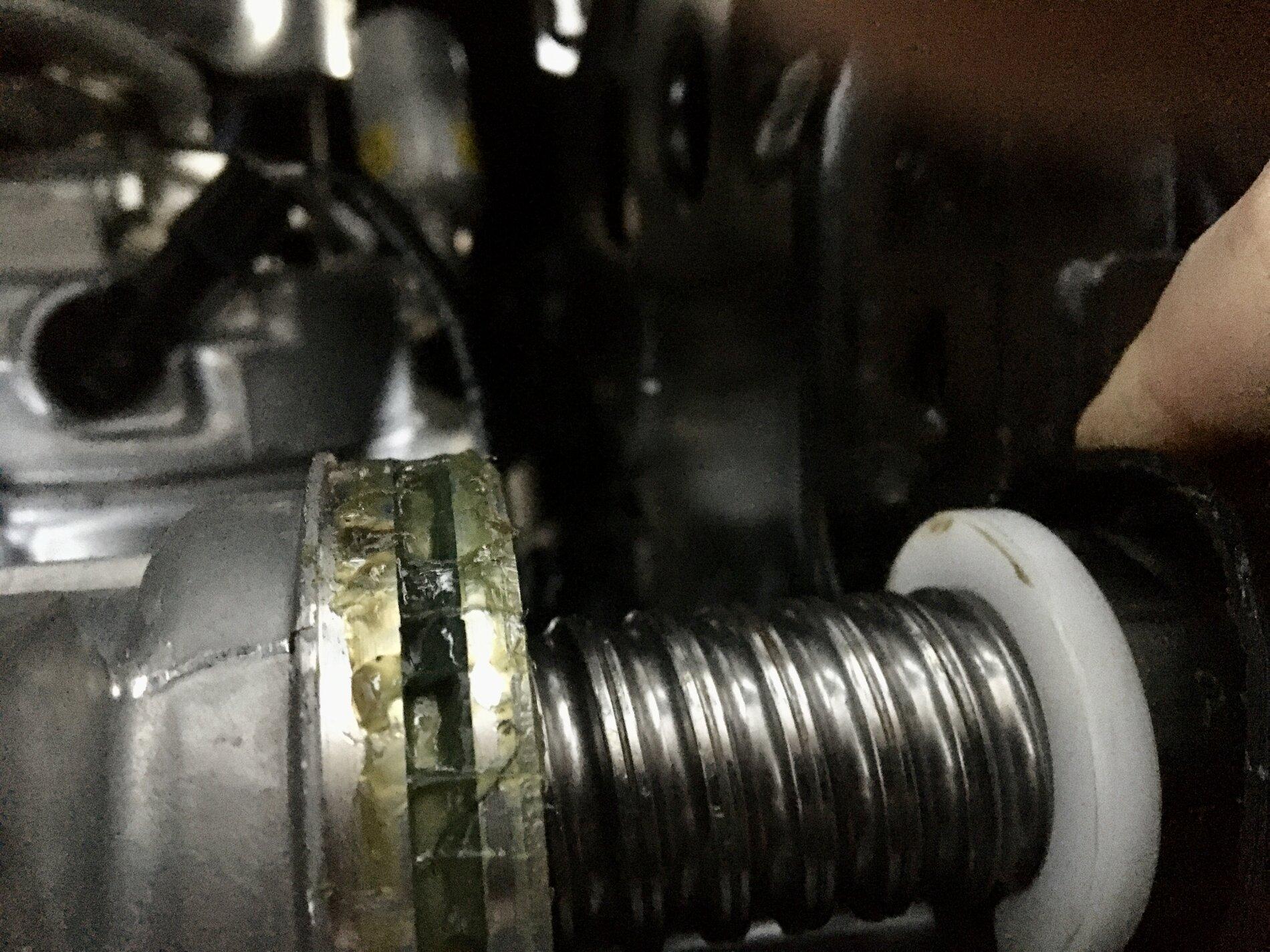

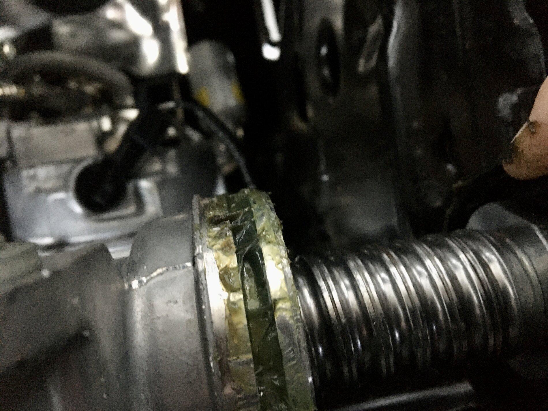

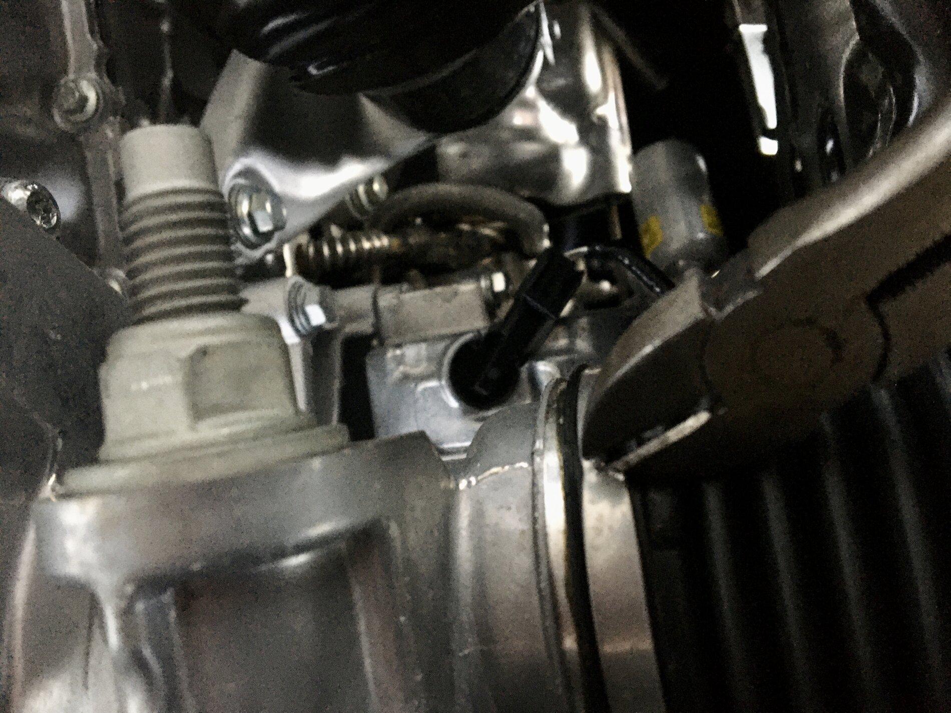

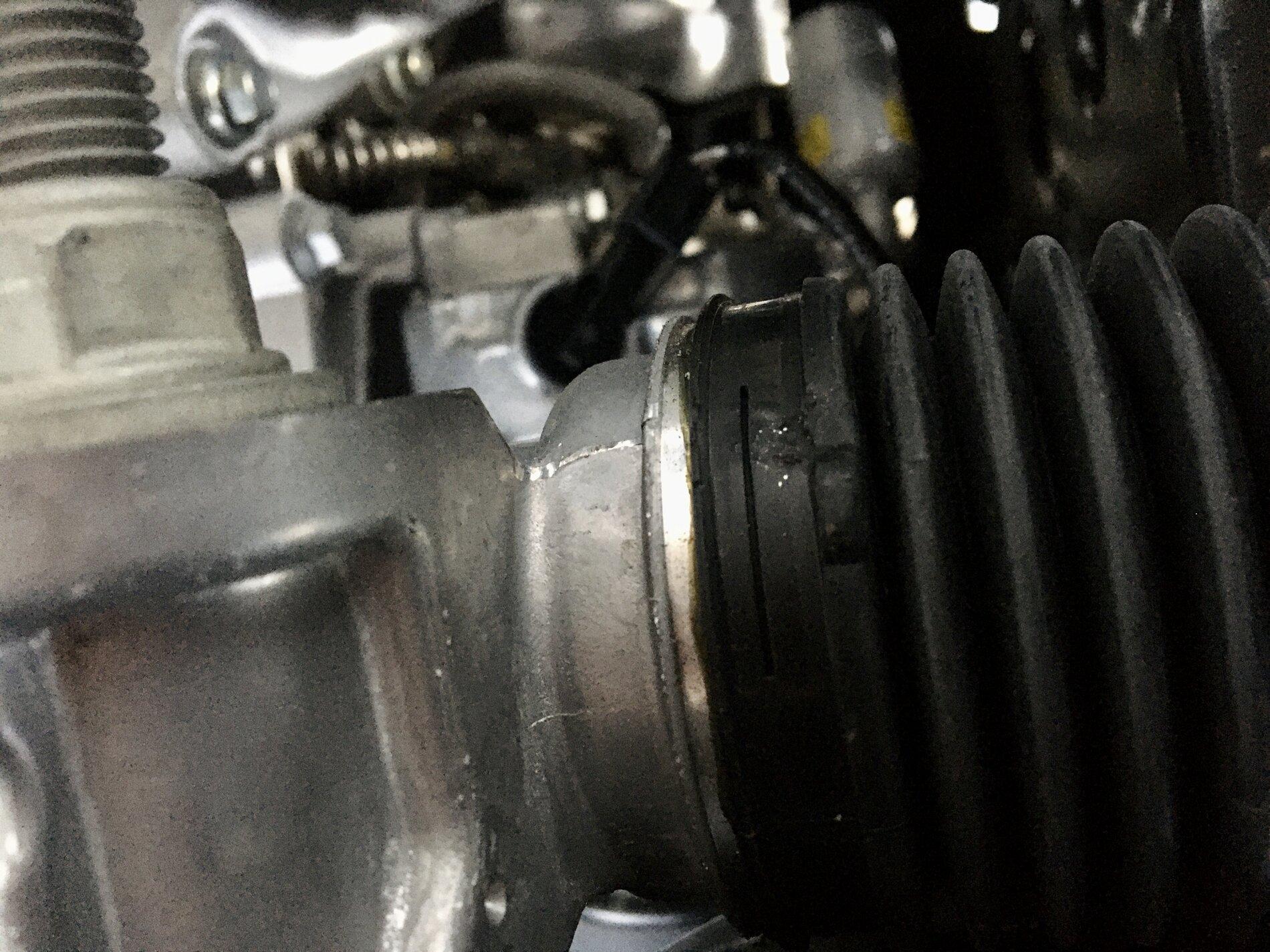

So I took the plunge to see if this product would work on our trucks and I’m happy to report that they do! Install is super easy and no alignment needed afterwards. The loss in steering radius at full steering rack lock is not that noticeable and no more rubbing on factory crash bars, plus I get to keep factory crash bars in place (which I wanted) vs aftermarket. Below are install pics with everything you need to know. The kit came with 8 spacers total and I used 6 (3 per side).
Hope this helps others as an alternative to new crash bars if so desired. Thanks for reading!
