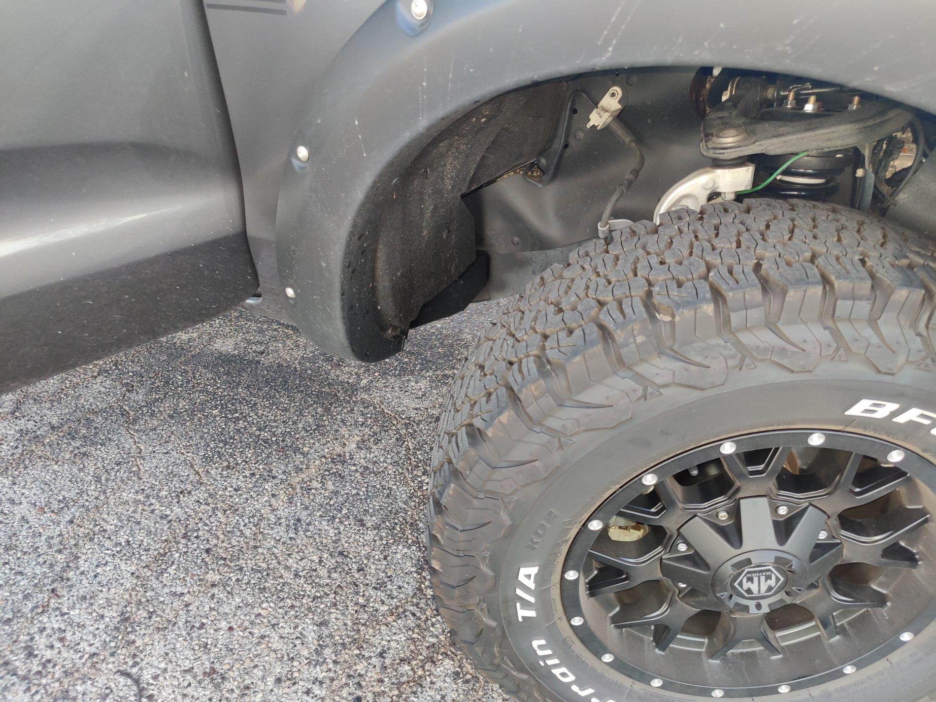

Just got them done a week ago, no rubbing with 2.5" RC level on 2WD. BFG KO2 265/70 17ļæ¼ļæ¼ļæ¼ļæ¼
