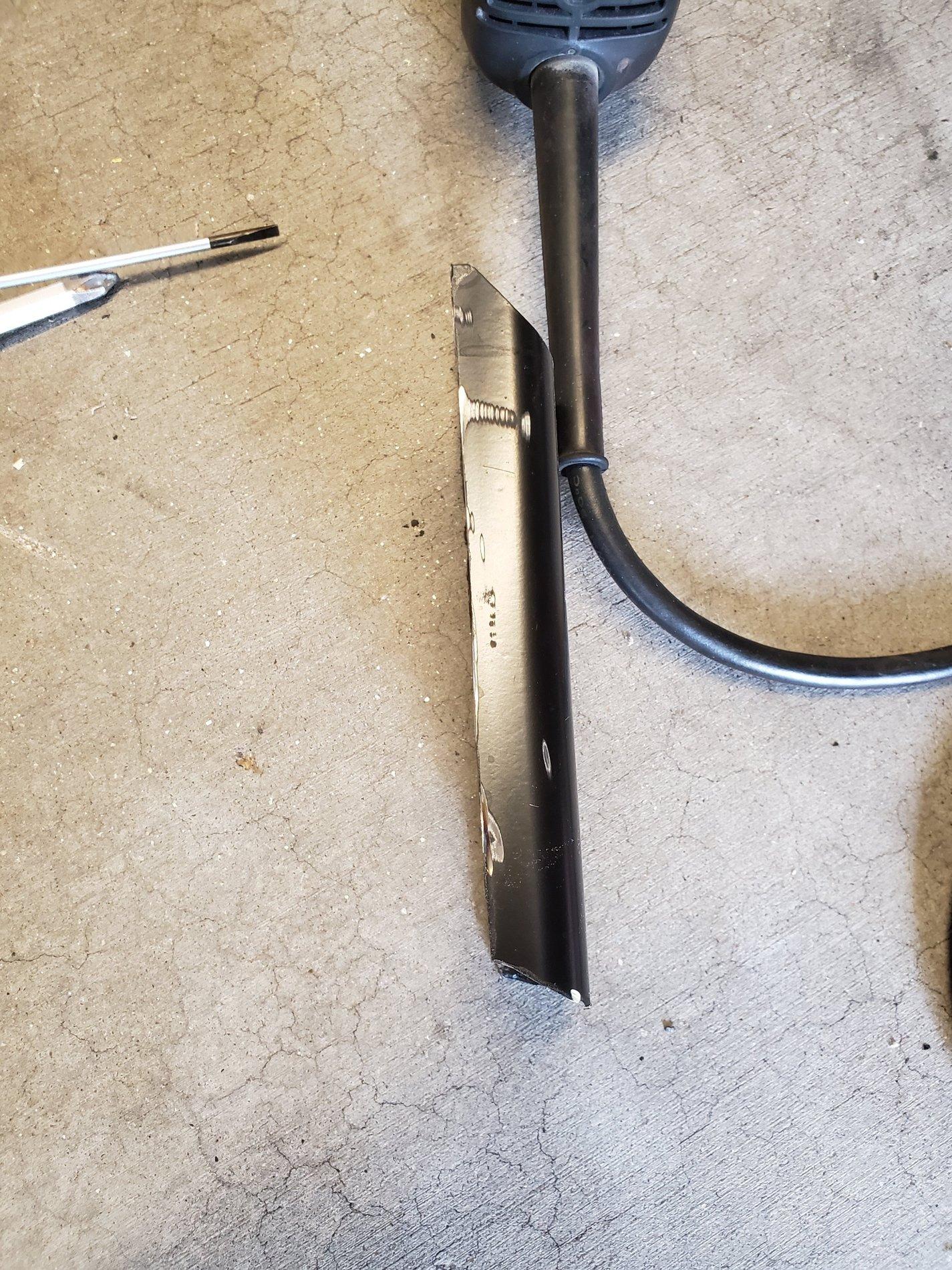

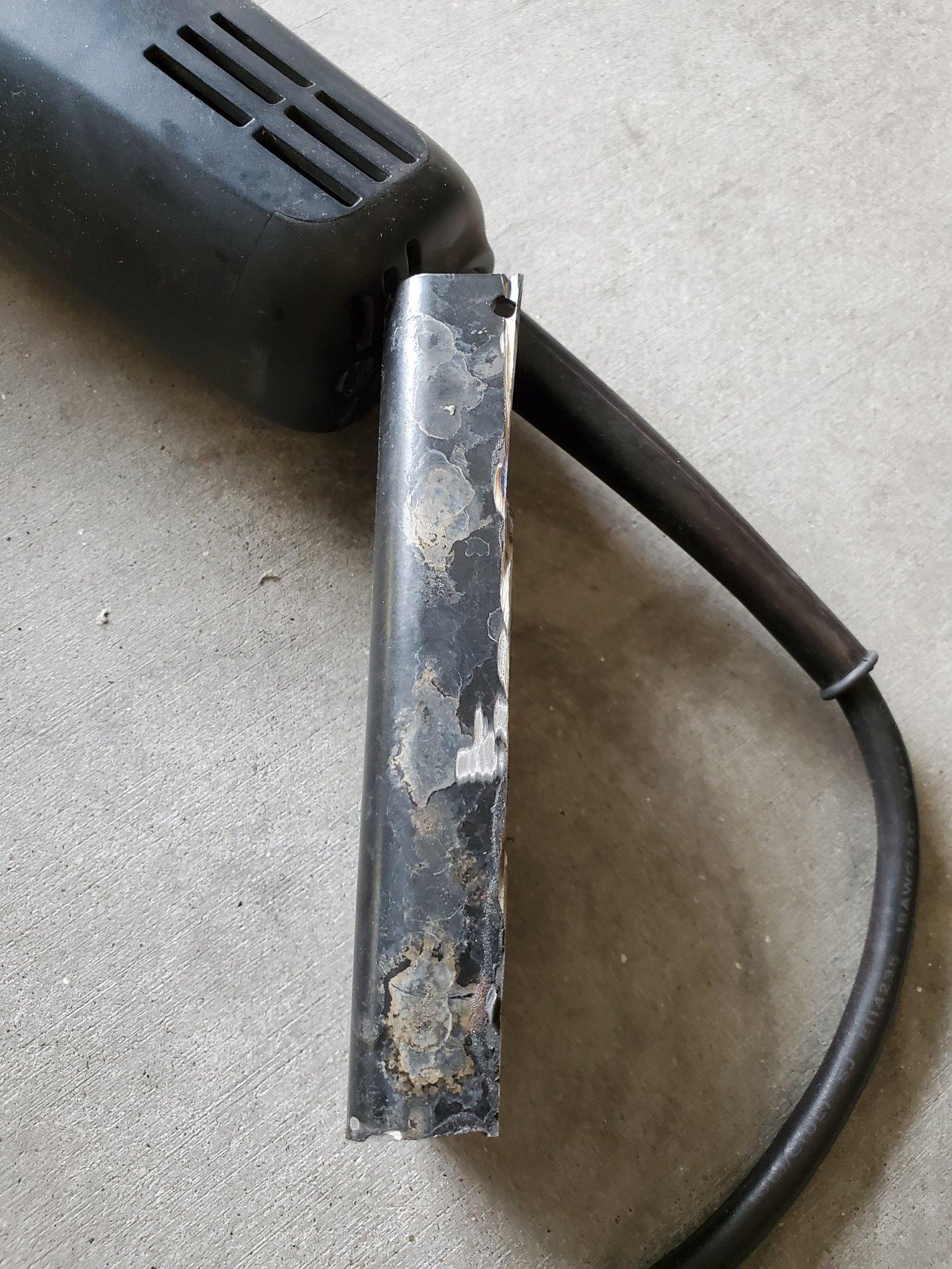

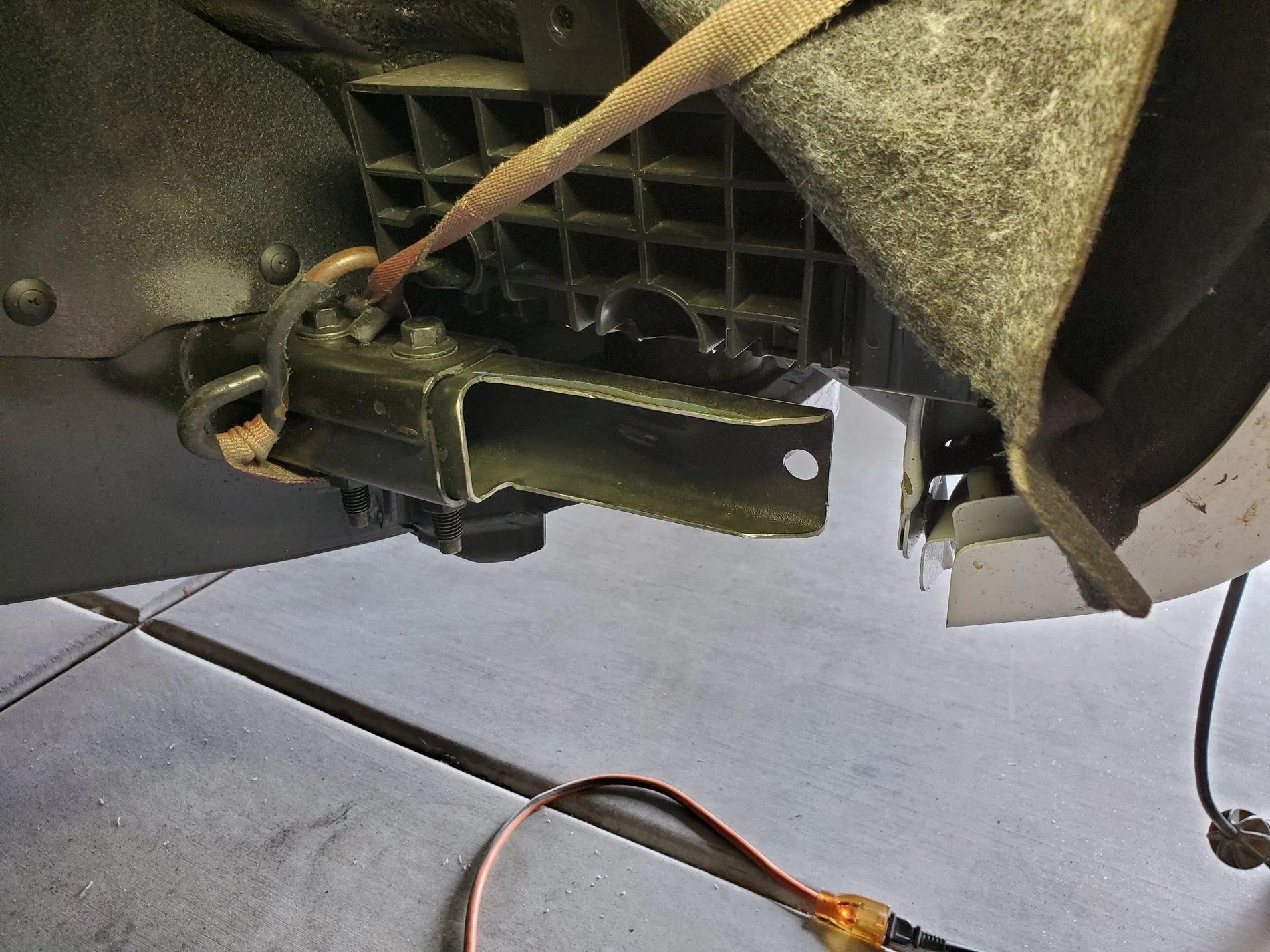

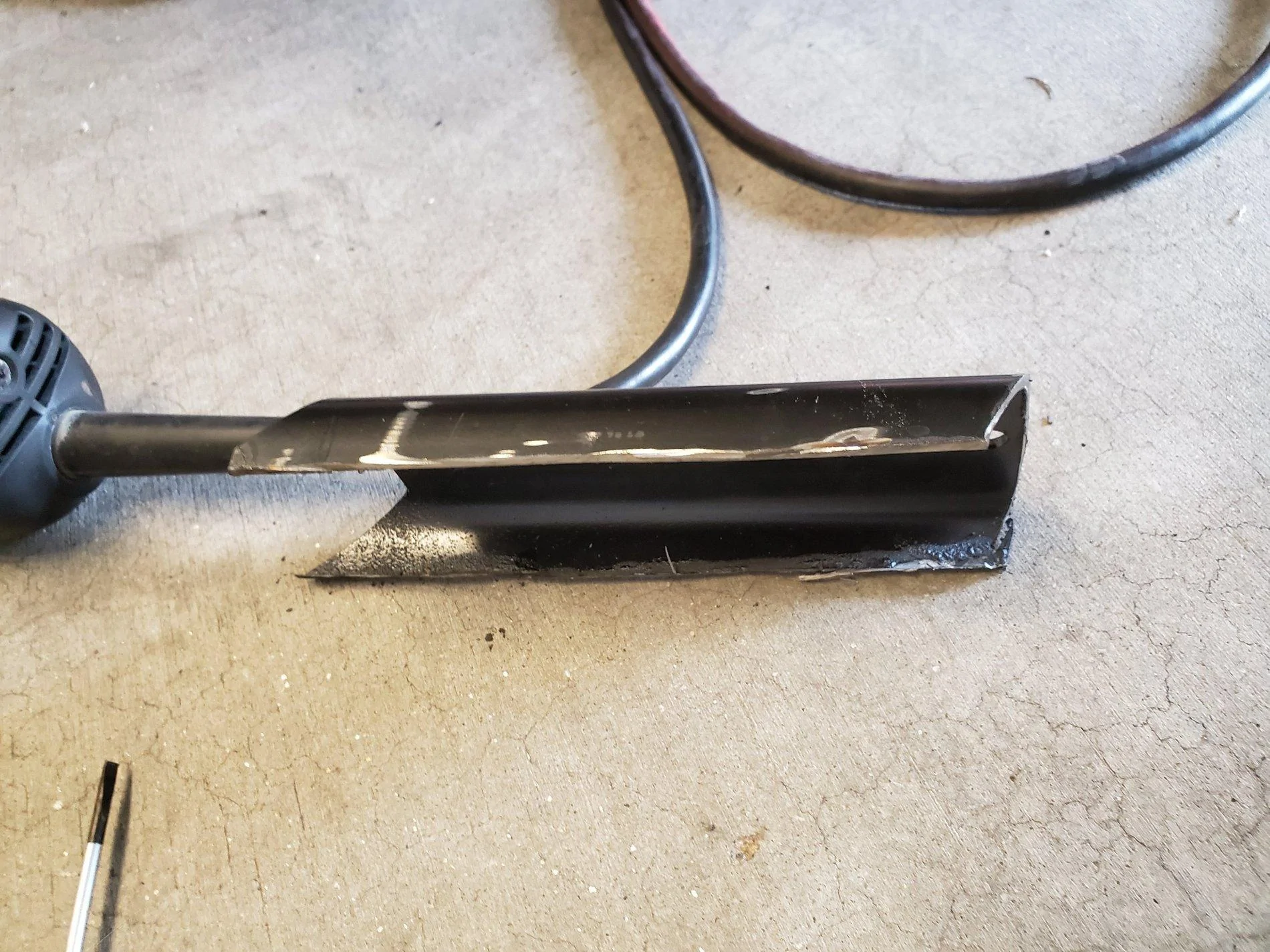

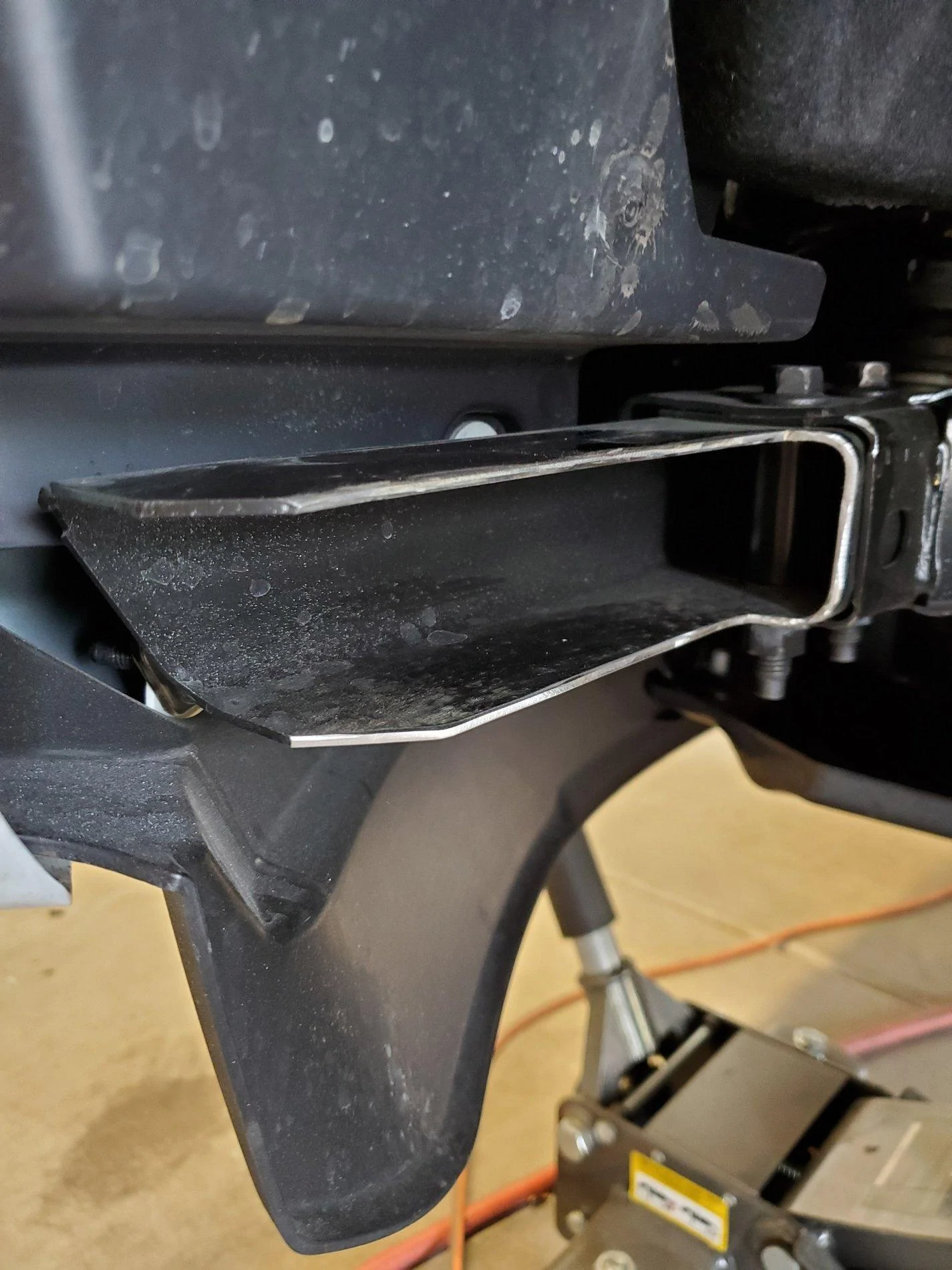

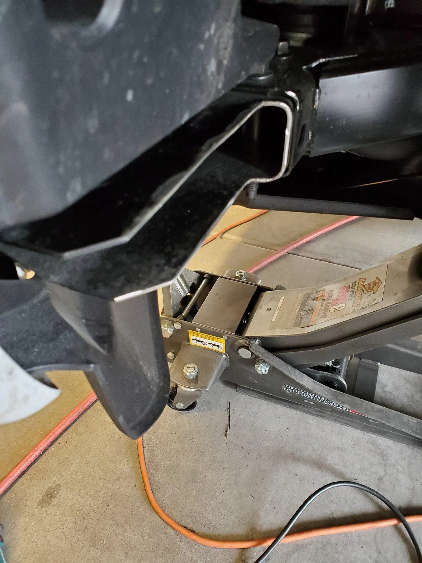

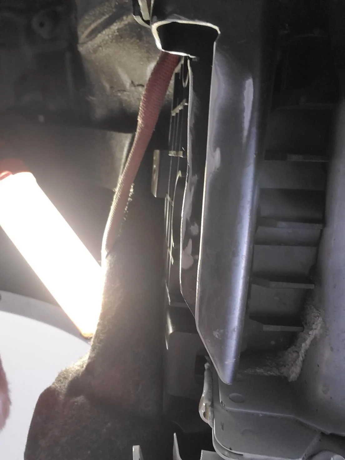

I have ordered the Icon stage 2 kit along with Icon Rebound wheels and 275-70-17 Falken Wildpeaks for my Ranger. Reading through the forum I don't think the crash bars need to be trimmed for this size tire but I went ahead and trimmed them anyway. Not wanting to take the truck apart to remove them, I opted to trim them in place. I used a hand grinder and 4 or 4 1/2" thin wheel, spending 2 - 3 hours for all 4 crash bars. Just wanted to let people know what can be done without disassembling the truck.

Did the same thing., and re-painted them. Easy fix...
Nice job on crash bars but I think I would weld a plate to the open end to strengthen it.

Thx. I may reinforce them once I see what I have for clearance with the wheels and tires mounted. I don't know what real purpose these bars serve but I'm sure I'm a bit less safe with them trimmed.
Cool,good luck with your build. The crash bars protect your legs in an offset frontal crash.

It looks like the crash bars (especially the front ones) are just simple tubular steel with a plastic cover. Could someone who has cut/modified/removed them measure their dimensions (length, width, height, and wall thickness)?
For those that have trimmed/removed them, did you modify both front and back or just front? From my measurements, I have ~1" horizontal clearance in front and ~1.5" in back at full turn (FX4).
I'm curious for retaining most of their benefits (crash strength) while gaining clearance if those bars could be replaced with a narrower rectangular tube plus a spacer tube/block to ensure fit where it goes into the socket/bolts. Tubular steel is pretty cheap and going with a thicker wall could offset strength losses.
