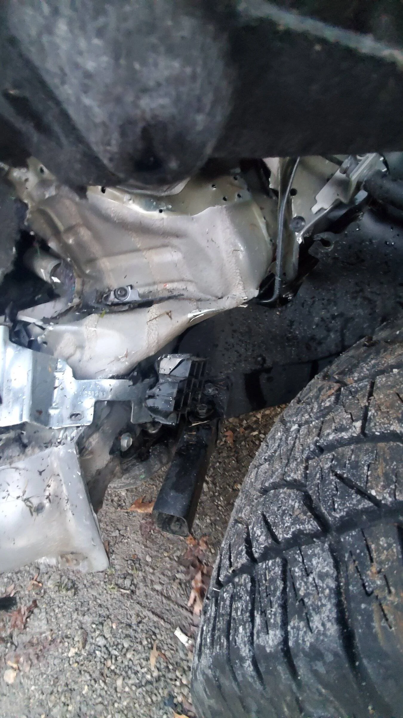

In my accident the crash bars weren't involved.
But relying on the aluminum firewall to prevent injuries is probably wishful thinking.
I tried to salvage the Husky floor mat from the passenger side and couldn't remove it due to the firewall being crushed down on top of it.

Details? Why did the bar not help anything?

The impact was higher than the bar.
I realize that it's there to control the tire, but just wanted to point out that the firewall isn't much protection, unlike older vehicles.
So older vehicles are much safer and more structurally sound huh..
