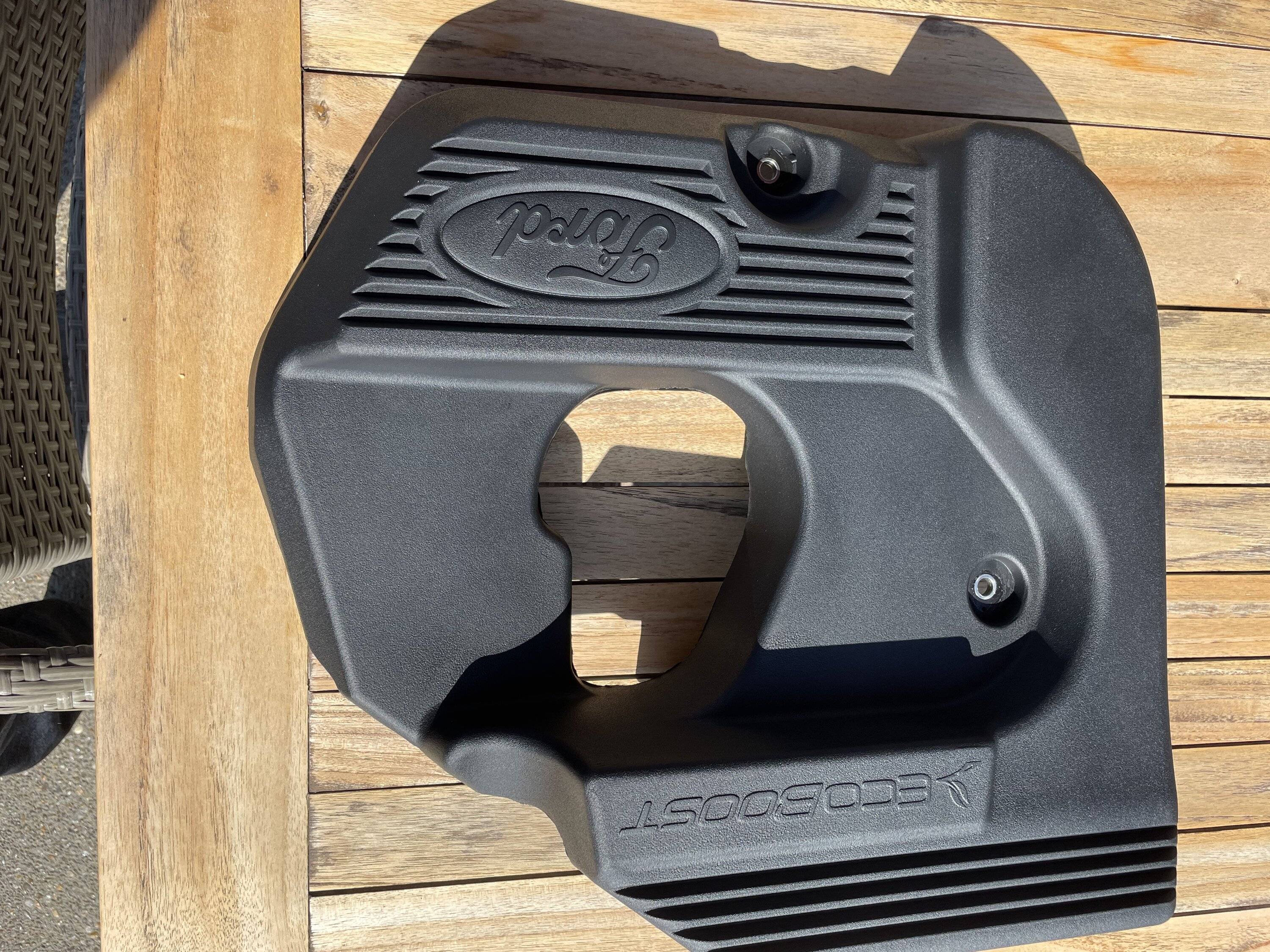

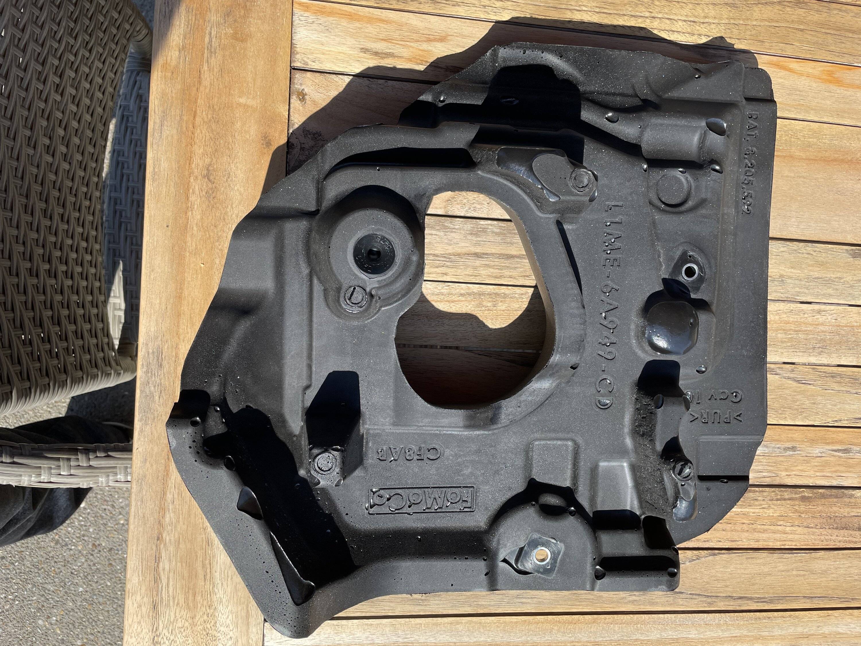

I’ve been following all the discussion about the deleted engine cover and potential issues with rusted in spark plugs. Living in the Northwest…it’s damp and wet 9 months out of the year. If anyone is going to have a problem it’s me! I have a 2022 Lariat Tremor…no engine cover. So I scoured the web and found a cover that appeared to be the ford part number. Showed up this morning. It is not molded plastic, it’s foam! Does anyone foresee an issue with a foam based engine cover?? I’m a little leery of it and how it hold up. Someday I imagine it will crumble. But I’m hoping it will protect me from these issues for a few years. Anyone smarter than myself have any thoughts? Trying to decide if I return it or install it.

they are all foam. itll be fine. install it and forget about it. i replied even though its not likely im smarter than you:handsinair:

It’s legit. That’s the way they are. It’s also meant to deaden the sound from the high-pressure fuel pump.

Appreciate the help! Glad to know I wasn’t bamboozled.

It is supposed to be foam. Note the >PUR< in the lower right of the underside photo. Indicates Polyurathane foam. Cheap product that withstands wide ranging temperatures well. There is also polyisocyanurate (PIR) foam that is used in the cryogenic industry that is good from -300ºF to +300ºF.
Ultraviolet rays are the chief decomposer of PUR, moreso than high temperature; not a problem under the hood.
