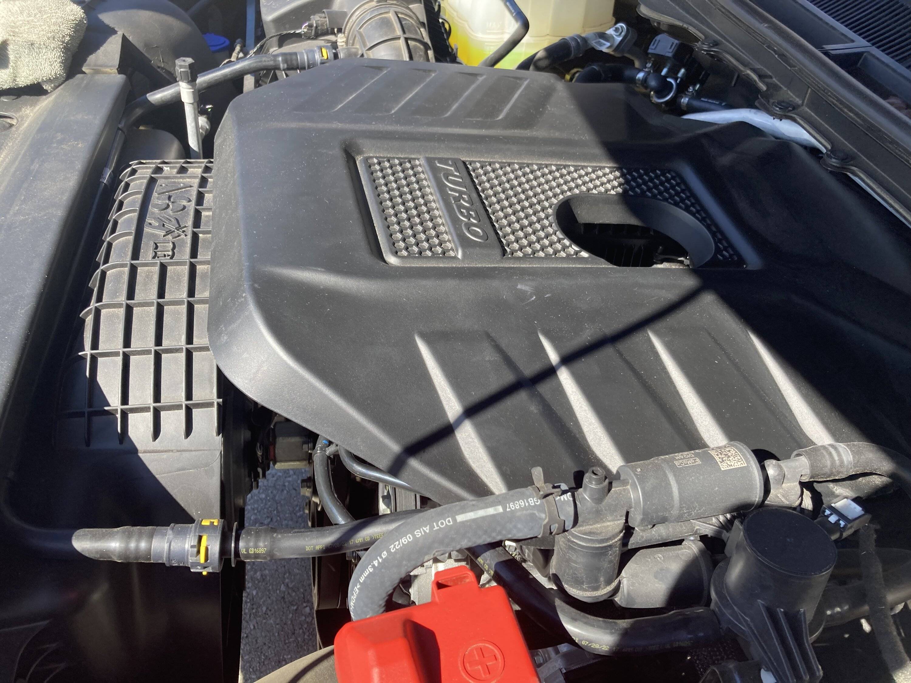

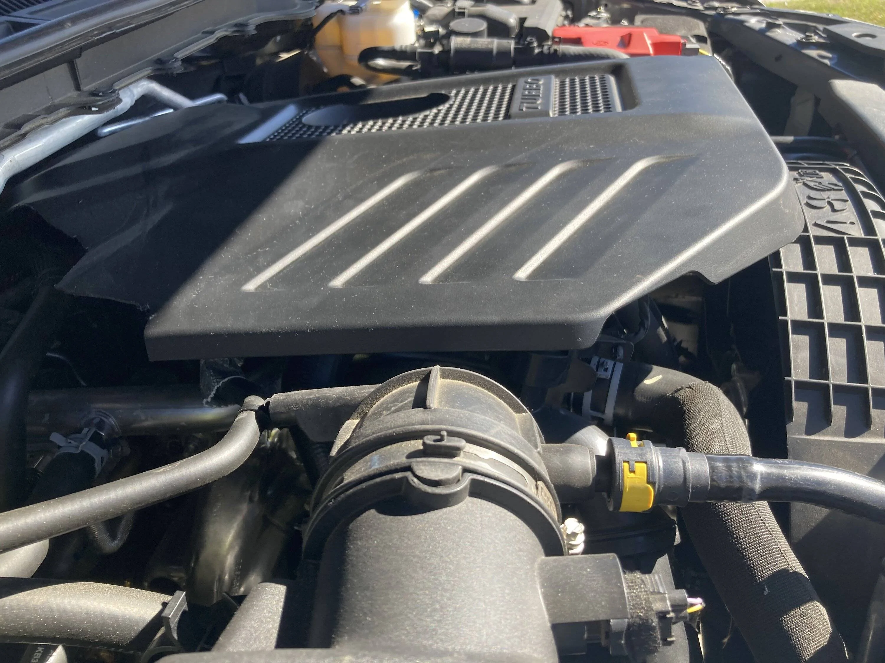

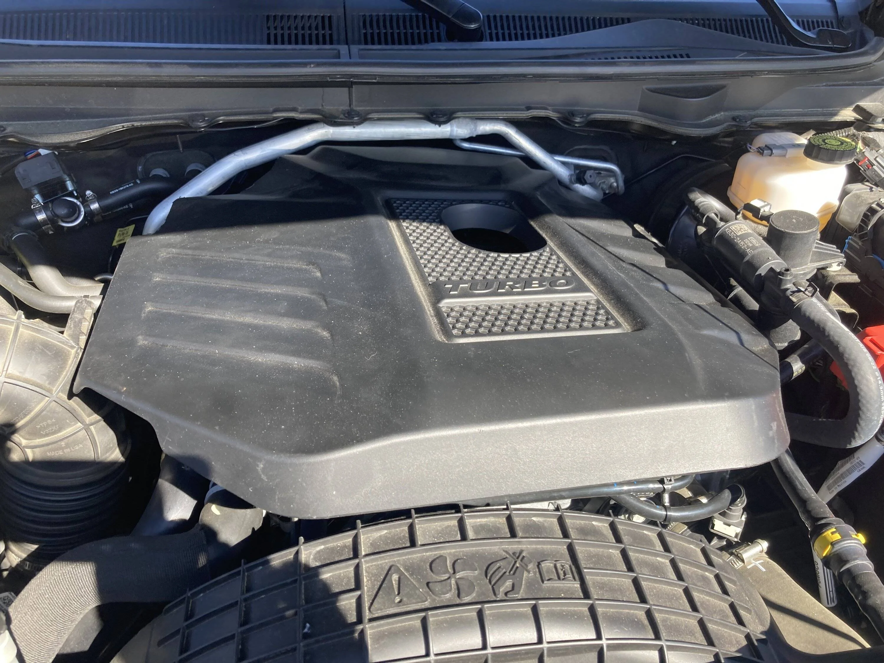

I took a couple shots of my cover and motor. It looks like it’s covering everything?

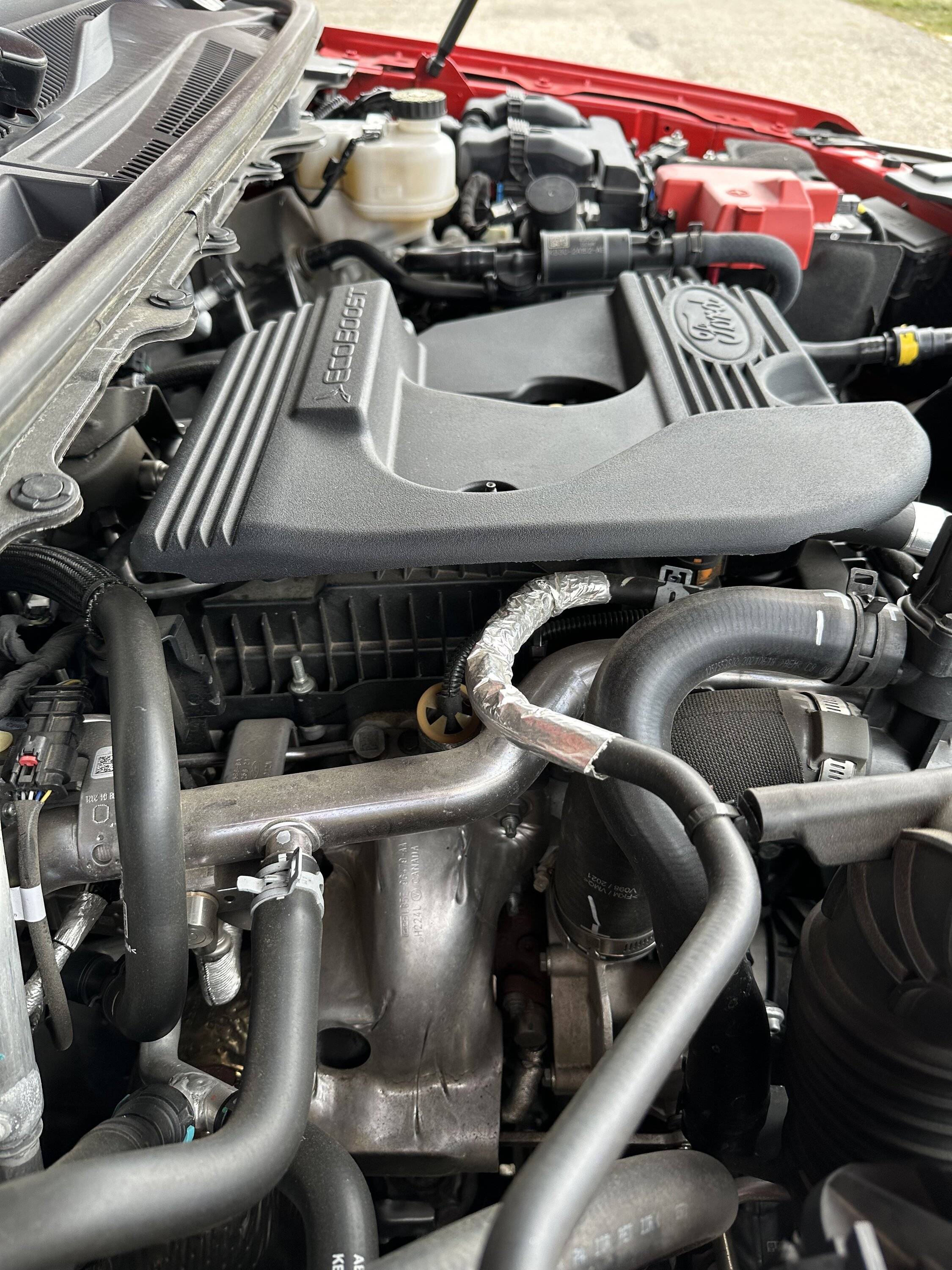

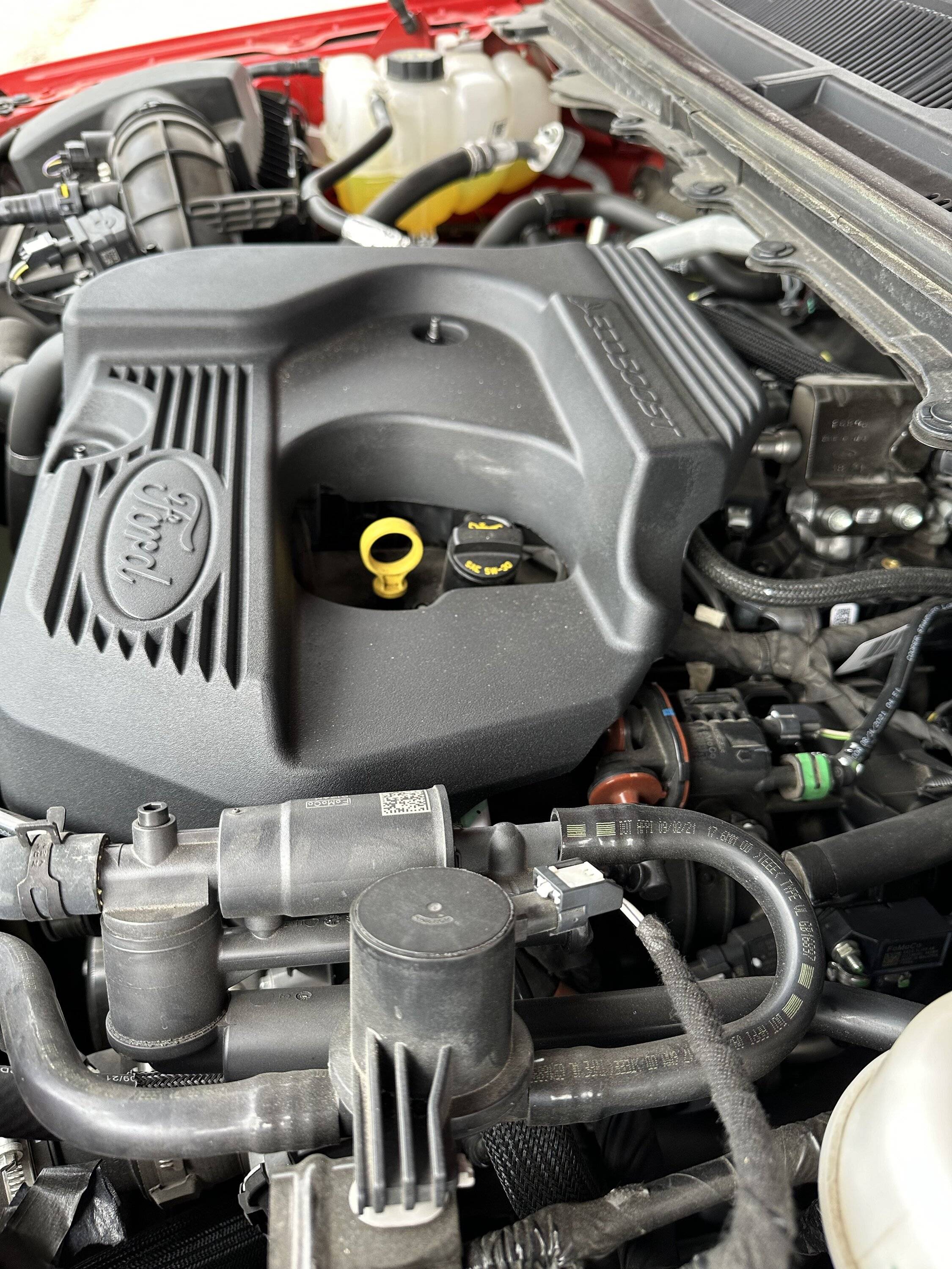

This is the Amazon Bronco engine cover. It doesn't fit perfectly, but it covers adequately, and I was motivated since it was cheaper and I didn't want to bother returning it. It came with four brackets, but the one at the driver's side firewall wouldn't fit because of the difference in A/C routing. We trimmed the lip on the passenger side and put a 1/2" spacer under the bracket at the front of the engine so the cover would clear the turbo blow-off valve.

Dang, that looks like much better coverage than the real one! I bet this one actually does suppress a little sound. Sure seems much wider and comes much farther forward.
Good job! =)

The part I like is that it extends up under the two piece cowl so that water runs off behind the motor.

That looks nice. But do you have to remove it to check or add engine oil?

I was diagnosed with ALS last spring, so I can't even get up there to look. My brother helped me install it earlier this year when i was getting around better. I'll have to get him or wifey to have a look. Either way, it snaps onto the brackets with rubber grommets, so no tools needed for removal.
