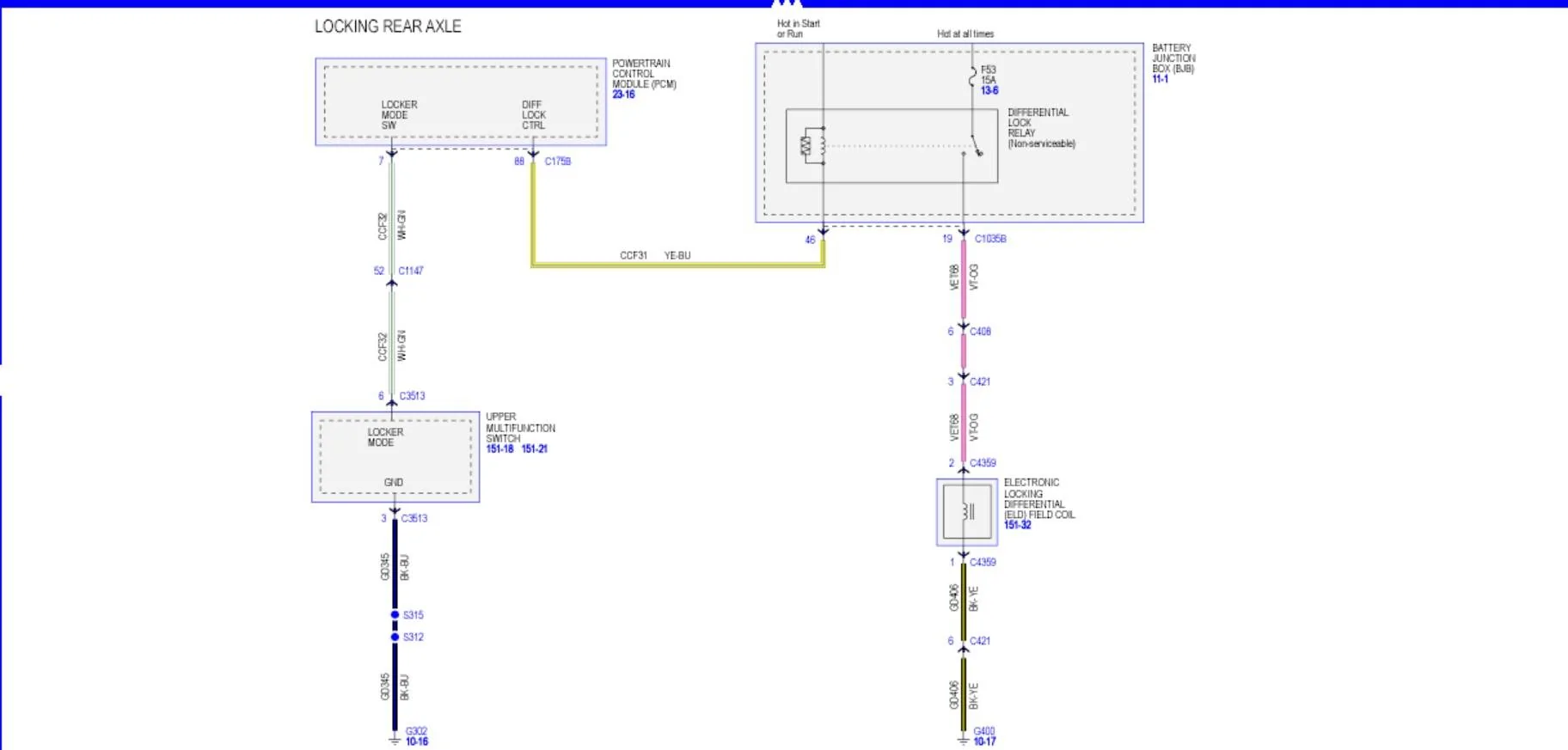

Well I am having the axle installed this week. I got in forscan and switched the locker on in the IPC module. I doesn't appear to be there in the BCM though. Maybe it is listed somewhere else? Is a lot going on in there.
RangerBill
Bob
Jun 8, 2022
1,861
2,610
PA
It looks like a relay in the battery junction box supplies power to the locking rear axle.
