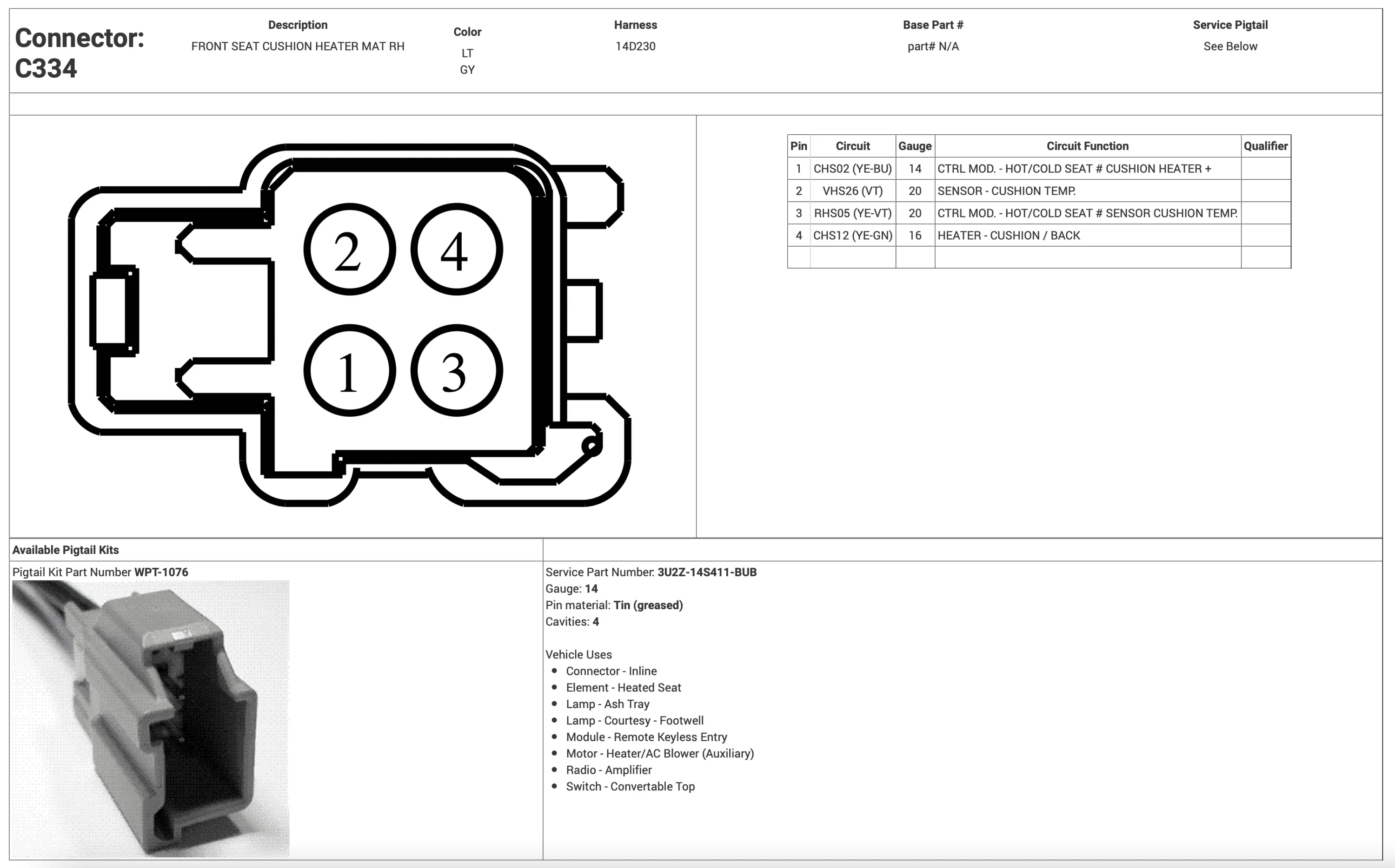

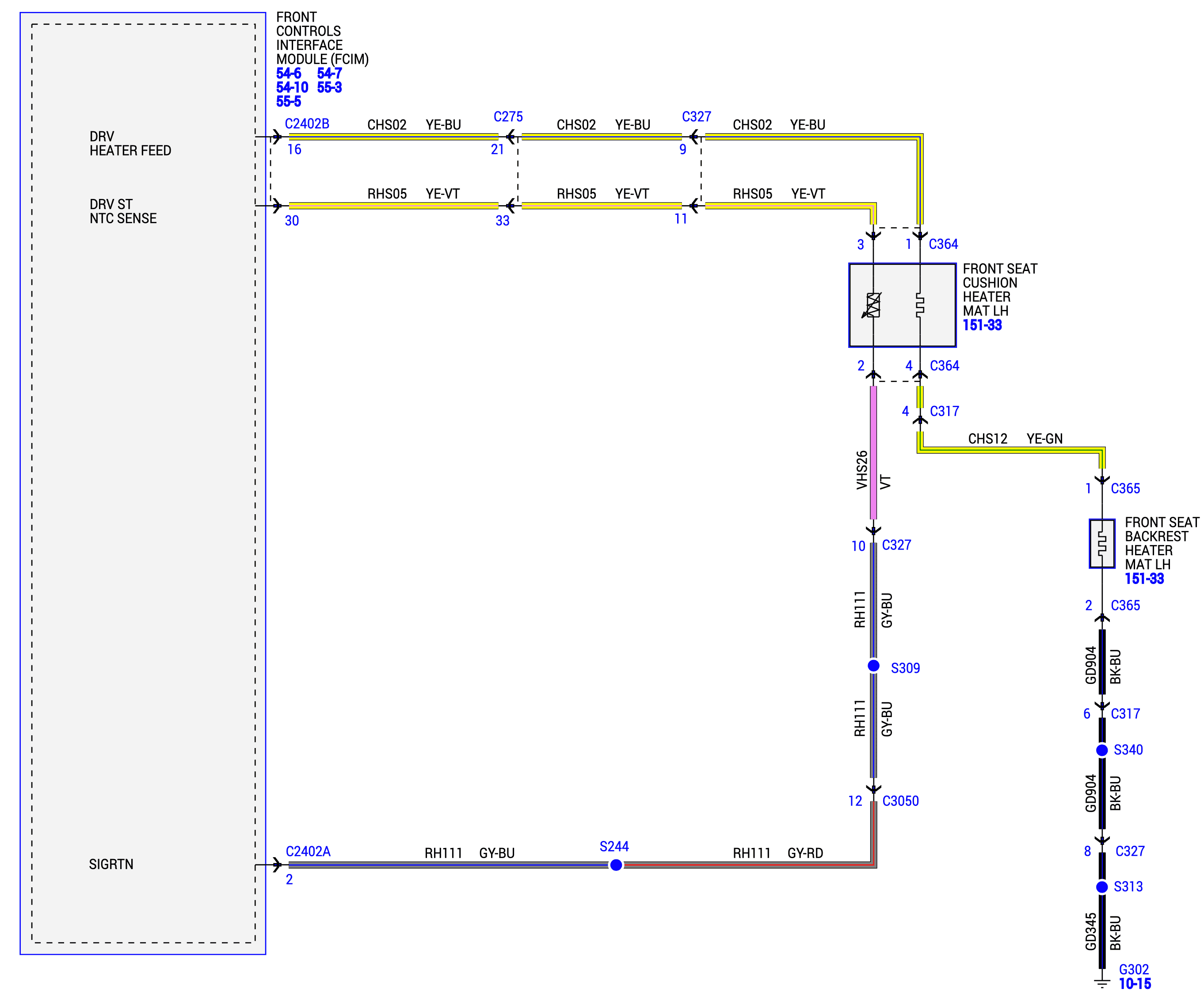

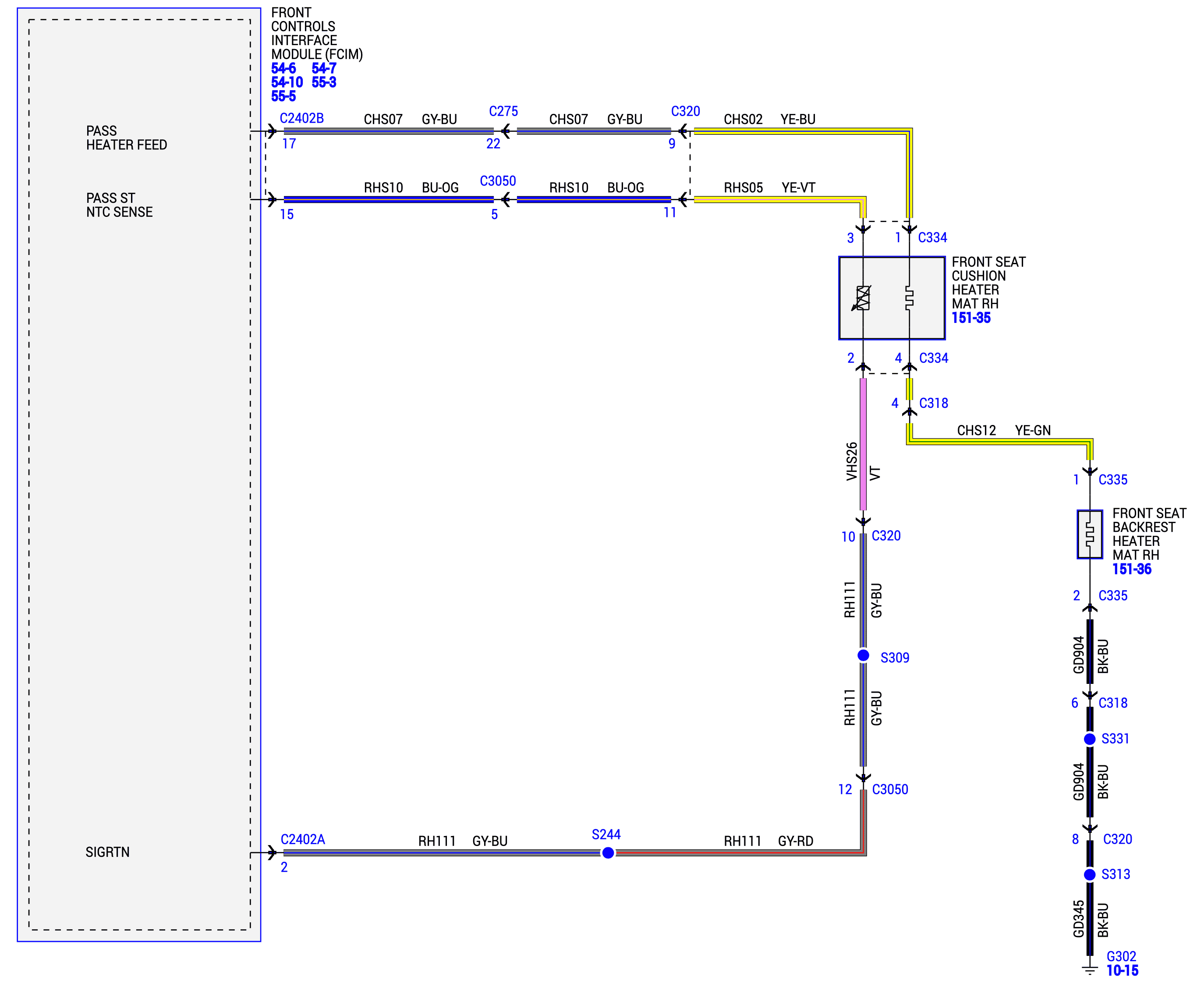

Any chance of getting the pin out for the driver seat harness that connects to the seat heater? Ideally also looking to trace where those wires connect to. I'm considering buying the heading mats and attempting the install but need to see if I even have a prayer of running the wires.
Pretty sure this is what you are looking for.
