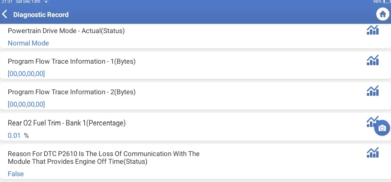

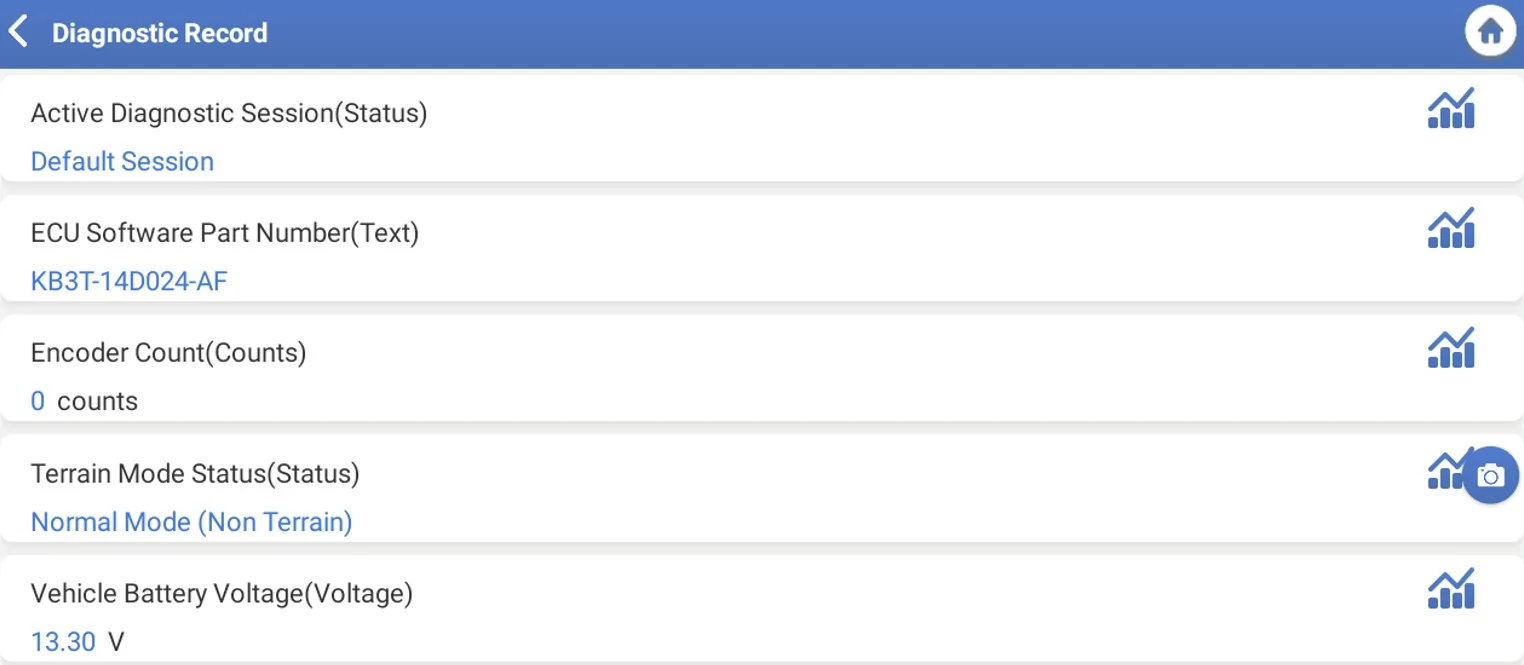

I did a quick review of my PID data (available) references
I found 2
In the ATCM and PCM, I will hook up and post (confirmed) that the data transmission is being received and accepted to these modules - When the dial is rotated (correction - button pressed)
These are from my TopDon Scanner, I also have Snap-On and Autel ref screenshots for all PIDs
ATCM
PCM
I do not remember actually looking at these PIDs when out of normal, but if these also change and match the same as the IPC (PID) then its working - I will do a quick plug in and see
I do not see a - Drive Mode (PID) within the ABS live data so the PCM will be the main factor as its holding the transmission data for the 10R80.
As i said you bring a valid point (question) but I suspect that these PIDs will change as well or there would be a - Fault Generated of (Mismatch) data - we shall confirm shortly and I will post my findings - I can also dig (when time) and follow the data transmission path to what modules look at the - Drive Mode (Who needs to know and who ignores it) when that data is sent

I can confirm that
1. The ATCM - changes from non terrain to terrain, when selecting modes out of normal.
2. The PCM - changes to the mode selected
3. The transfer case automatically switches to 4- High when any mode out of normal is selected, I forgot it did this.
I will post my confirmation screenshots in AM when I can connect the scanner and download them.
For me it’s confirmation it’s a fully functional system and not just a display showing you false information.

Anyway here is the screenshots showing Terrain Management - changes
ATCM - Changes to - Terrain Mode anytime when out of normal mode, this PID also drives the transfer case to shift automaticially to 4-High
PCM - Changes to match the selected mode in the IPC menu
