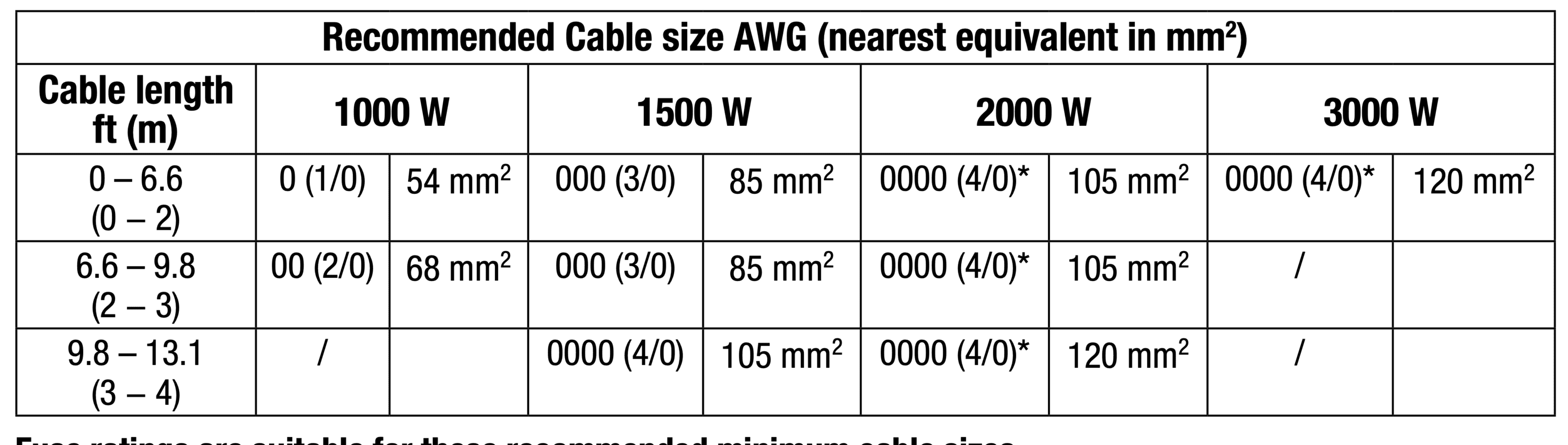

0 Gauge for an 1000 WATT Inverter sound like a lot.... Might want to look at 4 or 6 Gauge instead. As for a good place, I know there are various rubber plugs in the cab. I would look at those first.
it's what redarc recommends for there 1000W inverter.
