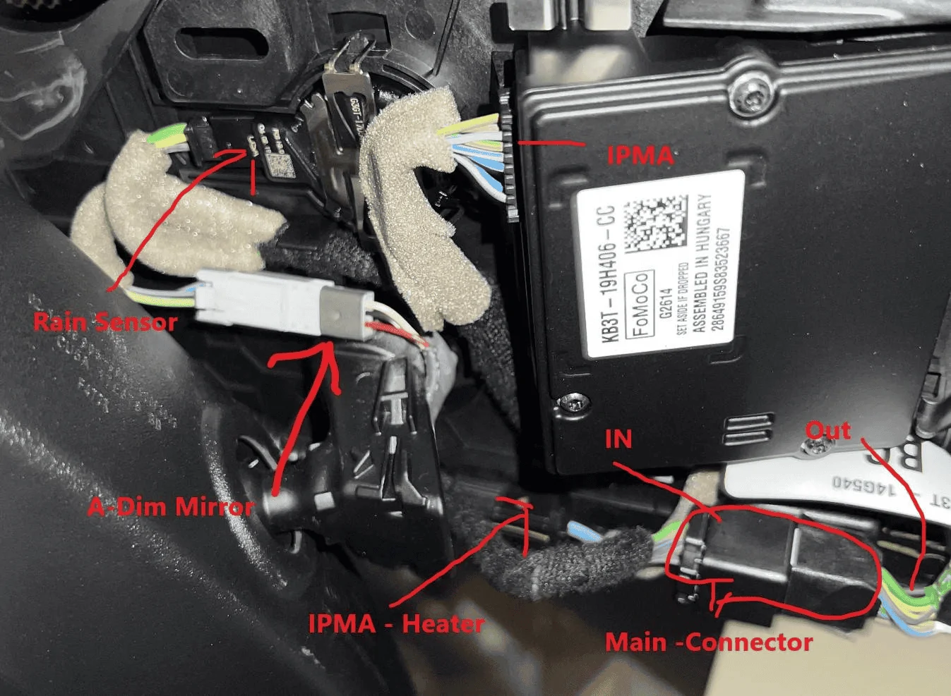

Ok since this has been asked numerous times - I dove into it but someone will need to verify some info, and this varies as if you have Rain Sens or Not.
Using a Fellow Member - with a ROW Ranger who was able to replace a short harness assembly at the mirror - he was able to add ACC to his Ranger.
So this tells me that - the Main (Input) harness SHOULD be wired at the mirror.
Then this short harness provides the power to the varied options (Trim Specific)
Now the UNKNOWN is if these harnesses are wired for ACC (IDK)
Ref: This Pic and all available connectors that come off of the Main-Connector
Main Connector = C919
If I am correct (14-Wires) Input (If ALL Rangers) are wired the same to this point.
Output - Is where the change happens, and the wires change and eliminates options you do not have. - Such as Auto-Dim Mirror / Rain Sense - ACC
All wiring for everything in that area comes from the C919 Connector with one exception
and that is the IPMA Camera Heater that comes direct from the IPMA (Internal) this a 2 -Wire connector
C919 - Input Connector 14-Pins (Main Connector)
Look at this connector and note how many wires are on it (Input Side)
for the purpose of this thread and the want/need to add a camera trigger I will only point out the locations of - Auto-Dim Mirror pinouts as if you had the Auto-Dim mirror (option)
Auto-Dim Mirror - Power = Pin # 2 - Blue/Brown
Auto-Dim Mirror - Ground =Pin # 13 - Black/Grey
Auto-Dim Mirror - Reverse Signal Input - Pin # 3 Green/Brown
Now look at the other side of the connector - you will note those cavities are empty, these would feed the 3-wire Auto-Dim mirror connector
This is what the Dongar adaptor connects to and taps for power, I don't know if that is using the Reverse Sense input or not - I think it is only using the Power & Ground

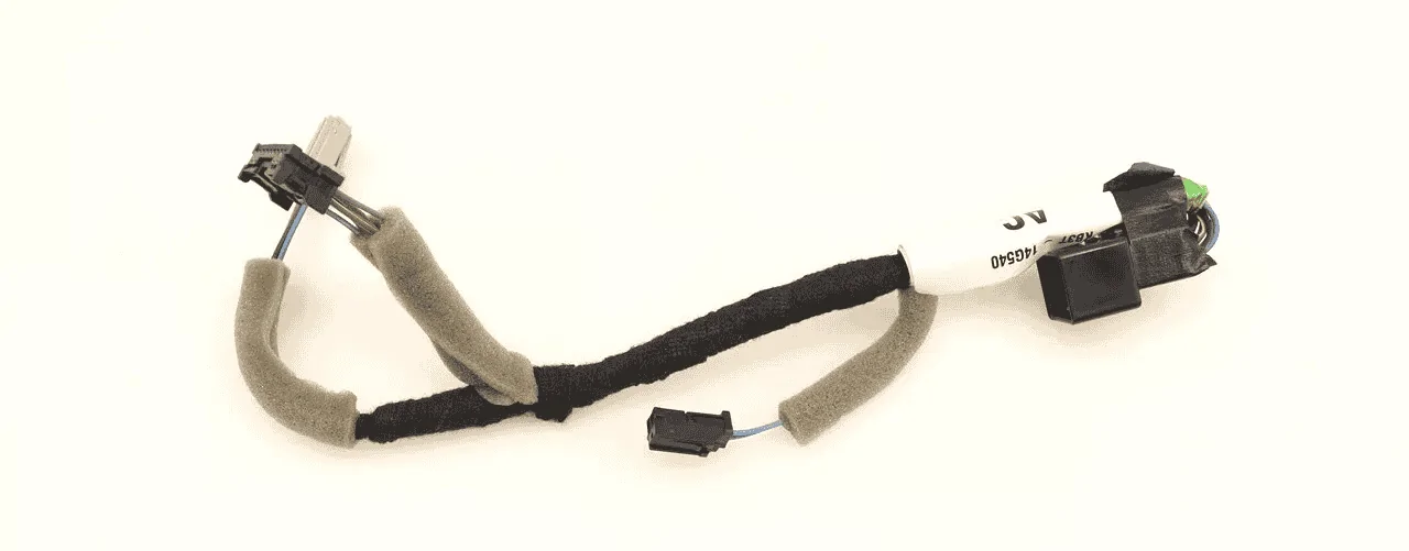

The Input (Mian Harness) Connector is (Harness # 14334)
The Jumper Harness which you WANT is (Harness # 14G540)
So with some digging here is what I found, again this needs verified as TRUE Part Numbers
But this Part Number - If NO RAIN SENSE is Installed. KB3Z-14A411-C
4-Total Connectors
Main
Auto-Dim Mirror
IPMA
IPMA Heater
This Part Number (If Rain Sense is Installed) KB3Z-14A411-D
5-Total Connectors
Main
Rain Sense
Auto-Dim Mirror
IPMA
IPMA Heater

Again - UNKNOWN if ACC is in these harness jumpers, I would imagine - YES
But for those who want to add a Tapping location for a Dash Cam, these along with the Dongar will let you do it.
Again, I have NOT verified the Part Numbers but appear to be correct but the TOP pic with the (4-Connectors) does have the correct harness # showing (14G540)
And then you need to verify you have the wires needed (included) in that Mian Input Connector.
