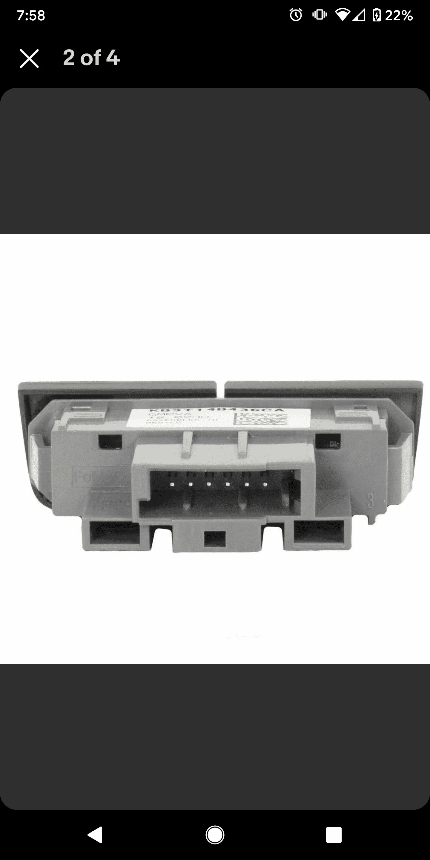

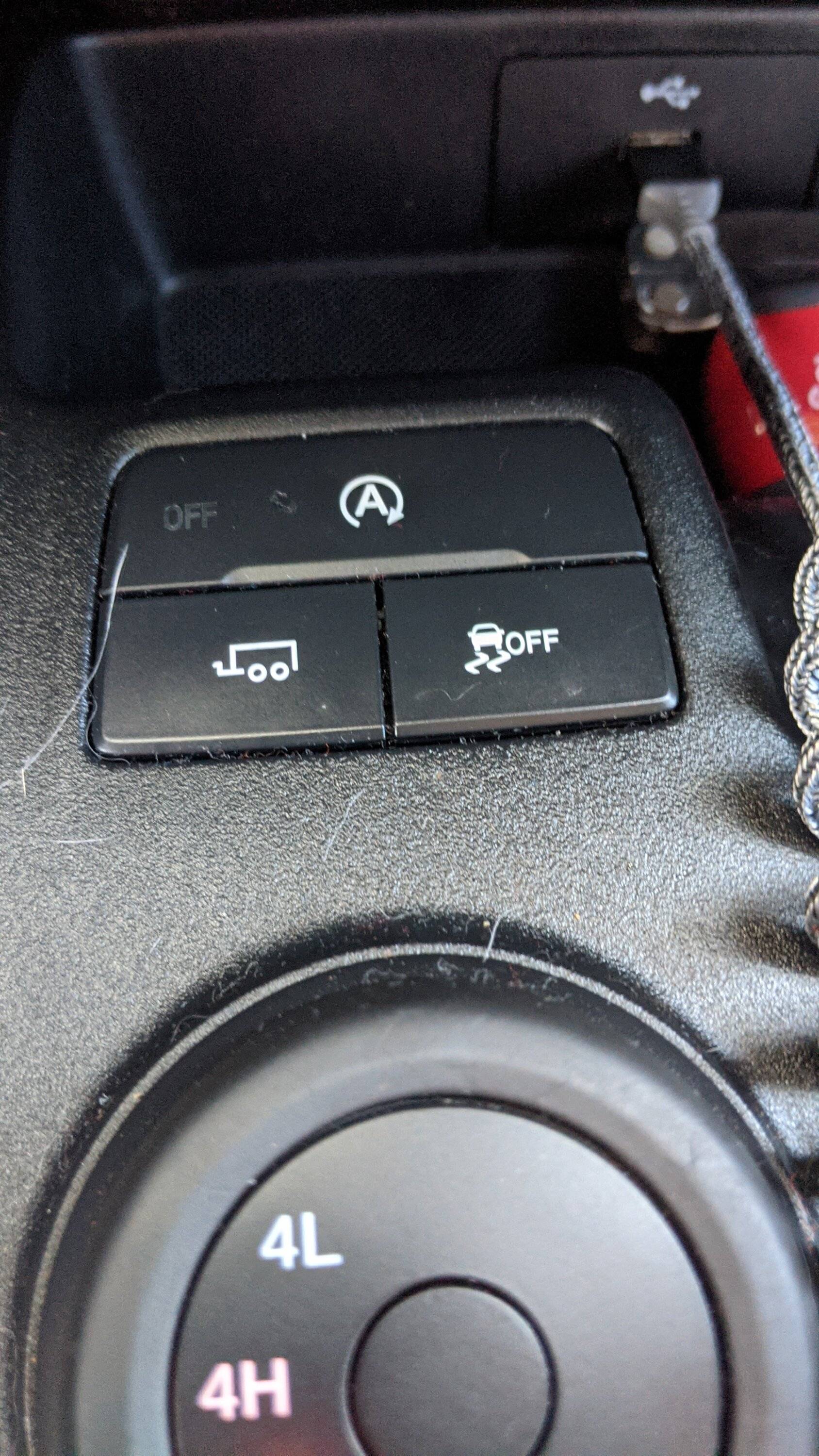

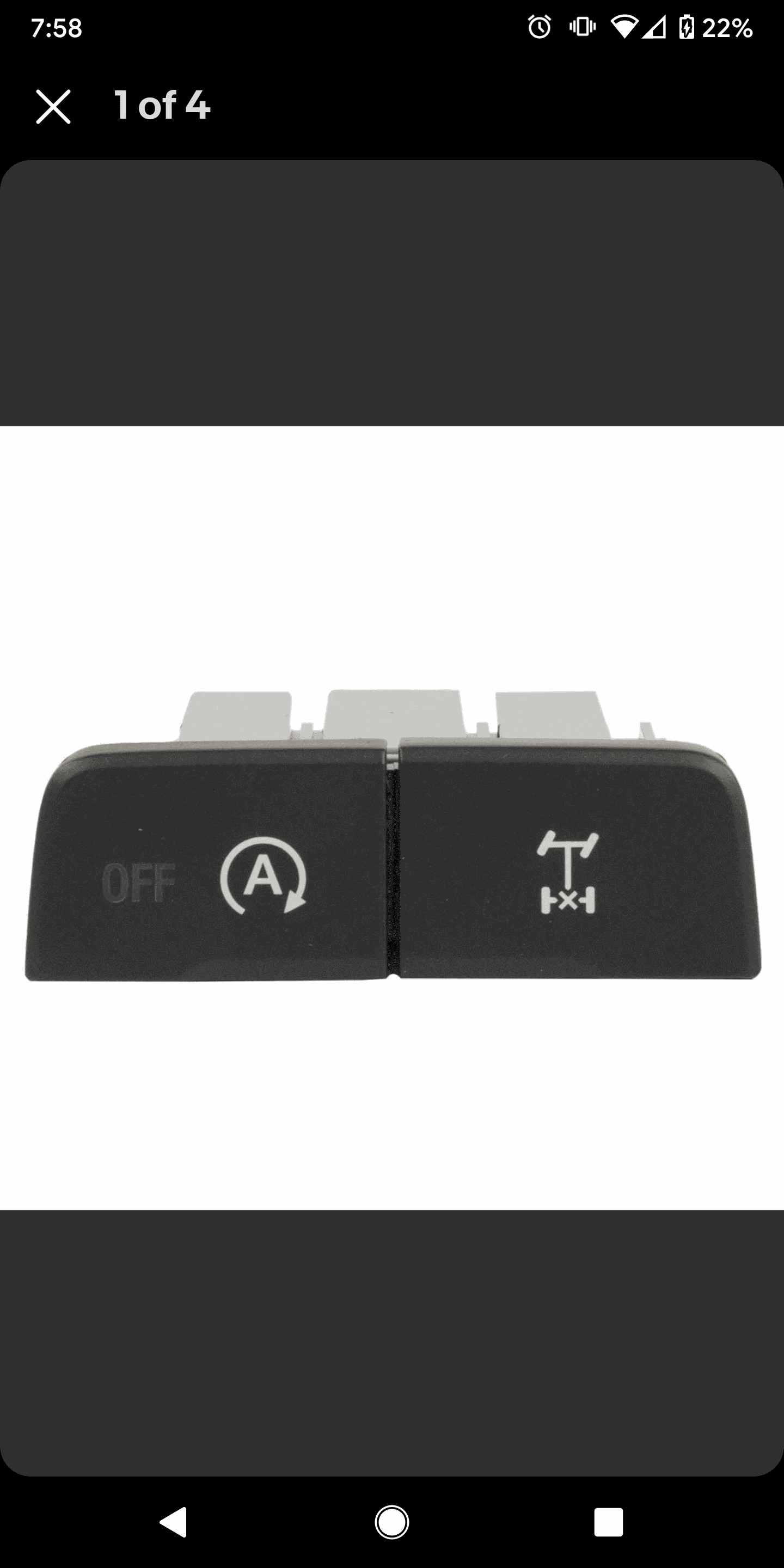

Gotcha. I'm probably(definitely) in way over my head on all of that. I have the switch coming, I'll ask the guys installing it if they can get it to work. If not, I'll just return the oem switch and go with a dash mounted switch the locker comes with. Would obviously be nice to make it all look tidy and get along with my existing controls, but I can live with it the other way too. Here is a pic of the switch I ordered, and my current control layout.

Thanks I hope too. I'm not even sure there is a connection the wiring from the locker would be able to plug into on this switch. I'm still trying to get my brain around it all. Maybe if I brought it to a Ford service center they would help?

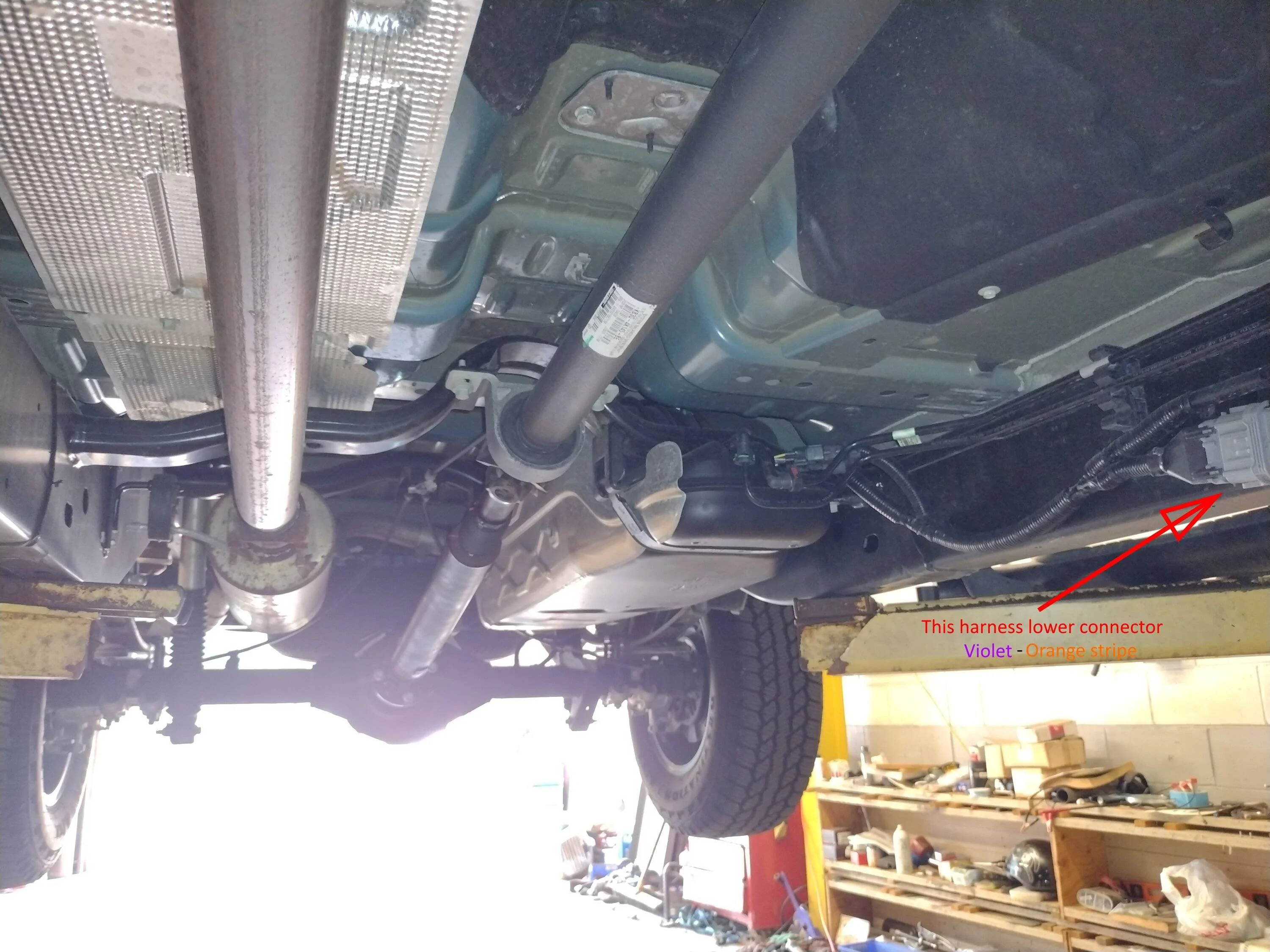

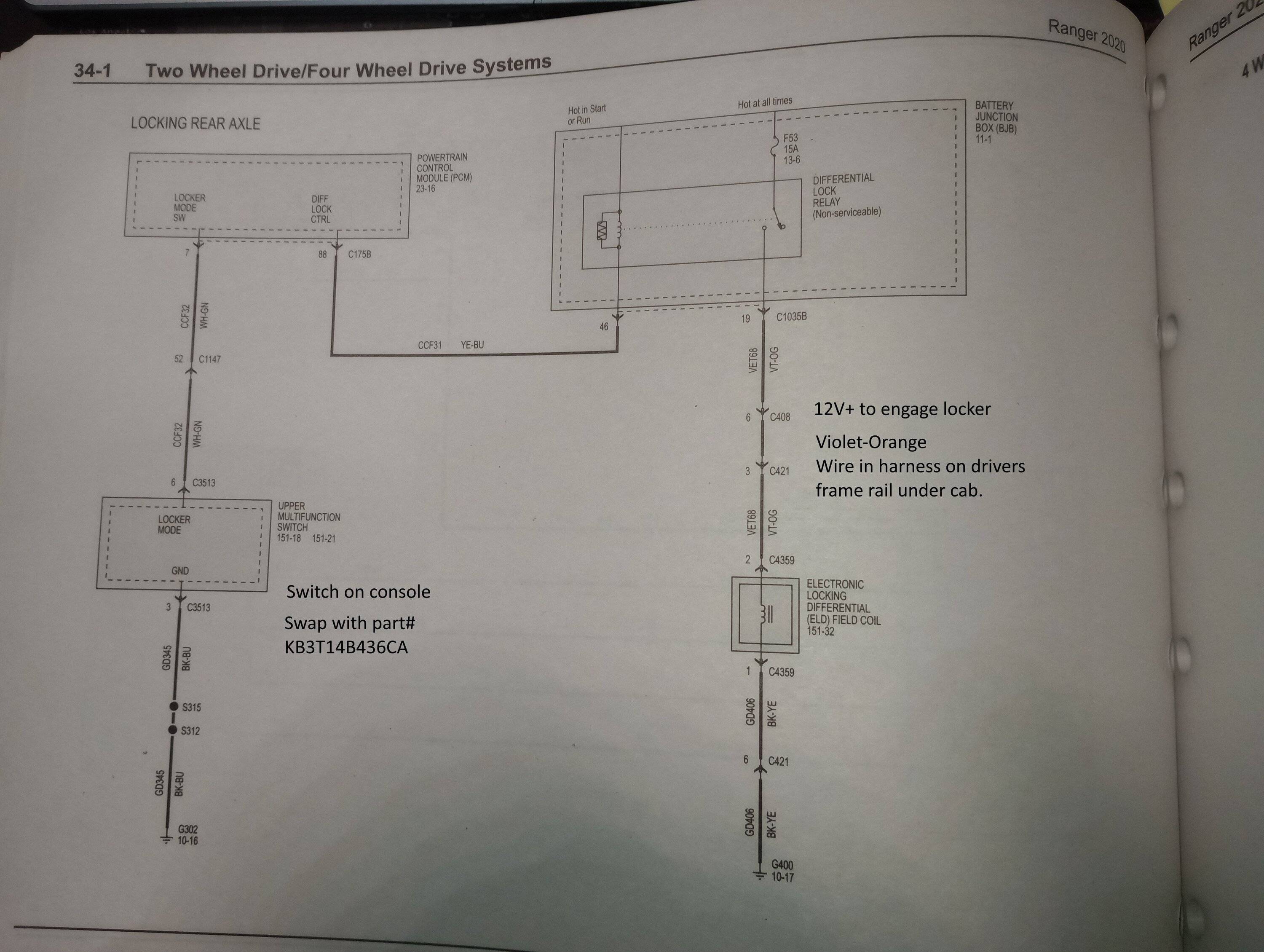

Even if your truck didn't come with a locker it still has the fuse and relay for one. But the rear wiring harness will be different. To use the factory button swap out the switch on your console and use Forscan to turn it on under BCM and IPC modules. Then tap into the wiring harness under the cab to power the locker.
