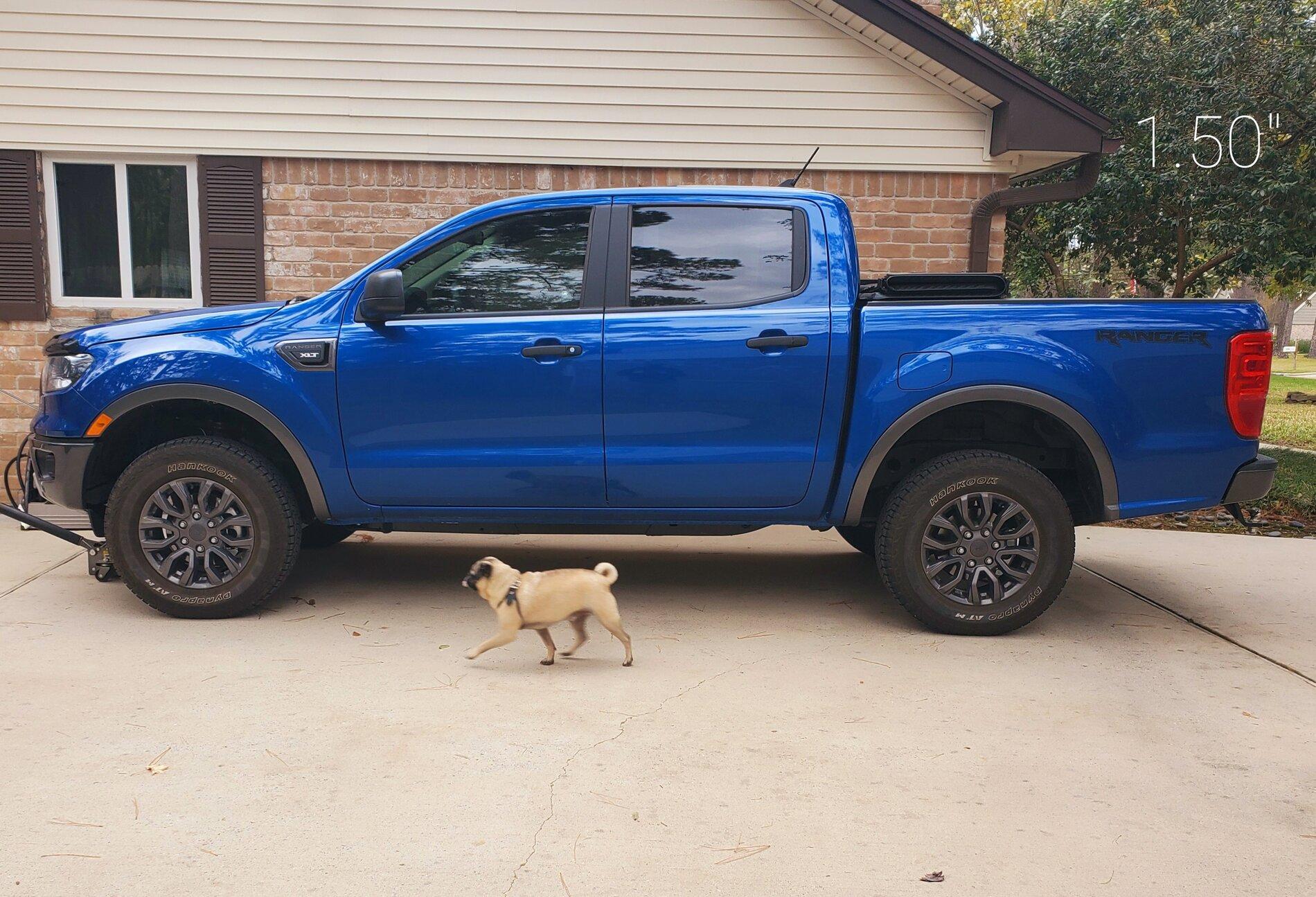

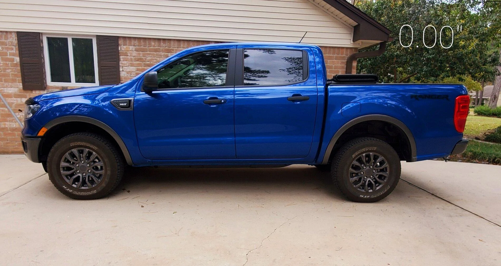

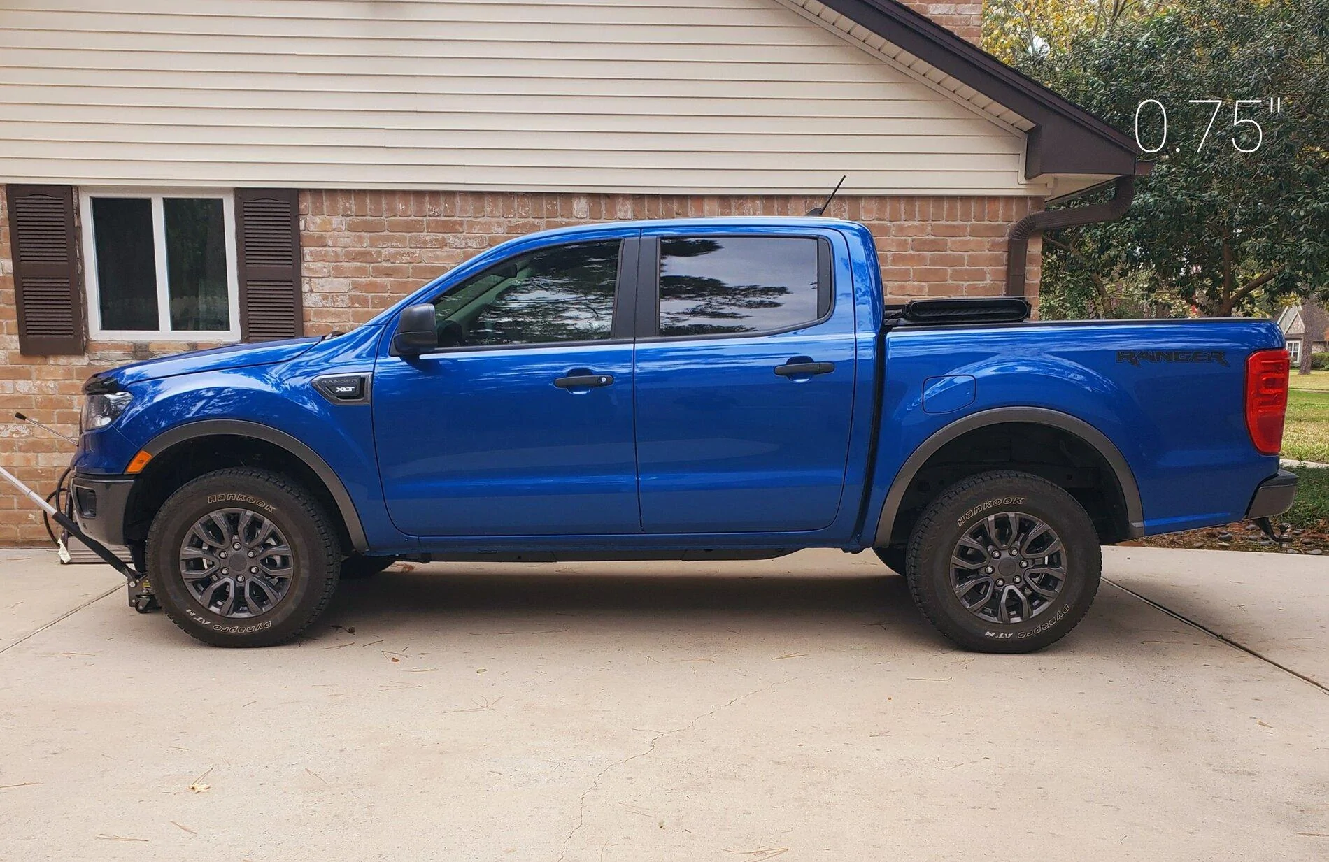

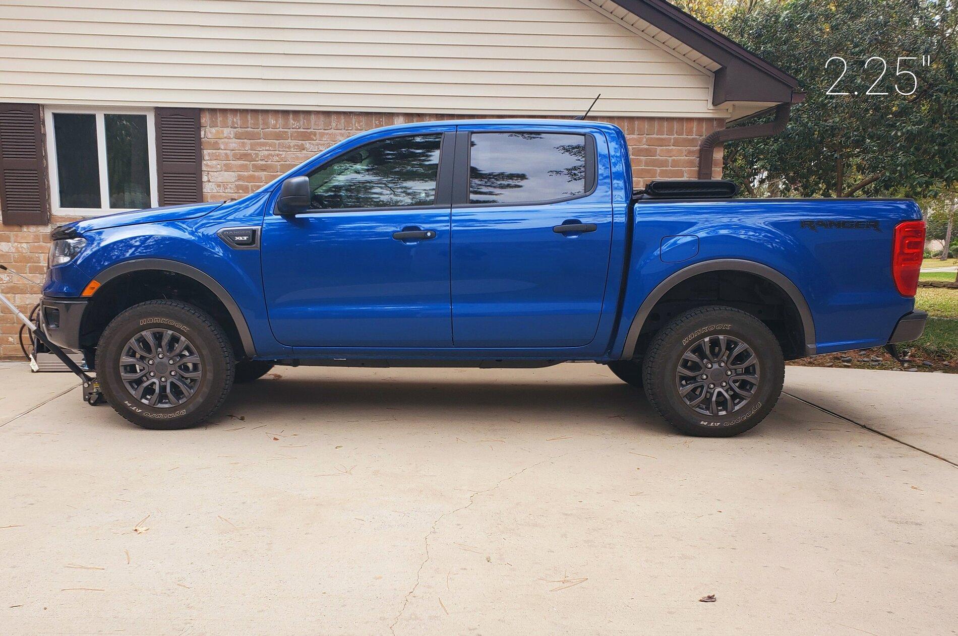

Hey gang,
I wanted to get an idea of what the different settings on the eibach front struts look like. I thought I wanted to go with 1.5", but after this test I went with the 2.25" setting. Glad I did!
I kind of feel like this should be reposted as its own thread and stickied!

Hey gang,
Great post and super helpful pictures. I wasn’t looking for a full level and for me personally, I like the look of the 1.5” lift.

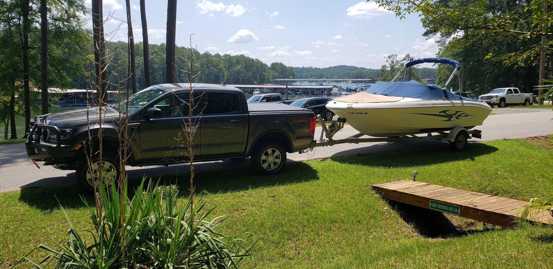

I did rough measurements when I first bought the truck and 1-1.5 inch in the front would make the truck level with 500lbs tongue weight, which is what I estimate the max I plan on hauling. 500lb tongue weight is about 5000lb trailer, give or take some depending on setup.
Not a fan of opposite rake when a leveled truck is loaded down. To each their own.
Hopefully may help someone thats wondering.
Yes. I was not happy when I initially did my truck and the front sat higher than the rear, UNLOADED! I'm running the Eibachs set to the highest with their spring, for 3.75" of lift. I went with that because of my bumper and winch combo. It eventually settled to about 3.5", maybe a little less. Now it sits level with a very light load in the bed. But if I put my boat trailer on it, I'm back to a sagging ass.
I've got rear helper springs coming that will add a claimed 750lbs. capacity to the rear.
