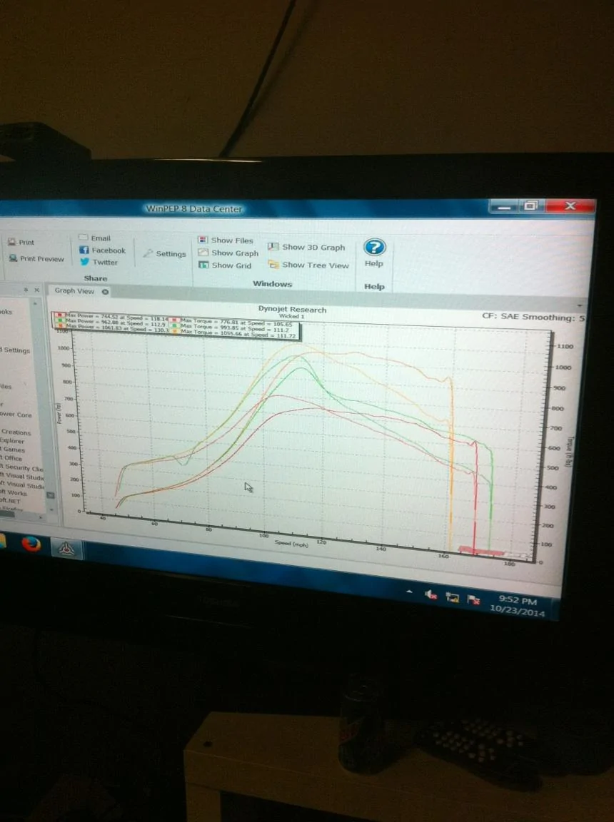

Here is a dyno from my 88mm T4 turbo 6.2 liter (LS) in a Mazda RX-7 running pump $2/gal e85 (actually it tested e80 on my digital content meter). We later learned that we had the wrong wastegate springs in it.... so no matter what we commanded electronically (Holley Dominator EFI) the wastegates couldn't maintain the boost levels in the higher RPMs. The best numbers on this graph were only running on 14psi!!!! I've had it up to 22psi in 5th gear and it was bonkers....
e85 works that is for damn sure and better than spending $10+/gal for real race gas.
