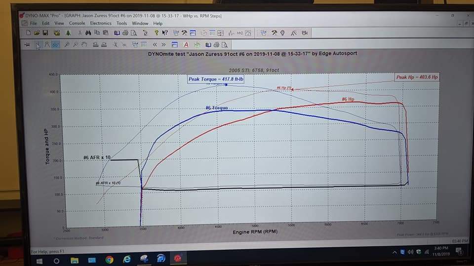

Sorry, I misread it on my phone in following the graphs and trying to read the run numbers.
That said, there's not a whole lot of difference between the red and green, though green is better. They are both peaky torque curves, which is what is hard on rods/bearings/wrist pins.

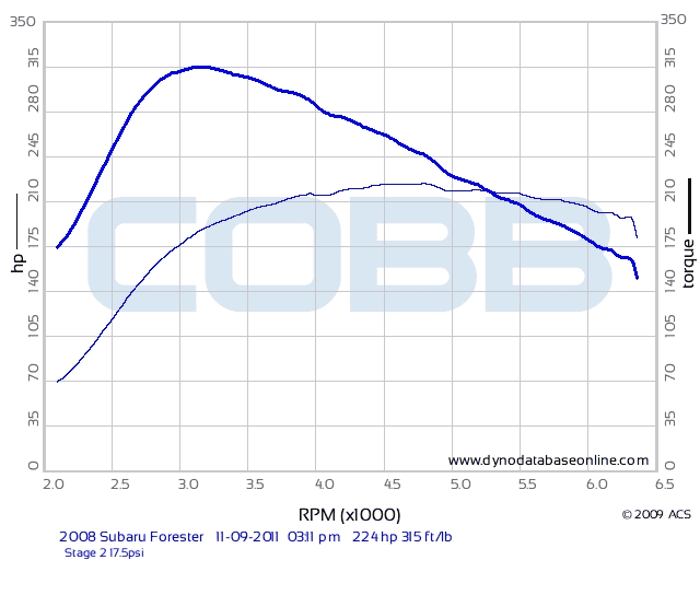

Again, that "swell" is common of a small turbo. Here is a Subaru doing the same thing. A lot of tuners do this... Ramp up boost about as high as it will take, then it inevitably drops.
Where this is what I would consider a flattening of average torque.
