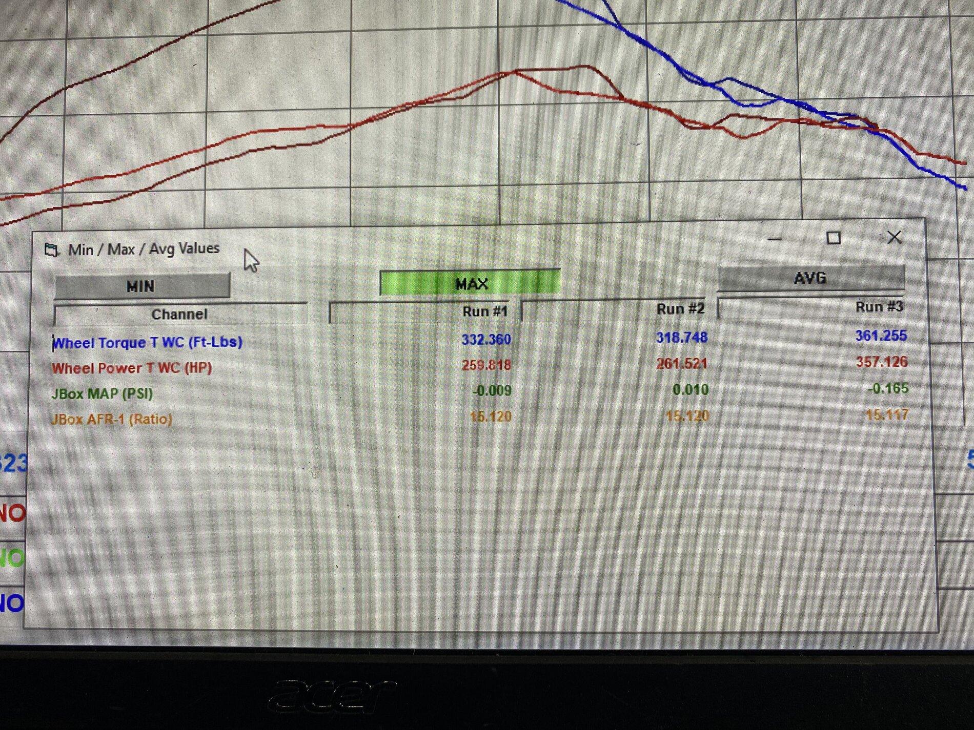

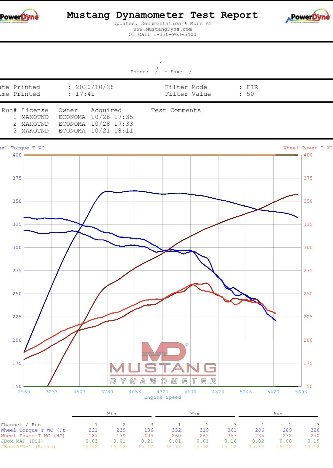

I’ve had the stock tune with 87 octane in the truck for about 4 days and 200 miles, here is the comparison. I did 2 pulls back to back.

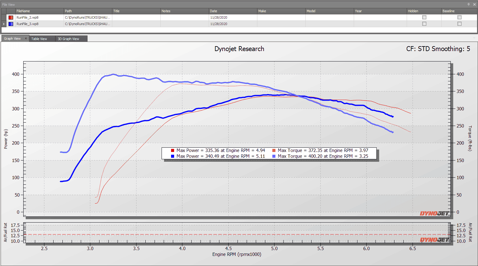

Another zfg racing e85 tune only dyno result!

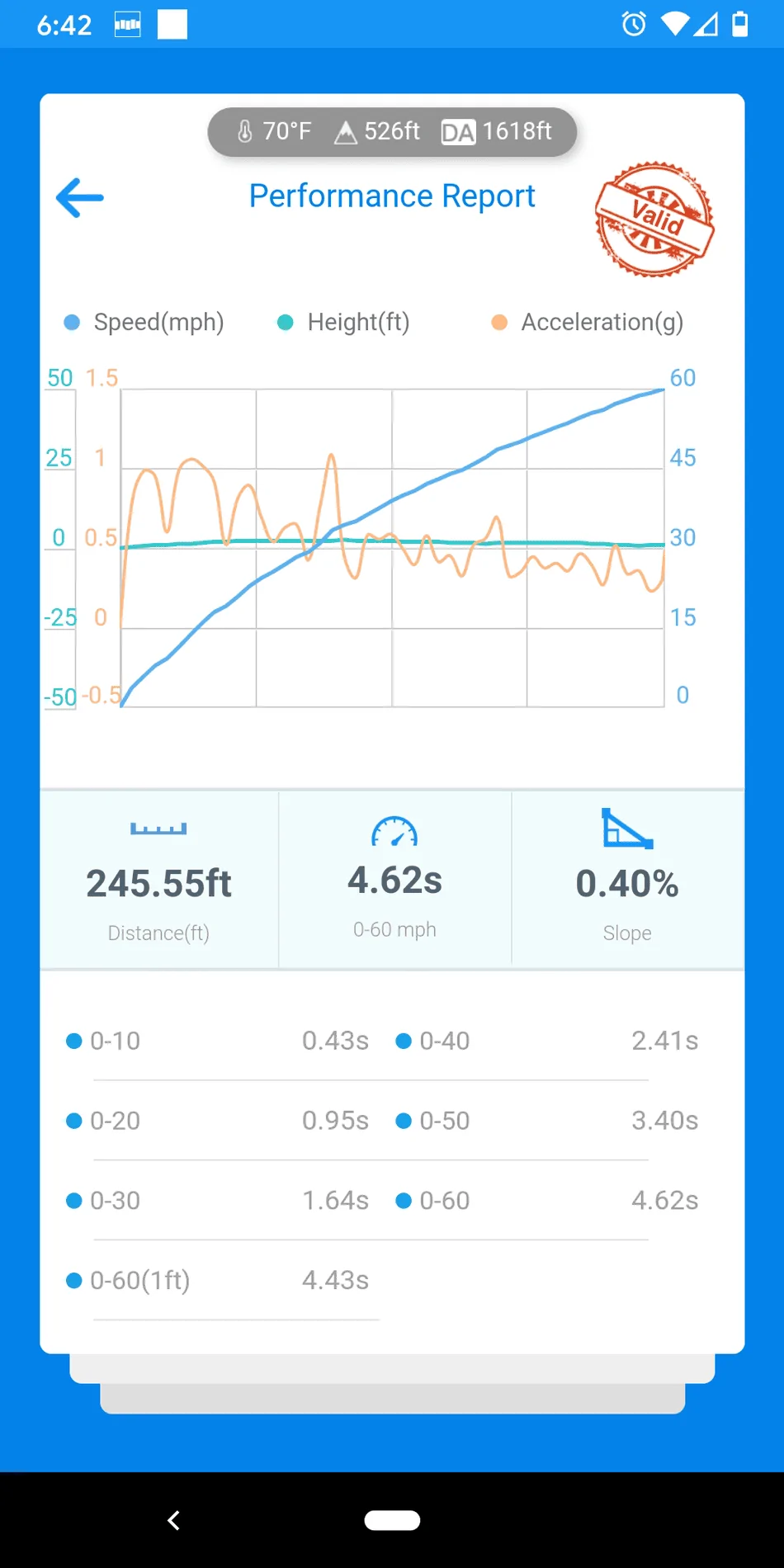

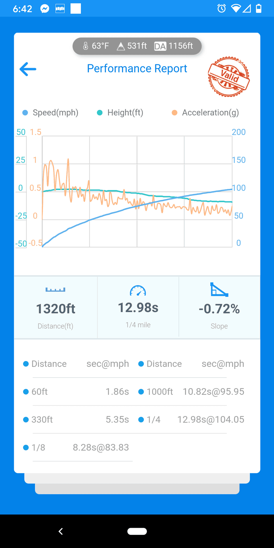

The XDI upgraded HPFP is not needed, you will actually run out of injector before HPFP on ranger. Although the xdi pump is larger, the operating pressure of the the 2 smaller pumps (HPFP 35 and 35evo) is 2800 and 3200 psi. the factor bosch pump is running at 3600 psi. Going bigger but lower pressure is actually going to cause you run out of injector sooner. So the really you need to do the HPFP 60 or do the smaller pump and injectors.
You would be surprised at the the factory fuel system on these. If you look around there is a tune only ranger with 12.9x draggy times. Tune only on e85.
This one ?

Tune only, someone ( can't name names?) is pushing me to go full exhaust but I'm hesitant. I know the stock exhaust is choking my power
