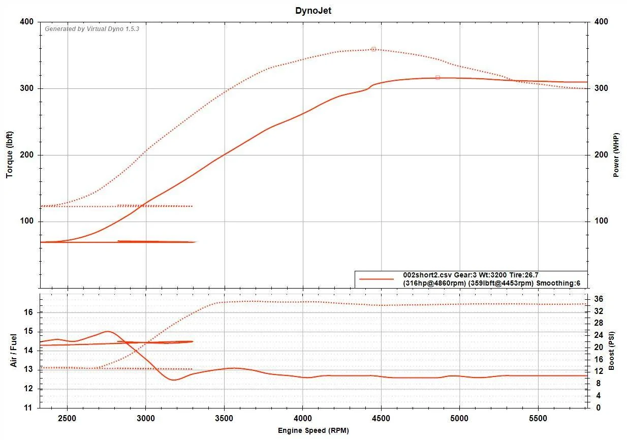

It's really not hard to fix... Just don't ramp the turbo up so high to get those peak numbers. This is one of my cars, which is a Saturn Sky Redline that I tuned on E50. A lot of the tunes/dynos I see, people ramp up boost to like 26 PSI, but it falls. This gives high peak numbers, but it's not really faster and when you do get into that range, it's harder on the engine for little gain. I just settled on 21 ish PSI flat and worked timing to help smooth it all out.
Getting boost flat on a smaller turbo like this takes a little more effort in scaling things... Ramping it up is easy!

I’m assuming you tune these trucks often enough to know that.

I tune a lot of engines daily.
Right. Like I said… then you know that different systems and combinations work/respond differently. It’s really not important that you tuned a Saturn, we’re discussing a 19-23 Ranger. It’s not even the same as tuning an ecoboost Mustang for that matter.

I tune Fords as well. We also have a Ranger and Maverick, which I used for tuning development. I know A LOT of different tuning platforms.
An Ecoboost Mustang isn't too dissimilar.
The original dyno I posted earlier in this thread was comparing and STi tuned on Cobb and a turbo S2000 tuned on AEM (now Haltech). The means of tuning are just a way of getting things running how you want/the engine wants. For the most part... it's all the same (when you've tuned for like 20 years). Hell, the means of achieving boost on the Saturn isn't too dissimilar to the Ranger... It's not a WGDC table.
