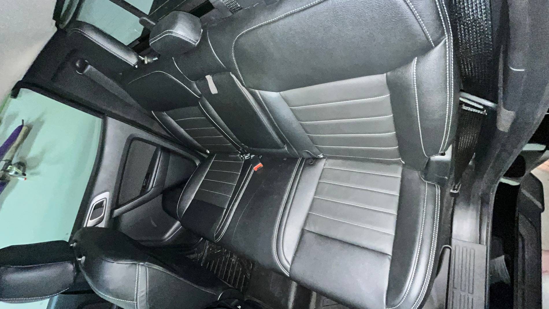

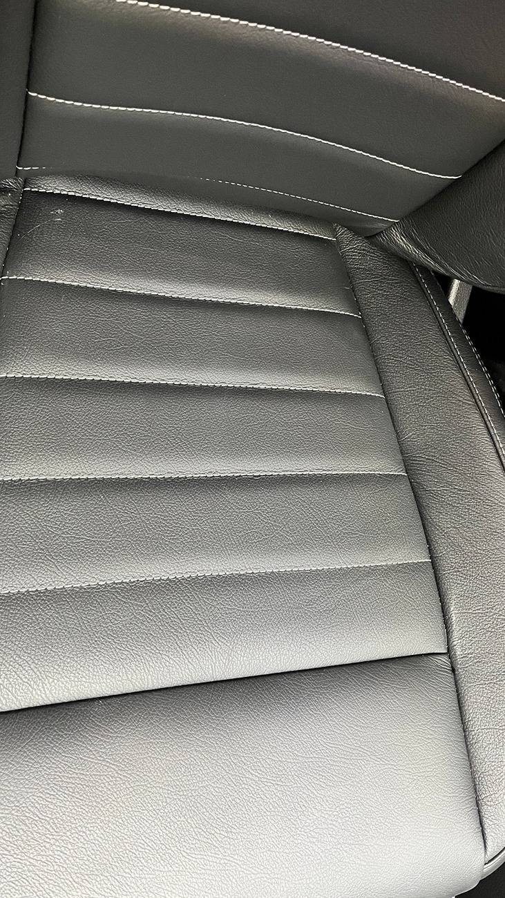

I've uploaded pics of back and passenger seats.
My thought is the density of the foam, and the leather combined with the rails that the hog rings attach to, along with the weight of the person. Factory leather being thinner it will stretch and over time. As you see from the previous photo of the driver's seat and between the cross stitching, where the hog ring rails are located are wrinkled.

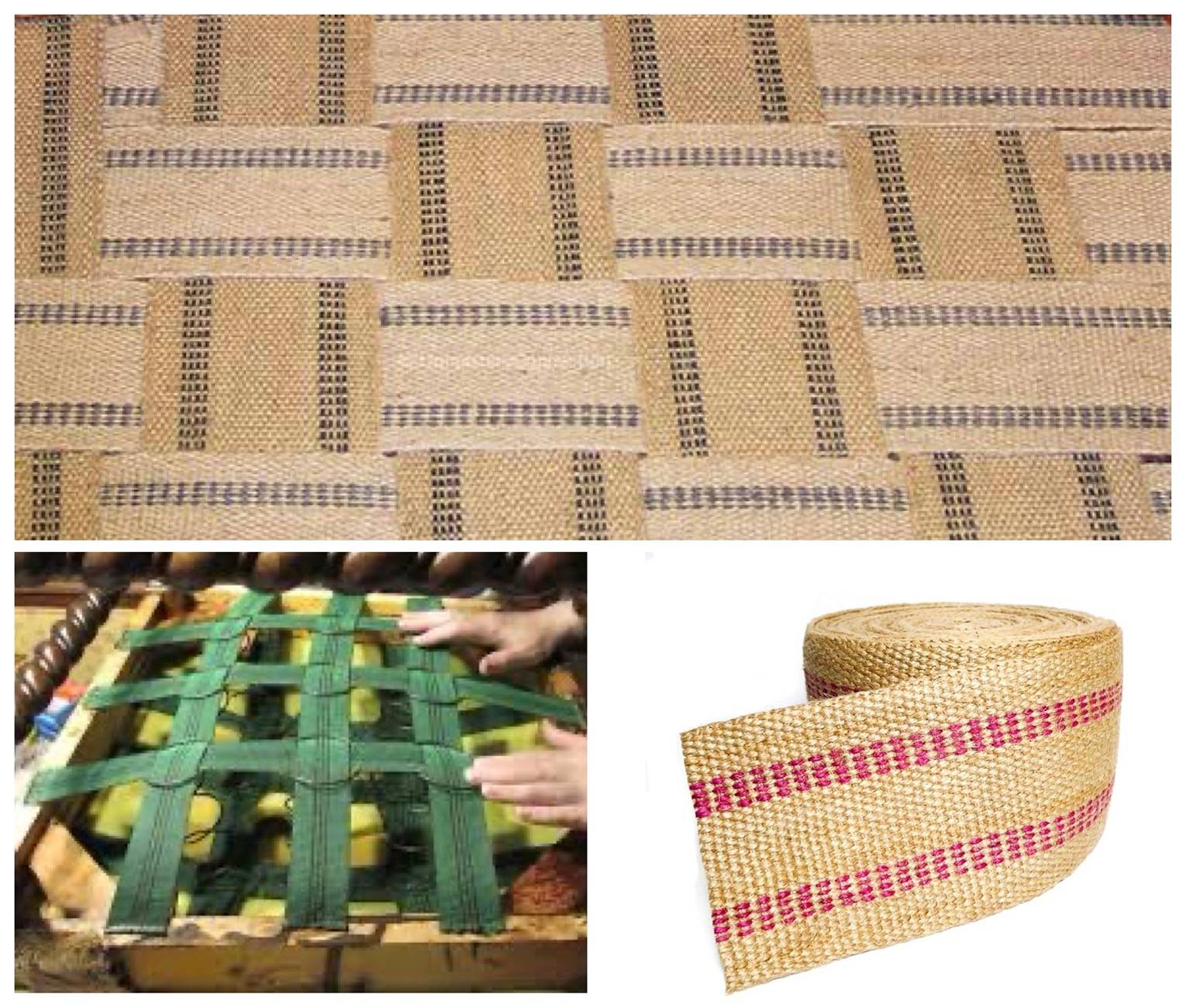

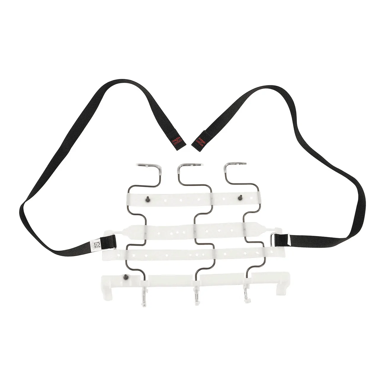

It would be interesting to see the “straps“ used in the Transit TSB. I can’t help but invision jute webbing like that used in furniture upholstery.
The challenge is attaching it to the seat frame but this, or something similar, would help with spring deflection and keep the foam from pushing down through the spring mat assembly (especially if the weave is tight). Nylon webbing might also be an option if you have some on hand.
If this application is too difficult to attach to the spring mat assembly, some high-quality upholstery scrim might be an option - it’s thin foam (1/8” or 1/4”) laminated to fabric and the good stuff is higher density foam and has better, thicker, tougher fabric than the cheap stuff. It could be cut to size and sit between the springs and foam, keeping it from pushing through while adding support. The key here is to get the best quality scrim you can.
Like this

Interesting. That spring mat appears to have different/maybe better plastic, ribbon-like spacers than on the Ranger. Those spacers look like they would help keep the seat foam from sinking down through the spring mat quite a bit, all on their own.
I’m curious (more like baffled ?)about how the straps are laced - do you know if the TSB includes instructions for that? My first thought is they would be wrapped perpendicular to those plastic spacers to create a woven effect for maximum support.
If nylon or jute webbing could be woven through your spring mat front to back and side to side, then secured tightly, it might be enough. No harm in adding some additional padding to the seat foam though.

Perpendicular but not woven - got it.
I think it’s those ribbon-like spacers that make that solution work. You should consider strapping in both directions. Getting the straps tought and fixed in place might be some work - maybe washers and rivets/bolts? A long strip of Velcro? Double D rings like in a belt?
That webbing is certainly strong enough, inexpensive, and easy to come by.

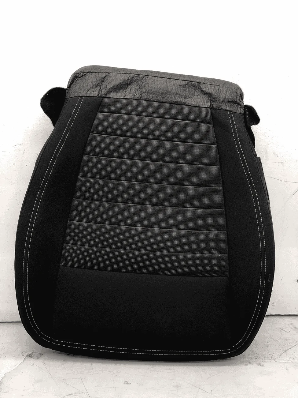

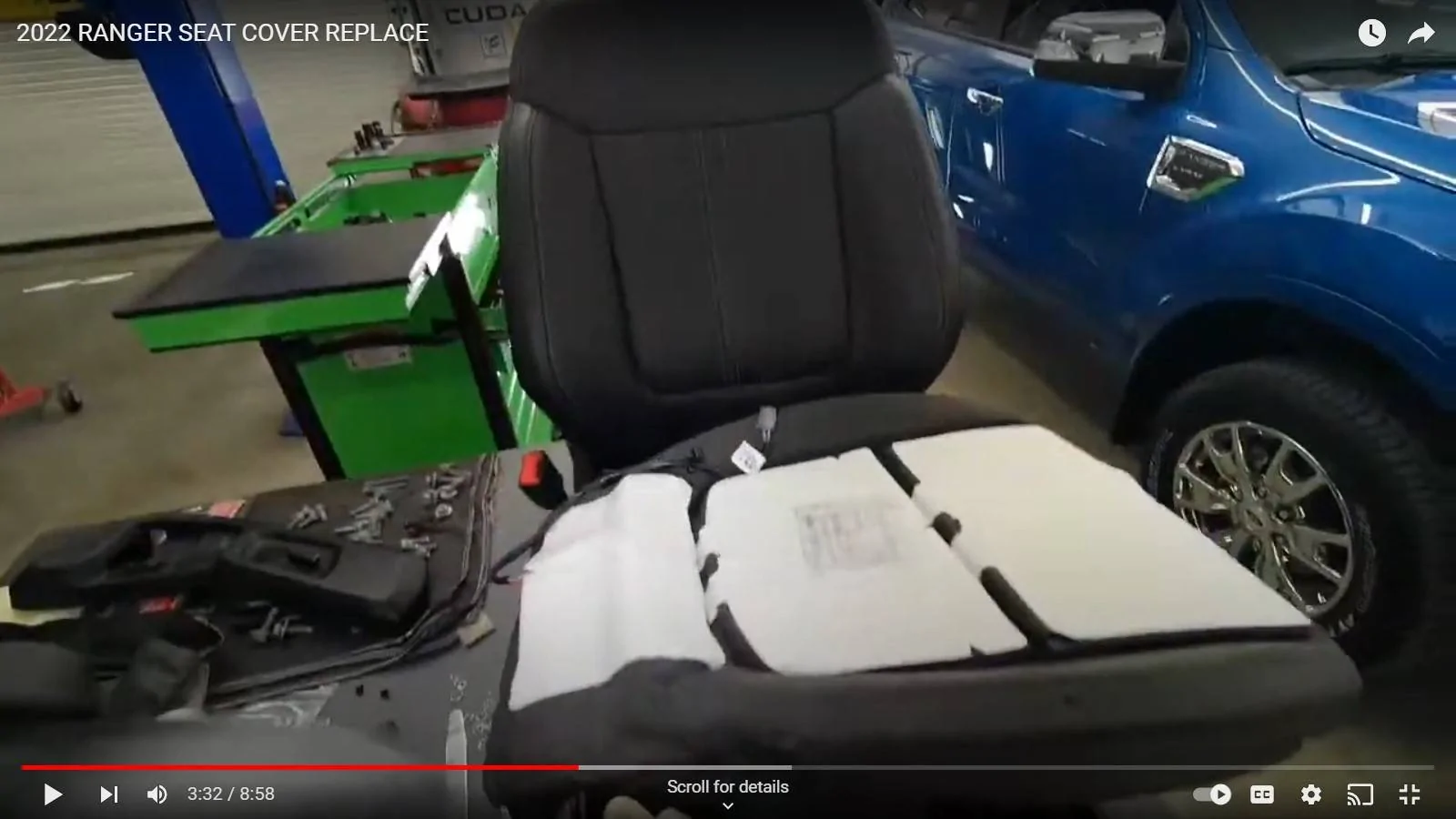

I do have a question as I am looking into swapping the covers, but my main point of uncertainty is the Part Number of the cushion and have no clear picture of the cushion (naked) except for the Lariat (Bolstered) cushion.
My Cushion P/N: KB3Z-2163223-B
The XLX / XL - List the P/N as: KB3Z-2163223-A
Now the last dash (B) is supposed to represent a Revision, not a complete design difference and that is where I am hung up and where you can hopefully help.
When you had your covers off, did your cushion look like this?
Note: The white is the heater mat, so I am trying to determine if the (Dash A) eliminates the rear bolster or not. No clear picture anywhere.
Or
Did yours look like this one, and the only difference would be your covers do not use the rear attach points (hog rings) and the cover itself flattens that bolster down
I have a feeling that I may have to order and see if the (Dash-A) is in fact a different design.
Ebay - Ref Pic - Passenger Side
I wish I could see this cushion (naked)
