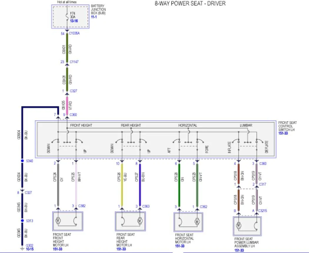

Ok then it's just the matter of, how many wires do you have running to your seat?
If all 10, then it's just plug and play for the Seat Power (Adjustment)
If not all 10, then you can tap into the 30 Amp Power - Coming off the BJB and either re-pin the main connector to the seat (add it) or by-pass that connector and run direct to the seat switch.
and then run a ground to the frame.
Fairly simple swap, as long as you do not want to add heated seats (in the programming) plus more $$ to add the FCIM and it may not play nice if only doing (1) seat.
No Forscan changes - that I see for the Seat Track & Buckle - Sensors
Seat Power - Plug & Play (as long as wiring is present)
Airbag - appears plug and play - as your current seat has it already
Seat Heater - extra money and Forscan changes, plus may require both seats for it to work without errors.

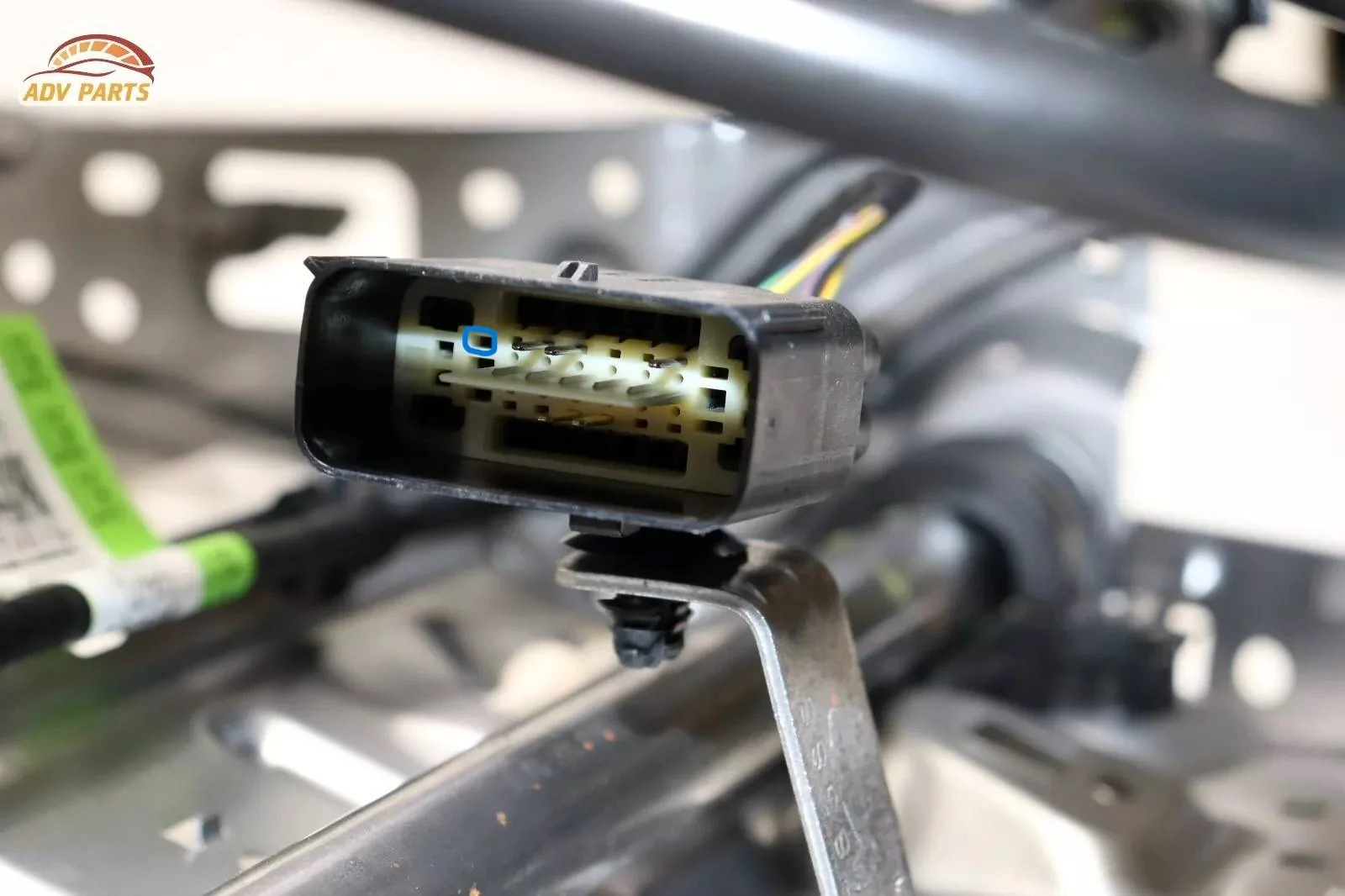

For a Ref: Here is how your (seat side) connector is pinned.
Starting at Blue Circle - Top Row (Left to Right)
Top Row
Pin #1 - Switch Power - Missing
Pin #2 - Not Used
Pin #3 - Dr. Buckle Switch (You Have)
Pin #4 - LF Seat Track Position Sensor (You Have)
Pin #5 - Not Used
Pin #6 - Not Used
Pin #7 - Grd for Seat Track Position & Buckle Sensor (You Have)
Pin #8 - Grd for Seat Switch & Heater Mat (Missing)
Bottom Row:
Pin #9 - Heater Feed (Missing)
Pin #10 - Heater Feed Return (Missing)
Pin #11 - Heater Sensor (Missing)
Pin #12 - Air Bag (You Have)
Pin #13 - Air Bag (You Have)
Pin #14 - Not Used
Pin #15 - Not Used
Pin #16 - Not Used
Note: Not Used = Not used and is an empty cavity
So, you need the other side of this connector to have the (Missing) wires, this is the one coming out of the floor carpet up to the seat.
If they are missing, then you will have to run you own wiring to Pins 1 & 8 or direct to the seat switch and by-pass this connector (if you are only wanting) seat power

Well when i installed my power seats i just swapped over the cut wires from the other end they cut and fed the wire for the power seats to the fuse box.

Here's hoping the wires are already present in the harness to make it easy then! Hopefully I will get under there later today. Update to follow one way or another.
