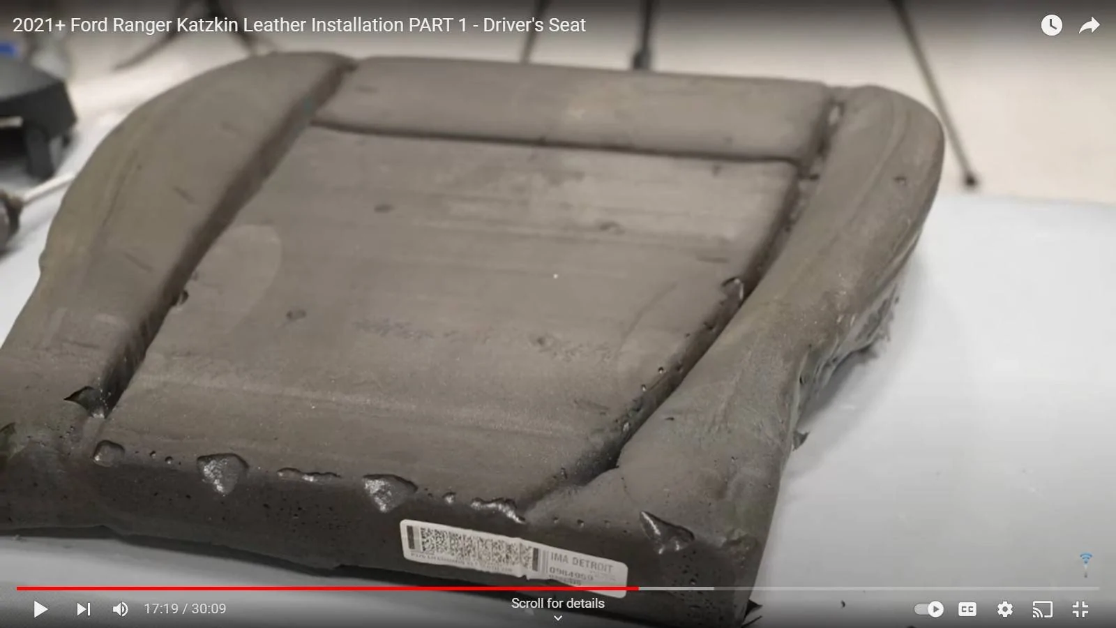

Well thanks to this Katzkin's Install Video
2021+ Ford Ranger Katzkin Leather Installation PART 1 - Driver's Seat - YouTube
I have confirmed that these are different Part Numbers, however this install was for - (Non-Heated) seats, so I wonder if that is the difference, and if the extra (Listing) slots are for the Heat Pad.
IDK - More Digging (required)
I am going to attempt to get a clearer still shot of that parts tag.

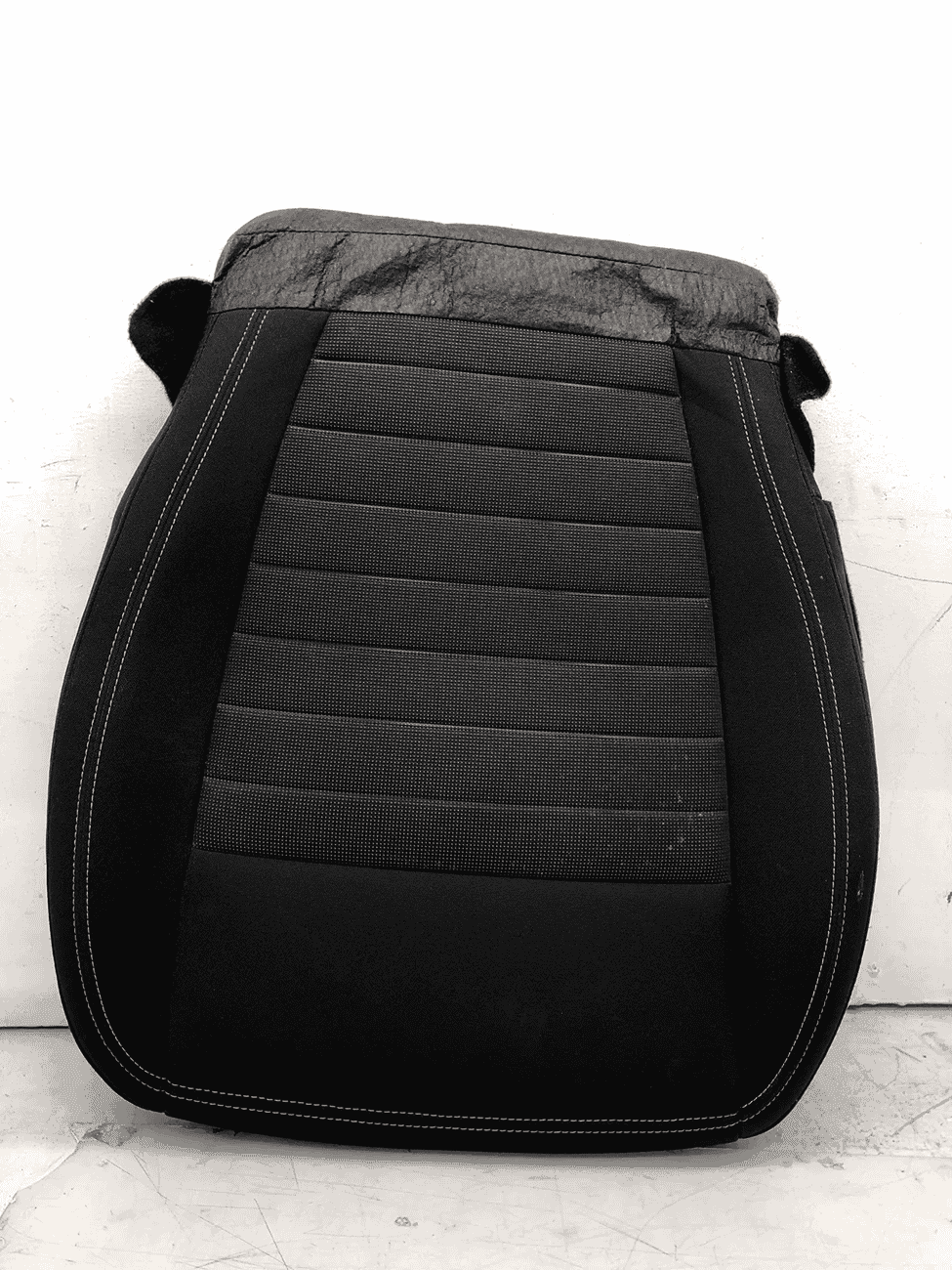

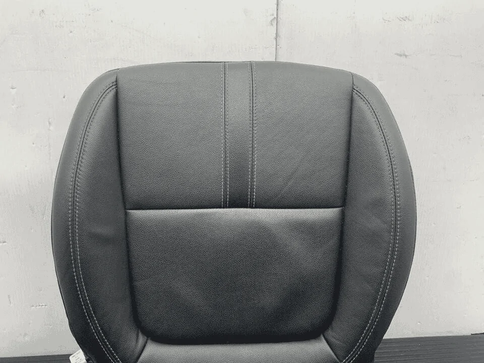

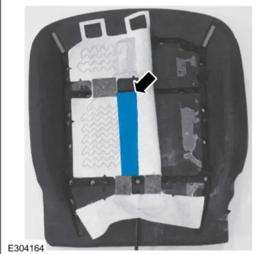

Heater Mat - Note how it is designed to match the Lariat Cushion, but again this may be a generic (typical) install pic
So now the question is - for those with (XLT - Heated Seats)
Which style of cushion is used and does the heater mat P/N change with it? Hmm

After looking at these (2) designs side by side, I believe my issue is the design of the Lariat seat cushion, that split on the back half of the cushion allows the cushion to flex and this (MAY) be what I am feeling (sagging)

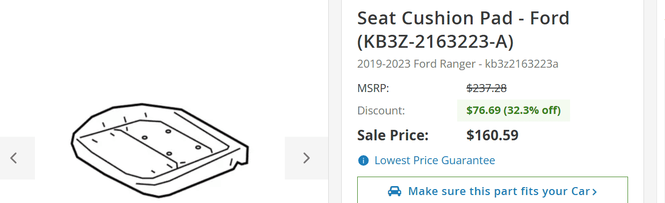

Until confirmed, this is my guess on the part numbers as if anyone has looked online it gets rather confusing on seat cushion parts across the trims, some have a completely different part number associated (with included Heater Mat and or Occupant Sensor) with no separate part number for the cushion
It appears to be the same part number for both Dr & Pass and the only different part number would be the Cover (Side Specific) due to the side cloth between the seat cushion and the center console (rubbing protection)
Lariat: Style 3 Horizontal Bolster slots
Cushion - KB3Z-2163223-B
Heater Mat - KB3Z-14D696-B
XL / XLT Style - 1 Horizontal Bolster Slot
Cushion: KB3Z-2163223-A
Heater Mat - KB3Z-14D696-C (Fits this cushion with Heated Seats option)
I am awaiting confirmation of these part numbers to be correct.

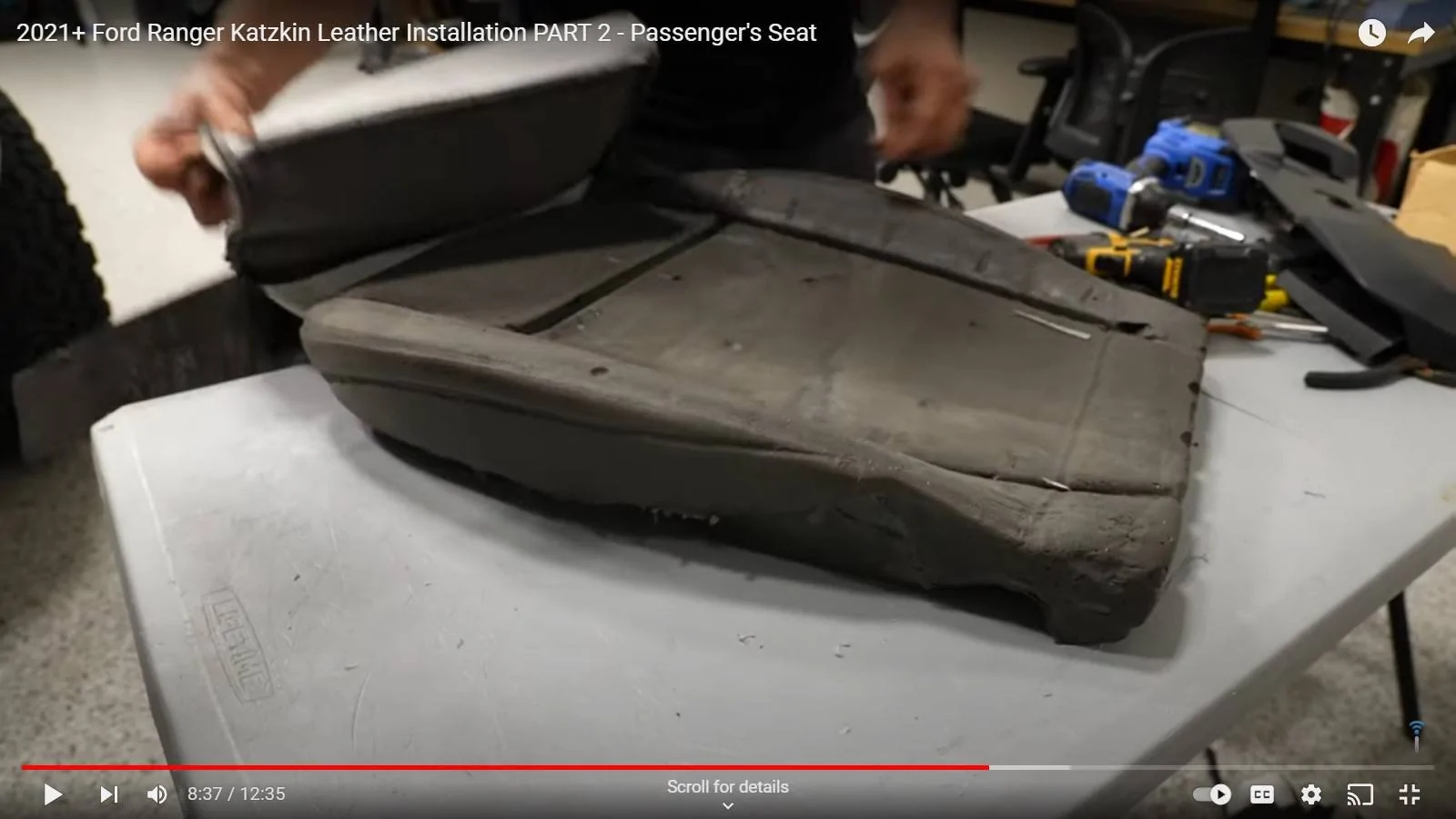

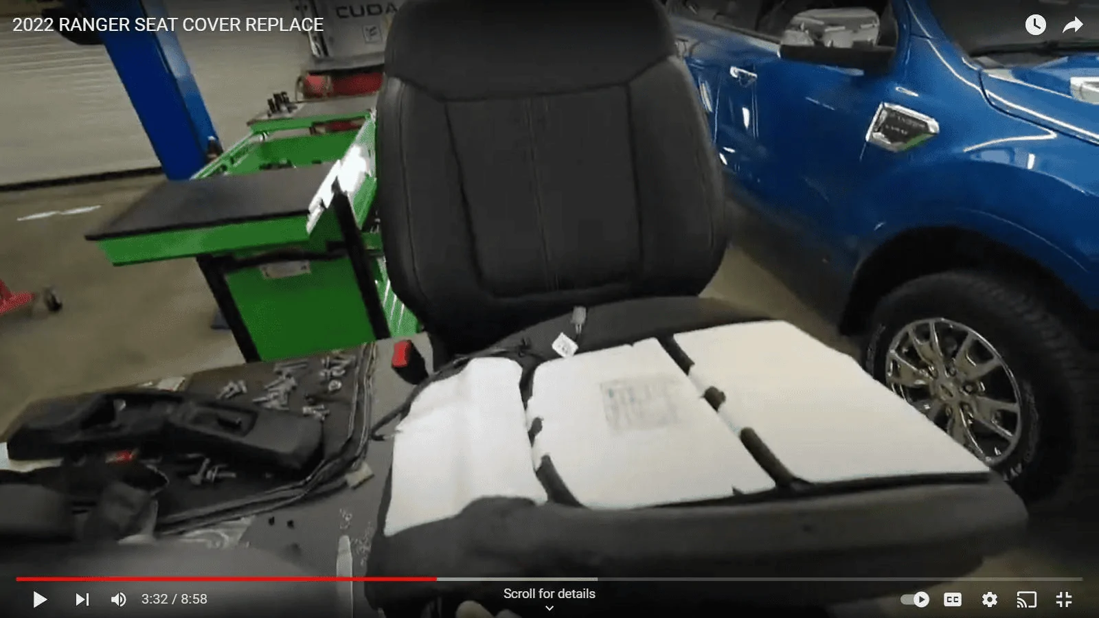

So, to confirm you have this design on your cushion
Note: This still pic was taken from the Katzkin install video
Note how the parts IPC does not match the cushion design (actual), this is what makes it somewhat confusing when looking in the parts diagrams and why I am digging into what is the actual design difference and Part Number (Change)

Here you go..
Bing Videos
I think seat heater pad is what has the center groove on cushion.
Ok, then you have this cushion design as the still pic was taken from that video you posted.
and it appears they are only using a different cover, and the cushion remains the same part number the (-B) is the revision change and (MOST LIKELY) if I were to order a (-A) I will receive this design as it is the most current revision number
The only thing that makes sense on how to get a (finished view) on your cover and this (2nd) pic would be the length of the (fabric) seams or (Listing Rods) that change how far down (Tightness)
to create the different design in the finished design
I have reached out to Benny on this and await reply
So, your cover has mounts (listing rods) that attach in the center of the cushion but do not pull it downwards into the grooves? Correct and give it a smooth cushion appearance
Unlike This one: Which pulls the fabric tighter (down into the groove)
So, if I am correct your cover only used the (side & center) attach points and the rear attach was either not used or it was longer to eliminate the rear bulge in the bolster design
Since part of my issue is with that rear bolster, my tailbone rides on the outer edge of it unless I scoot forward some (slouch) that's why (not I am focused) on that specific spot as part of my discomfort area.
Just trying to determine how the same cushion can provide a different finished look when the cover is attached and what I thought was a different cushion now appears to be just how the cover is attached to it and that may be my issue.
After Benny replies, and I get a final confirmation on the part numbers, I may just try switching to the cloth covers (trial & error) nothing wrong with trying them out.
I am waiting on the Cushion / Cover / Heat-Pad - Parts to arrive as well as Hog-Rings and Pliers as I have been holding off pulling to actual cover until everything arrives
Install the new cushion (assembly) then play with the off coming cushion assembly (different cover) and or upholstery shop help in getting that cushion to comfortable.
So, it appears at this point (if the cushion) is the same part number. I will be interested in you off covers, for my testing
