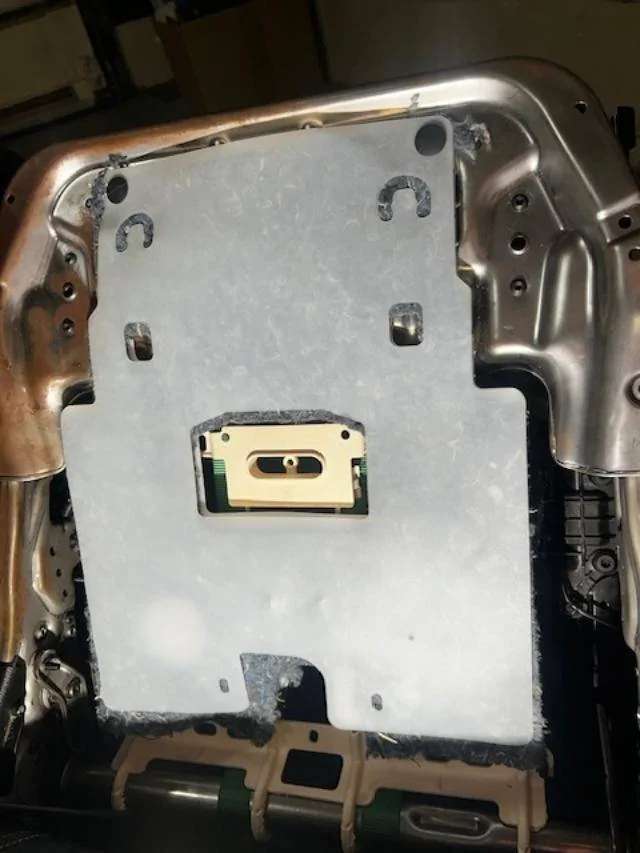

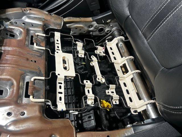

Occupant Sensor Mat - designed for the passenger side (with the actual sensor removed)
Just using the plastic and fabric padding as a support for the cushion so it does not compress down and past the spring mat assembly.
Helps some in comfort but not greatly

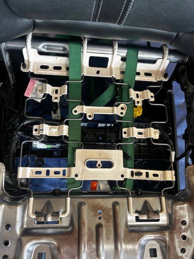

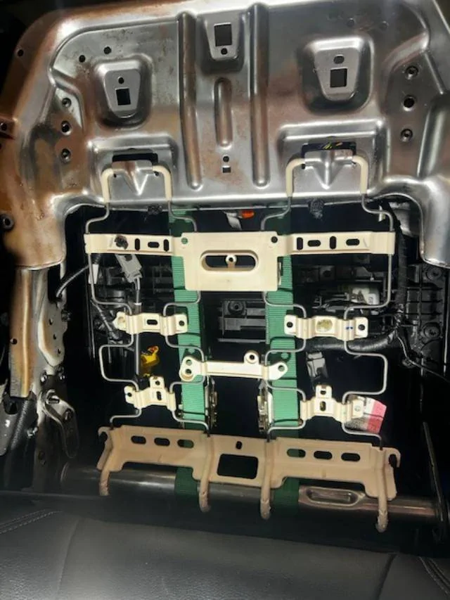

Temp install of cargo straps over the top of the rear support bar. Raises the cushion but you can feel the straps. This was a BUST.
Straps catching the downward swing of the spring mat to stop it from dropping so low.
Raises cushion some but feel the plastic on the support clips or the rear listing rod of the cushion.
NOTE: if you pull the straps too tight you can pop the clips off of the rear support bar and possibly break the spring mat assembly itself.
So, this is a possible BUST, as I and the Upholstery shop have concluded that this is a possible addition (if needed) to be included with the seat cushion modification. just keep it slightly taught to catch - but using a wider webbing

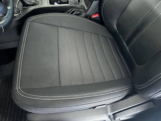

Cloth Cover difference over the Lariat cushion attach difference
Moves the attach point forward about 1 inch, so alter the sew hem point of the cloth cover or get a different PN cushion.
Plus, the cloth cover eliminates the rear attach point that the Lariat cushion has for the rear bolster ridge, but that bolster ridge is still present.
So, a cloth cover over this cushion would be a BUST. Unless cushion / cover is modified.

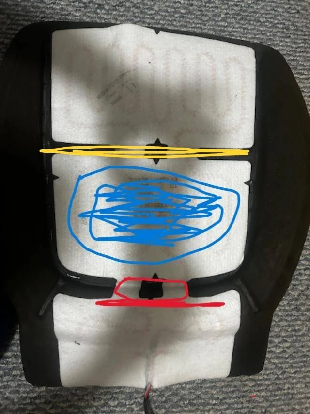

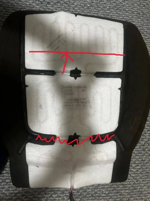

My cushion, if you take your fist and press here you can press all the way to the floor, I know not a perfect way to test density, but this is what I feel on my tailbone and hips. It is almost like a pillow top mattress in softness.
If you flatten out your hand and press here it does not sink to the floor, but your hand will sink into the cushion, and it will have a springy feel to it.
This is precisely why some of you have a LEANING FEEL to the cushion and the roll feeling when in a hard turn. The body weight is shifting on that springy soft cushion.
Now another issue in addition to that soft springy feel is the location of the rear listing rod and rear bolster (ridge) this presses into my tailbone, and I catch the outer edge of the ridge of the rear bolster with my but.
Compile that with the sinking cushion, now the center hem / seam is pressing into the back of your legs.
Cushion Soft / Springy Feel (Press Here) - BLUE
Rear Listing Rod and Bolster (RED)
Center Hem/Seam - (YELLOW)

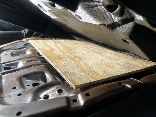

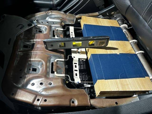

While waiting for the new cushion (Cloth Cover - Style) I did another (let's try this)

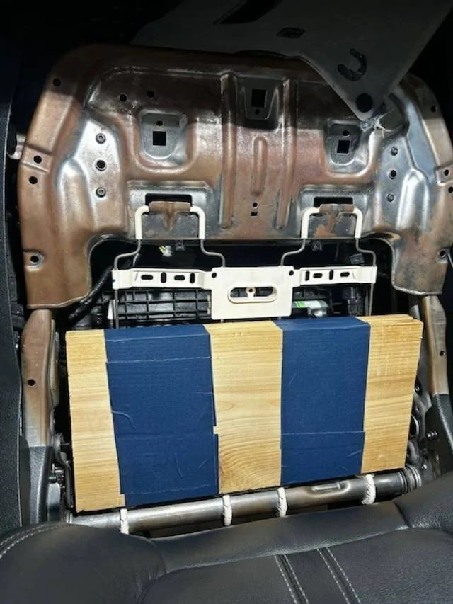

I added a 15 x 14 1/2 sheet of 1/4 in plywood and placed it on top of the rear frame bar - this basically eliminates the spring mat.
Now this gets the seat bottom level, but the cushion is compressed and have the seat bolsters pushing into my tailbone. - so, this idea is a BUST.

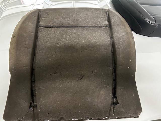

New Cushion - My roll the dice gamble was a WIN, it fits the cloth cover.
I now see why the Lariat cushion - has the extra pillow tops - on the top of the cushion itself.
It is for the Listing Rod / Hog Ring channels as this cushion does not have the extra channels and is more contoured in the back side of the cushion.
Note: The rear slope, this is my only issue with THIS cushion, it drops too low for me and I am like an old granny looking over the steering wheel.

So, I attempted to add foam etc under the cushion to raise it up and then found I can raise it but again it compresses the cushion, and you feel the seam ridges in the cover as well as the extra foam that was added trying to reshape the natural contour of the cushion. (Not Comfortable)
Where I am at now:
Removed the Cargo Straps I had installed and left the attach points of the cushion undone to make any cushion I install a - Quick Change.
Now I can swap the cushions around quickly and I can slave in the cushion (In-Work) for testing.

So being that, when I (1st) sit in the Ranger seat - Its perfect for about 10 seconds, after that the air is being expelled (pressed out of the cushion) and I am sunken down into it.
So - (On-Paper) this design works but add in a non-supportive, cushion that will not hold its shape when weight is applied to it - Greatly Enhances that bucket design.
That is MY ISSUE, it is not so much needing a dining room chair (sitting position) (fully flat and level) its I need to have a stronger support in the cushion to STOP the extra deflection into the floor or a figure out how to get the back of the base more of a level position and have the cushion perfectly match it.
I am truly amazed that this does not affect more than a select few owners.
But honestly after driving the Colorado and checking its Parts IPC, it has the spring mat design as well, so my thought is that this is just the way - ALL SEATS are now designed, and I have to live with it, and it depends and relies on how the cushion itself is designed on how well it supports.
I still MAY need to revisit the addition of webbing on the spring mat assembly, but I will address that if needed - just focused on the Cushion for now and see how that goes.

Update:
Still waiting on Upholstery Shop -Modification (He needs to get some HD Foam to complete the project) hopefully next week.
But in the meantime, it gives me time to try different options and pinpoint down exactly what is causing my pain.
Well so far, I have deduced it is a combination of the Seat Spring Mat (Downward Slope) and the density of the Seat Bottom Foam.
These 2 design issues create this for me:
1. Feeling like I am sitting in a (V) - (Tailbone in the center of the V) - This strains my low back and makes the tailbone sore as it is hitting to tops of the spring mat.
2. Add in both - (V) feeling Cushion (sinking) and the angle of the Spring Mat and I am not in a comfort height position (even with the seat fully up)
So, I added the Seat Jackers to the (Rear Legs - Full 3/4 in) - this takes care of the Height Issue (mostly)
But I still have the (V) feeling and strained back
I also made a NOTE than the rear support bar (Rotates) when the seat is raised or lowered, so this somewhat hampers any modification of adding webbing and securing it to that bar as I was thinking of adding a seat pan - Extension and eliminating the spring mat, I would have to create a way for support without attaching to the rear bar.
So, i decided to try this, being that I have tried all types of foam and rubber here with no help.
I wanted to try a more rigid base using scrap wood trim board from my house siding project.
Tried (1) board - better but still had (V) feeling
Doubled it up to equal (1 1/4) total thickness and now I have a non-sinking cushion
Board is cut 15" x 7 1/4"
Feels firm and solid, I still need to drive it for a long-term drive feel for comfort.
But I think I am at least getting it narrowed down
Note the amount the rear attach point of the spring mat - drops down (The Ledge)
Also note the bar where the plastic clips attach (This bar ROTATES) so you cannot attach anything to it. - The bar rotates inside of those dog ear attach points of the spring mat assembly.
If I had a wider board, I would have tried extending it all the way forward, to the front pan. But this pan also moves (with the Front-Tilt). So, I need to allow clearance for that.
I will try this and if I feel the drop off from the boards. I may have to tweak this somewhat and extend it farther forward.
Boards help get the seat base to a more level position from the OEM design and it flexes the spring mat (Uniformly) and (Evenly) - Eliminates the (V) feeling
So, it's just the matter of (if needed) adding a thin layer of foam over this to eliminate feeling the wood.
At least I have another avenue to go, if the Seat Cushion - Modification is a bust.
So, to sum it up - right now I have this board and the seat jackers on the rear legs, I may try pulling the jackers back out and see how that feels as well. But for now, I will try this setup and add some foam to hide the feeling of the wood (if needed)

Its not exactly perfect - yet, better than the OE (YES), I had a Upholstery guy cut out and add a firmer cushion, it made it better but not perfect so I have been slowly playing with adding layers of scrim on top of what he did.
I have determined the MAIN issue is in the design of the seat pan itself and the way they attach the seat spring assembly - the only real way to fix that is to redesign the seat pan, get something underneath the spring mat to catch it vs letting it sag.
I did try cargo straps for a bit but decided it needs a actual metal pan to stop (ALL) flex downwards.
For now it works, have gotten used to it and just live with it, I still have it as quick access change as I do not have it all the way installed.
Only have (1) front clip holding the cushion on the pan, and I do not have the hog rings back on it yet either - I will eventually get around to getting it back together, but been busy - Last Room of the upstairs to remodel (Kitchen)

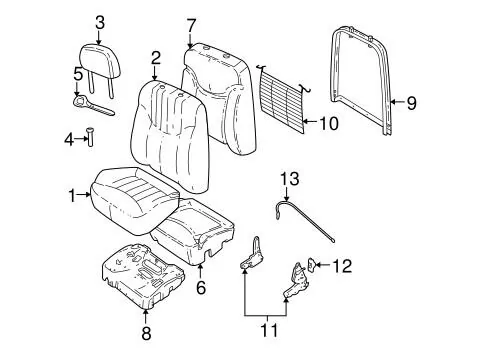

Something like this - an actual pan, eliminate the springs or give the springs support under them so they will not sag downwards.
This IPC is from my last vehicle which I drove for 15 years, Note Item #8 is the seat pan, the cushion itself provided all the needed support, the Ranger has a combination of a cushion and spring , I tried the cargo straps (x2) and interweaved them in the springs, you feel the straps.
The main issue is that the center of the spring mat inherently forms a V when you sit in the seat, so your tailbone always sits lower than your but cheeks. that is what I have found to be MY ISSUE with comfort.
Its hard to explain unless you actually open it up and place you hand on the springs.
Example: If you were to place your hand on the RH Side of the spring mat - it creates a slope downwards on the RH side - so if you picture you sitting in the seat, now you are sitting sideways (Uneven - Unlevel), this strains the back, so in a turn (roundabout) when your body weight shifts it feels like you are sitting on a uneven seat.
