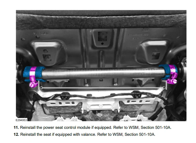

Hello everyone, first time poster long time lurker. My question is on the 2019 Ranger with power seats, how hard is it to get to the foam/cushion for replacement? I'm the second owner of the Ranger and I have always found the driver seat VERY uncomfortable. When I am driving my right leg starts to hurt, I can actually feel the metal or something pushing on the back of my thigh. My guess is that there is either a wire from the power seats/heated seats that got flipped up out of place, or the padding is shot. At the very least I would like to get in there and take a look to see if I can do something. Does anyone know if I start unplugging things under there or if I remove the seat, will it throw any codes or warnings when I reinstall? Any direction, suggestions, information would be awesome. The other thing I would like to get at in there is a set of backets. The seat when you are getting in/out slides side to side a little bit and it annoys me to no end! As a side note, the passenger seat feels completely fine, and doesn't slide side to side at all.

For getting at the foam the factory seat cover should have clip under the seat. Undo those and you can peel the cover off and access the foam cushion. As for the seat moving side to side google FORD TSB 20-2171 . They will clamp a section of hose to the seat pivot. I had the same problem with mine.

Thats exactly where mine slides side to side! I never thought about a piece of hose and a clamp, I can do that myself tonight! As for the clips to get the cover off, do I need to pull the seat to do it? Or can I get it while its bolted in? Will the heated/power seats have anything I shoudl watch for while I am take it apart? Or just kinda watch as you go and all is good? Thank you for the info! Sorry for all the questions, first "newer" vehicle I owned, so I would really hate to damage anything :p

This has got to be the single most hillbilly engineered solution from the manufacturer I have ever seen...

There was a TSB at least as early as 2018 referencing vehicles going back to 2013. What have they changed since 2018? Well, they have updated the TSB at least as recently as July 2021 (TSB 21-2236) to cover the vehicles they built after the TSB. :facepalm:

It works though i did the TSB myself with some hose and clamps took care of the issue and took 5 minutes to do
