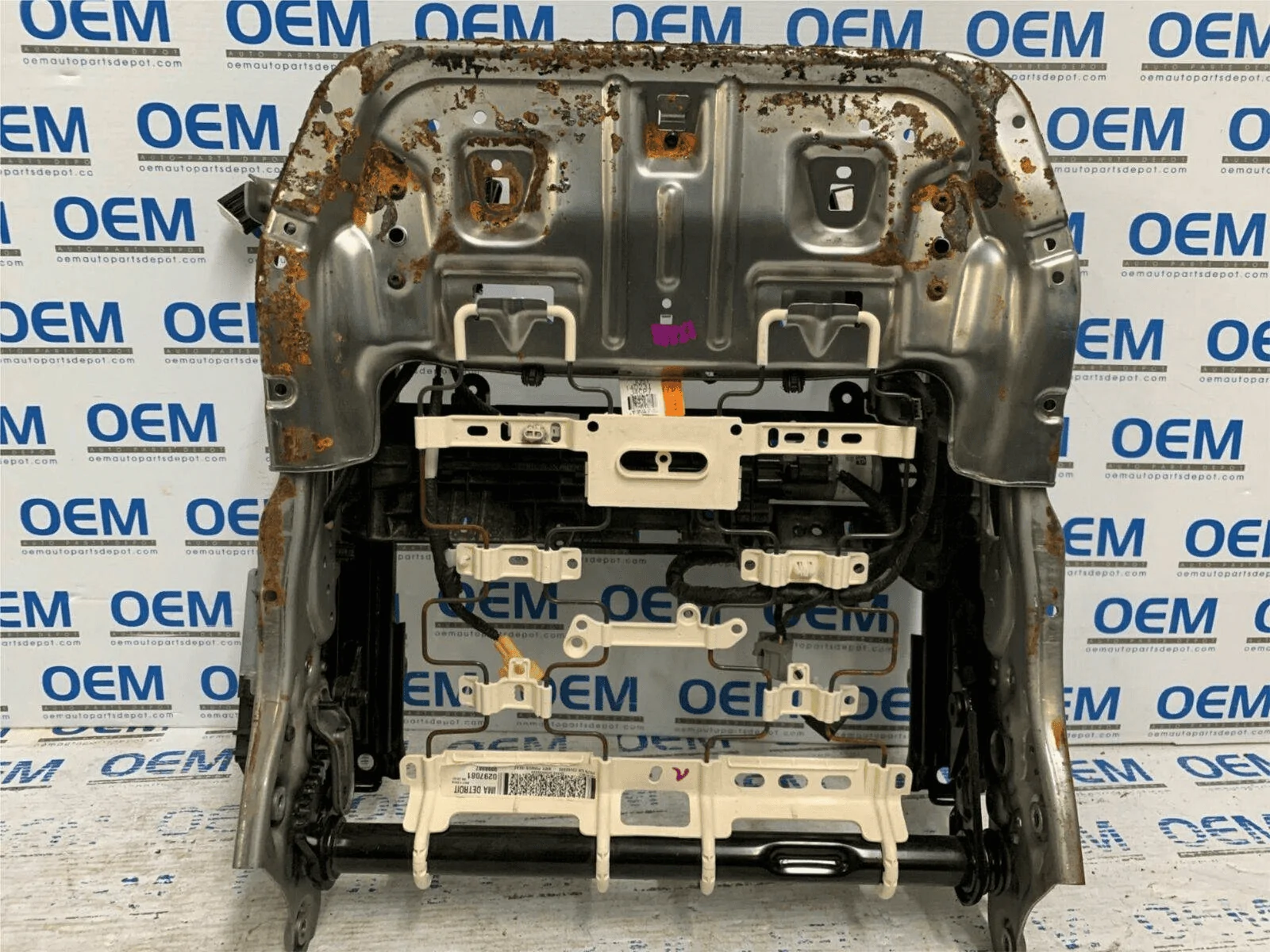

As far as the lean - I have some theories on what it is.
1. Seat Cushion - Itself
2. Spring Mat - Uneven Tension
3. Seat base bent.
Uneven spring mat tension - meaning that one side of the spring mat is a different length than the other.
Like if you focus on the (2) U-Shaped hooks - they would be uneven. This MAY give a leaning feel to the cushion.

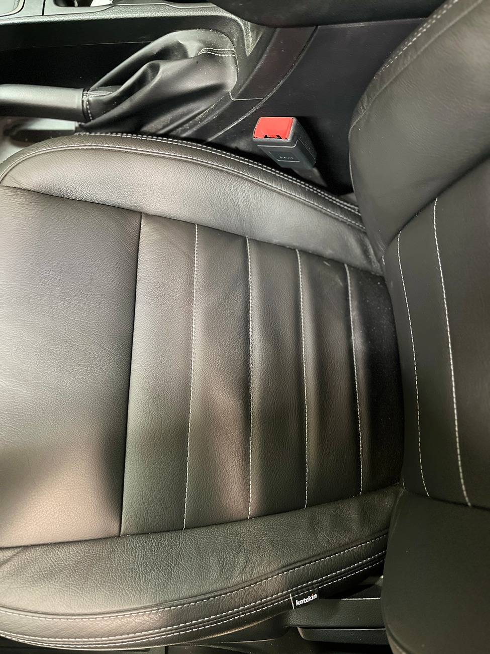

Last fall I did the Katzkin leather upgrade. A big 2-day job.
I had the leather in the hot sun and used steam to install.
What I've noticed is, the cloth never had signs of what you have shown.
After the vacation in June and 4k miles i noticed this on the lower seat cushion of the driver's side. The passenger side my wife sat in didn't show as much of the wrinkles.
I weigh around 215 lbs. The Katzkins' are thicker leather than factory.
The bar the hog rings attached to along the sides of the seat cushion at the ends were not the best, fragile.
I also have the seat heaters.
I've attached a photo of the leather as of now.
What bothers me is that I never saw this on the cloth.
I am going to remove lower cushions an add 1/2" foam across entire bottom area.
I'm not sure if this helps but it shows that it happens to different leather on the seats. The back seat shows no sign of this but not used much.
