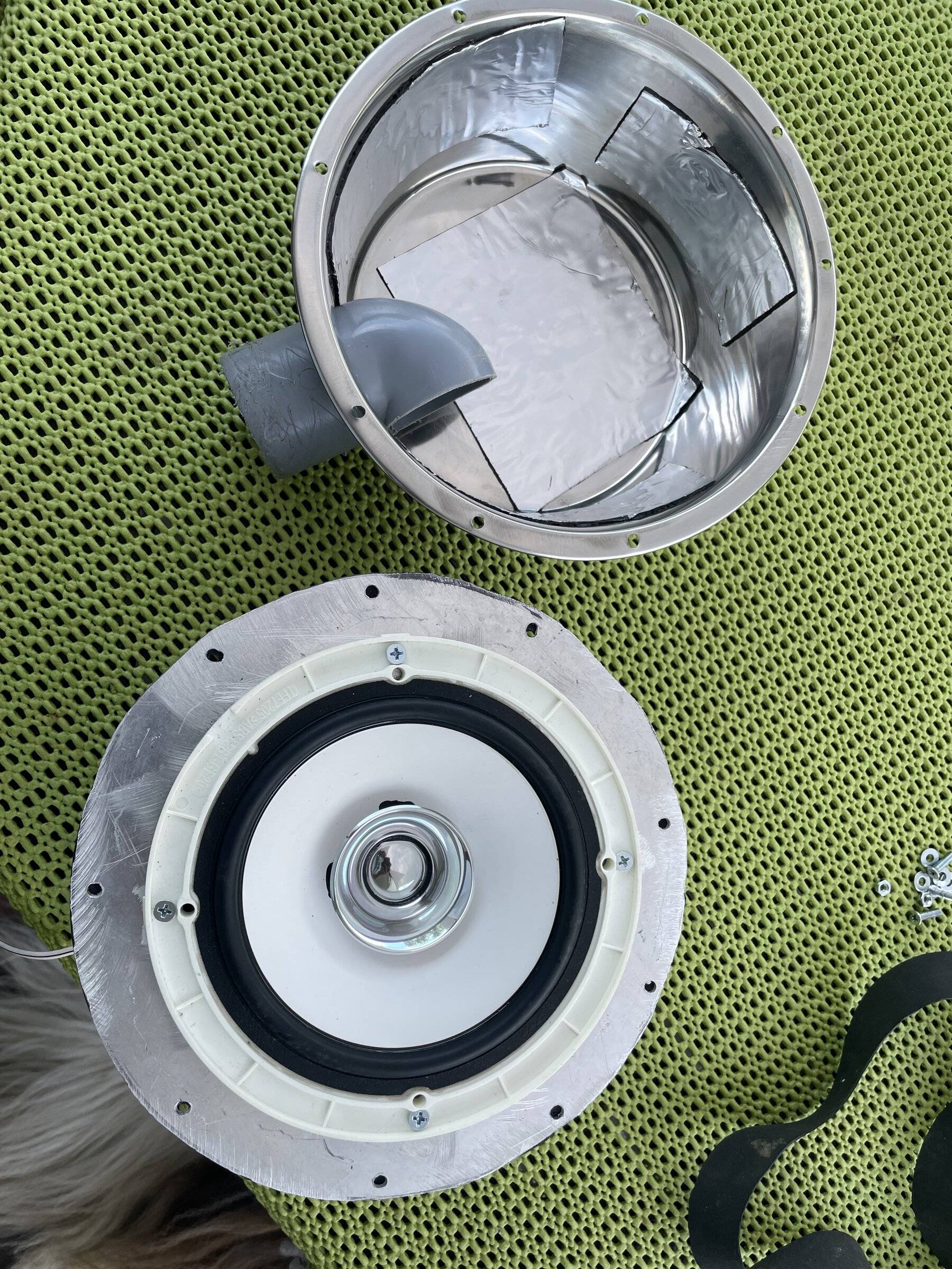

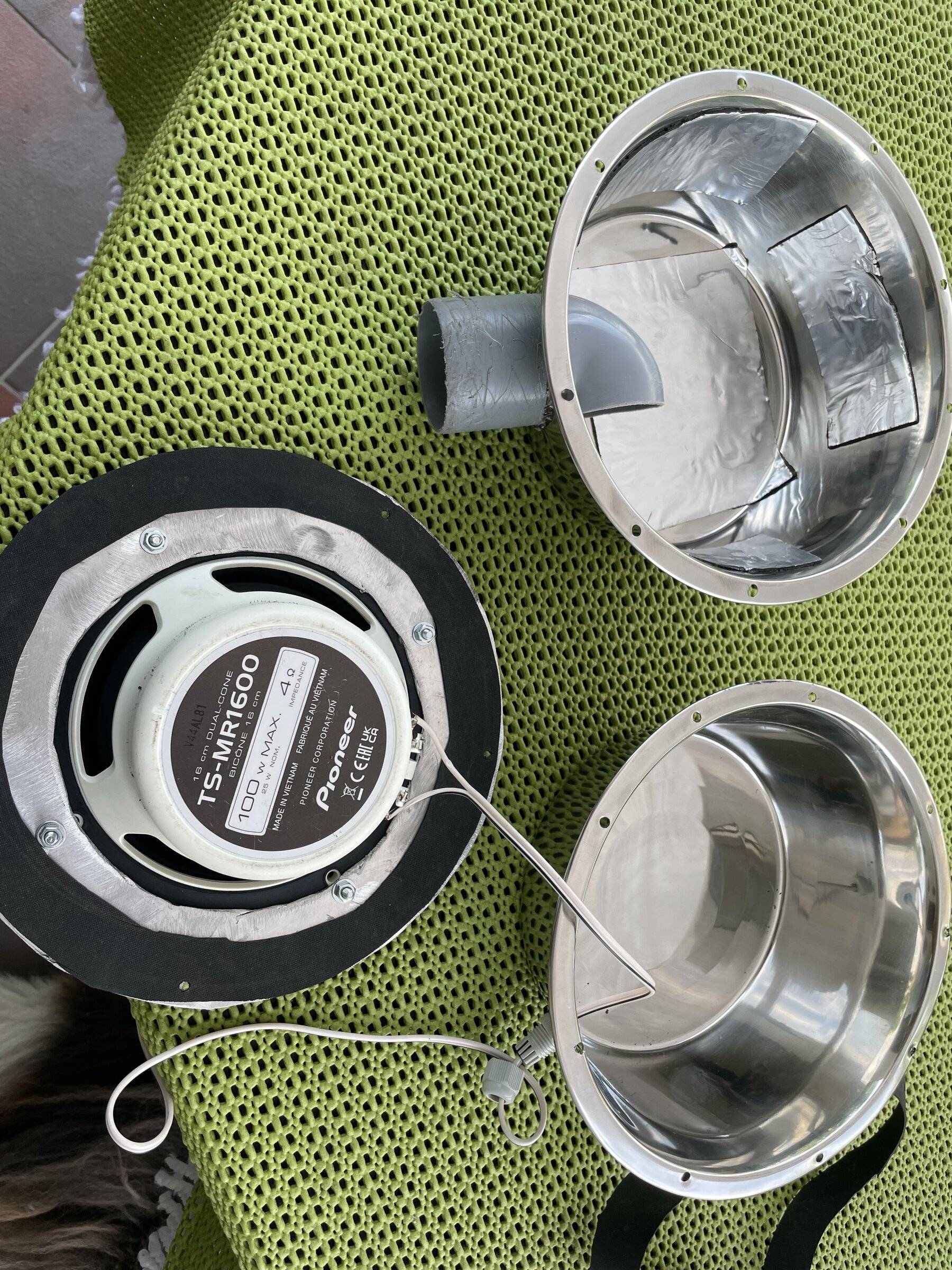

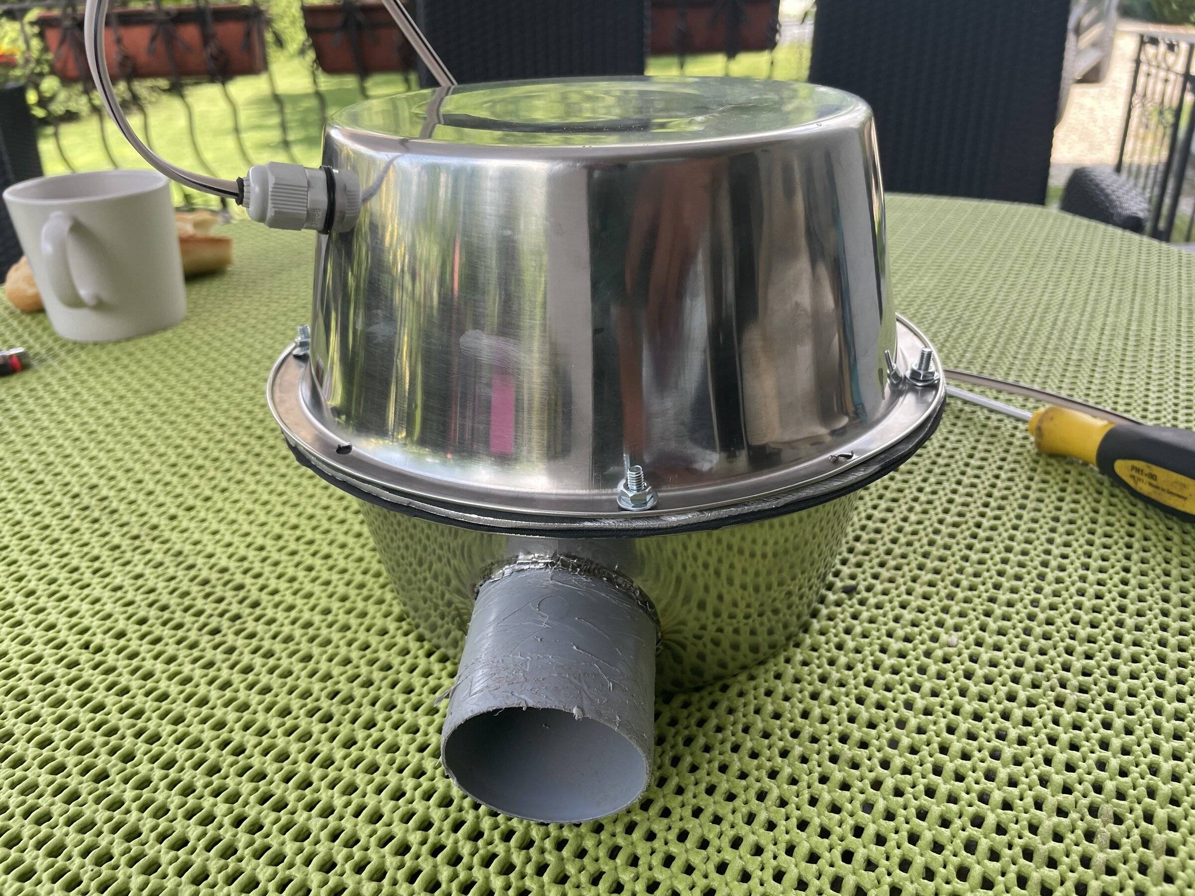

I have limited time to spend on this one, and I do things in a hurry. However, I’ve made some progress on the prototype. Two dog pots, stainless, aluminium baffle. The port was supposed to be welded on, as I do not have a TIG welder (yet) I burned thgough easily :(. For now it’s a plumbing pipe. Actually it’s better that way, I can tune it. It sounds decent/well given the sound is 8bit only and without a DAC. The speaker is nothing fancy, however it’s marine line.
Anyway I need to work on the samples more. My plan is to progress in parallel in every aspect: build/electronics/coding.
Now I need to make a good power supply for the Arduino.

Hello again! I hope everybody is doing fine, it's been a while since I've last posted on the forum. It's been some busy (crazy) times for my family and me, since.
The project is not yet in the scrap bin. I've been changing quite a lot:
1) ESP32 instead of Arduino, dual core processing: one processes sound and one the handles the ELM327 communication;
2) Yes, RPM is read via an ELM327. I've been going through a few devices, until finally settled for the Vgate iCar Pro;
3) I've been searching for a lot of sound samples that were clean recordings without background noise - very difficult to find.
Issues I still have:
1) Tuning the sound - obviously;
2) Sorting out the delay in RPM reading from the ELM327 - it's not always present. Baud rate and protocol are already at maximum speed vs. stability;
3) Finding the right amplified that can deliver the output at higher rpm, right now there is a big imbalance between the idle sound and the revving sound, where the engine is completely outpowering the output.
4) The fact I could not yet let go of this project ;).
I am not running this setup while driving! It's still an experimental project that only runs in my yard.
Don't laugh on the name of the samples, as they suggest some really powerful and some exclusive vehicles :). It's just what I could found in my searches.
