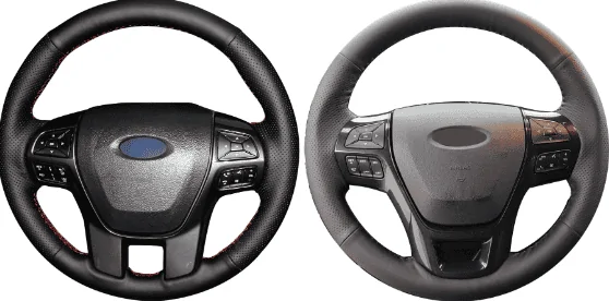

Would it have been possible to simply use the Explorer wheel and assign what’s what in forscan?
perhaps the gen6 wheel will fit our gen5’s?

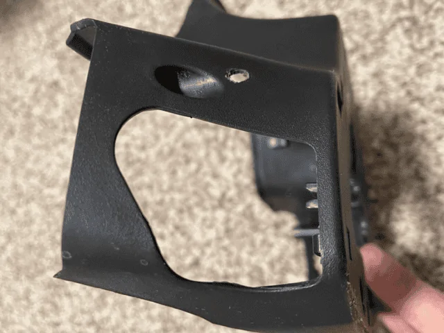

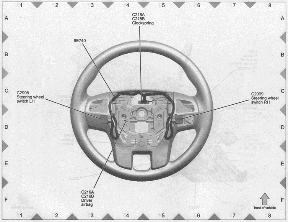

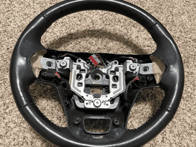

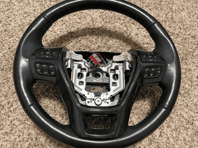

I think it would work... but you'd need the wheel and the airbag which would't be cheap. I think I paid $80-100 for a wheel minus the airbag just to rob the paddle shifters from.

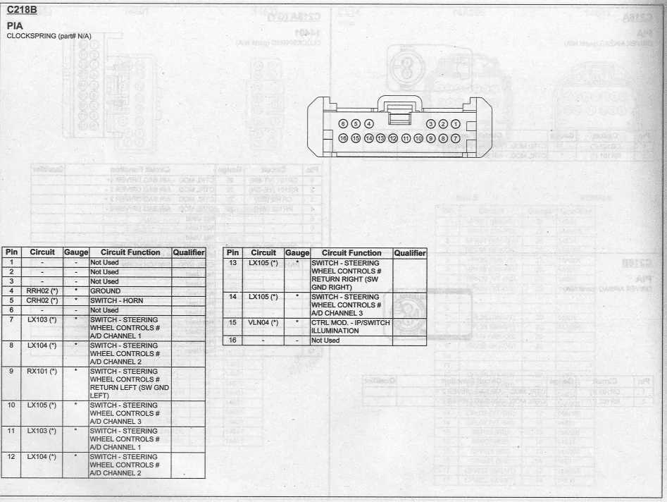

Ranger vs Explorer wheel. Buttons are the same but the bottom of the wheel and the airbag differ:
