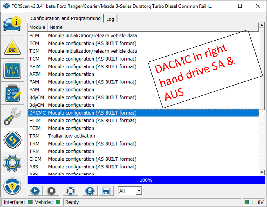

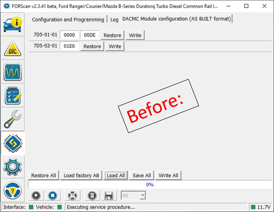

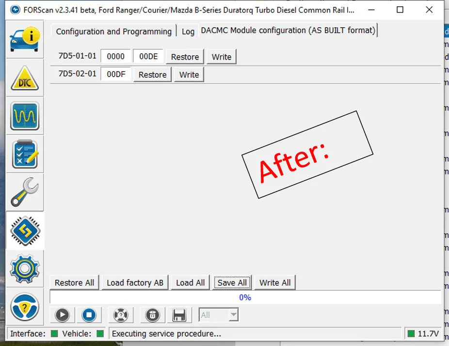

So I *think* I’ve found the answer to disabling ESE on my Wildtrak. My vehicle uses the DACMC module for ESE, not the ACM. This has only two addresses and by changing 7D5-01-02 from x1xx to x0xx it seems to have disabled ESE.
ESE was barely audible when I was using the internal amplifier as the source into my MiniDSP 2x8, but annoyingly audible when using line out from the HU. As I don’t drive this vehicle much I’d left it on amplified output until I had more time to look into it, but will now have more time to use it for surfing and downhill mountain biking. Of course, it’s an improvement using variable line out with ESE disabled.
I had been communicating with the FORscan team about this, and they’re both responsive and helpful (I have a paid licence and would encourage everyone to do so to support the ongoing development and support of the product). They also picked up that the ESE on my model is in the DACMC and are adding it as selectable within this module.
This worked for me, thanks, I used this as my starting point.
Just an edit on the DACMC it is 75D-02-01 and changing as per above makes the code 00DF.
Works a treat, I see only SA and Aus suffer as we don't have the ACM module.
See attached.
