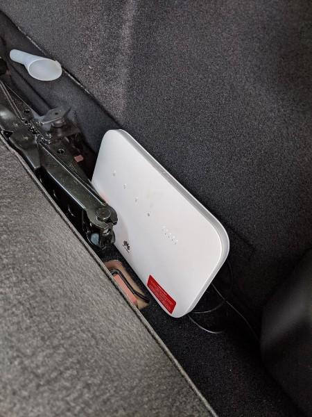

Here is the router behind the seat:

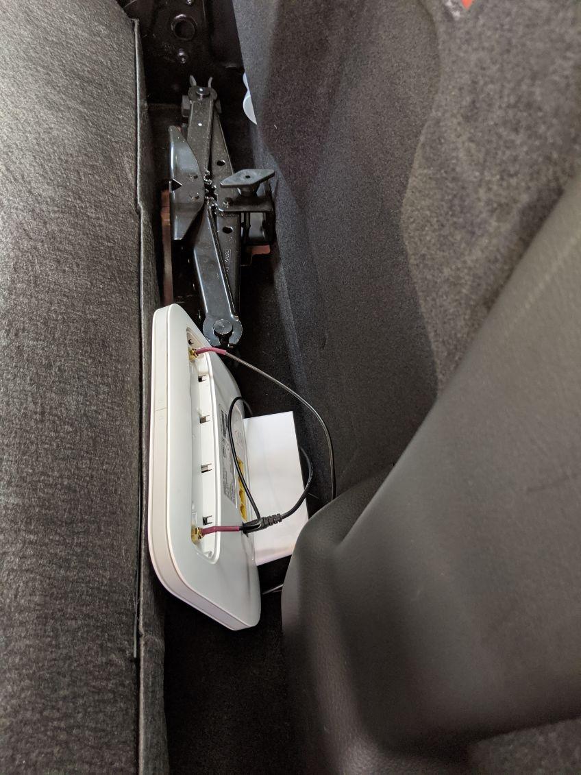

It supports dual antennas:

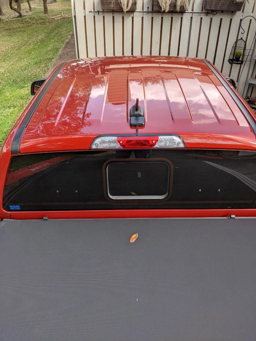

Antenna installation:

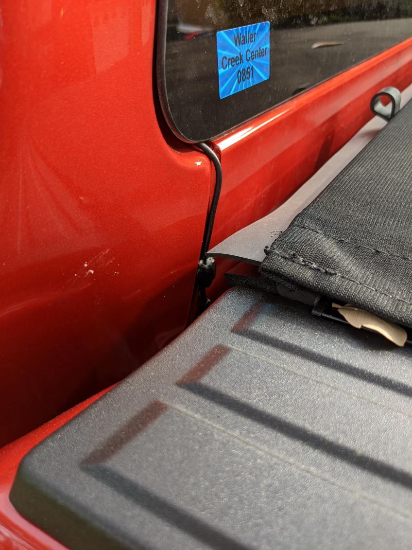

Fed around the center brake light, in the rear window channel and then down the seams for the cab. I used a small bead of butyl rubber around the top of the center brake light housing and a small dab on each side of the back of the cab to old the wire down:
Once behind the cab, I fished each of the two antenna cables in though the vents behind the back seat. Pulled a power line; hooked it up and it works like a champ!
