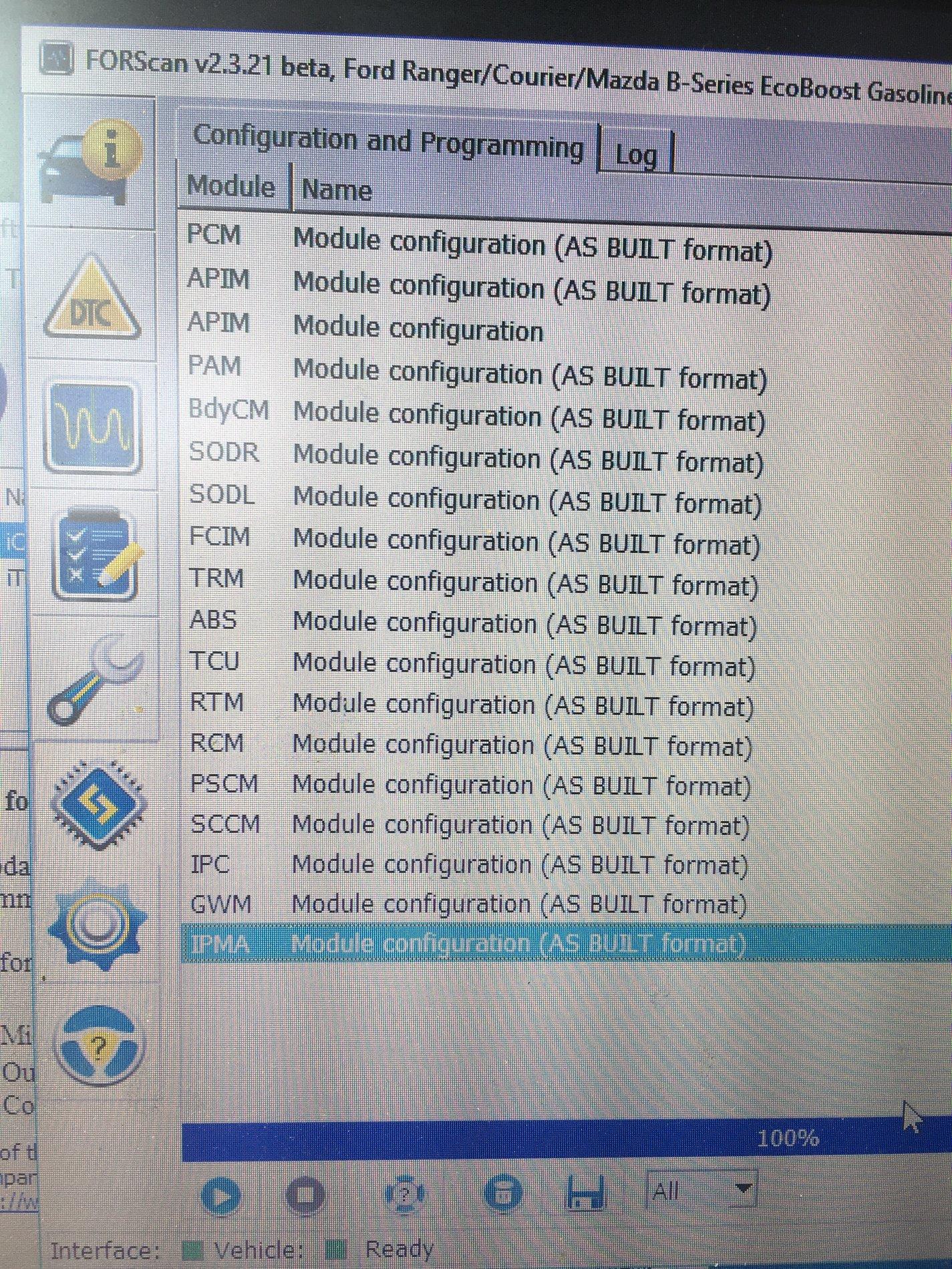

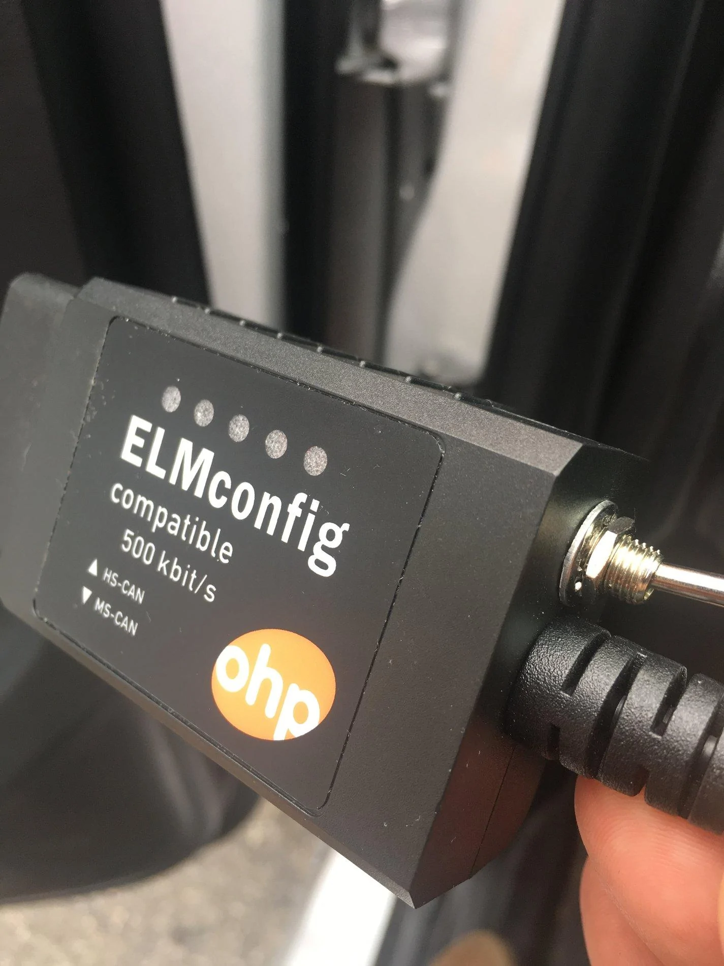

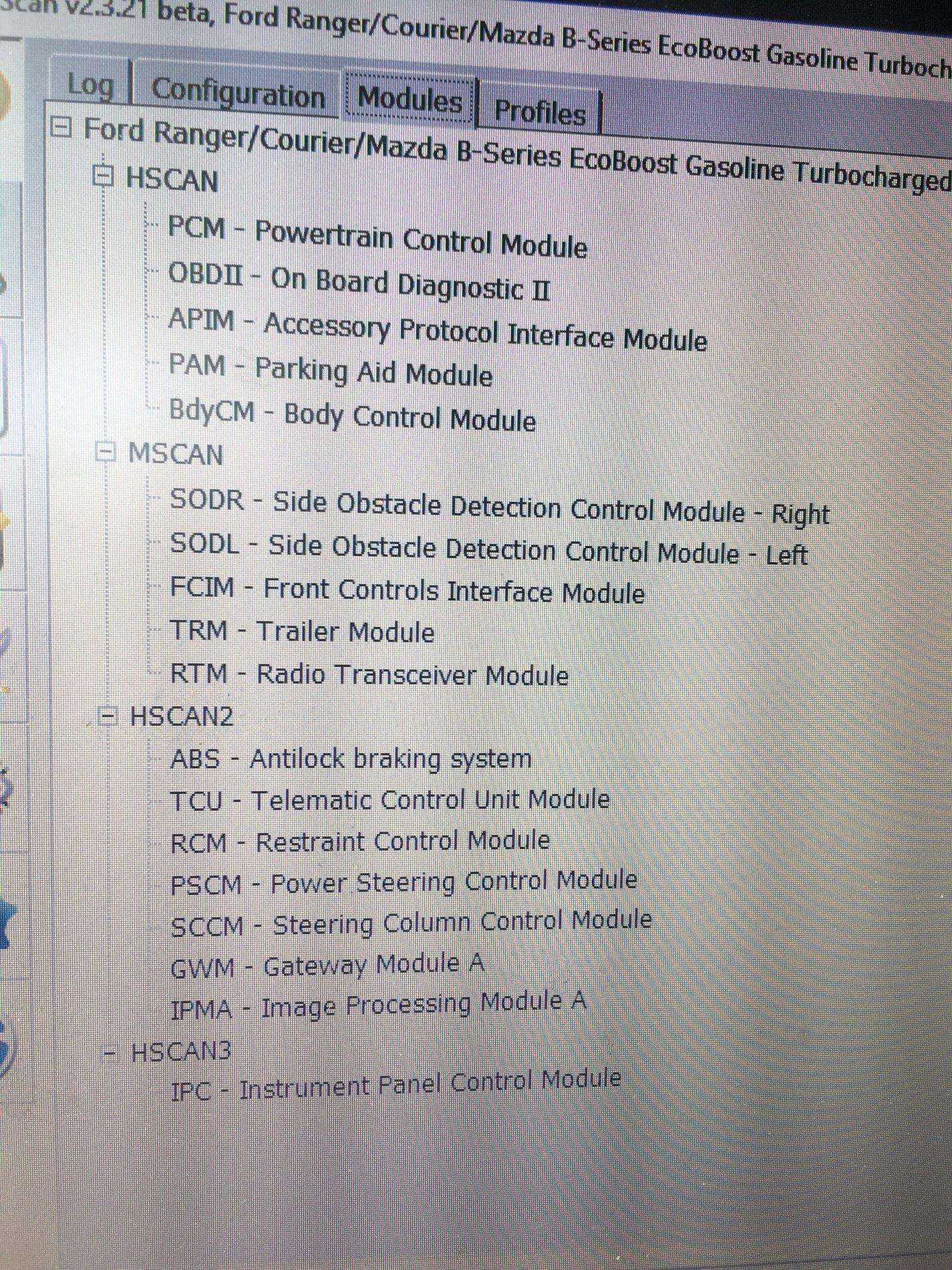

I was going to give this a go but the ACM module is not found on my truck. I have the ELMconfig OHP connector. See pics. It finds both HS and MS modules but not ACM.

No ACM on my Lariat either.
FORScan Lite and the OBDLink MX+ show the same modules/busses as you posted (if I decide to start modifying vehicle behavior I'll get the ELMconfig OHP but this little MX+ BT reader has been rock solid so far). I wonder if fake noise may be in the APIM unit?

Oh weird. I didn't check to see if I have the ACM module yet but I do have the as built data containing the 727-01-01. I will have to see where that lives. It may have been moved into a different module.
