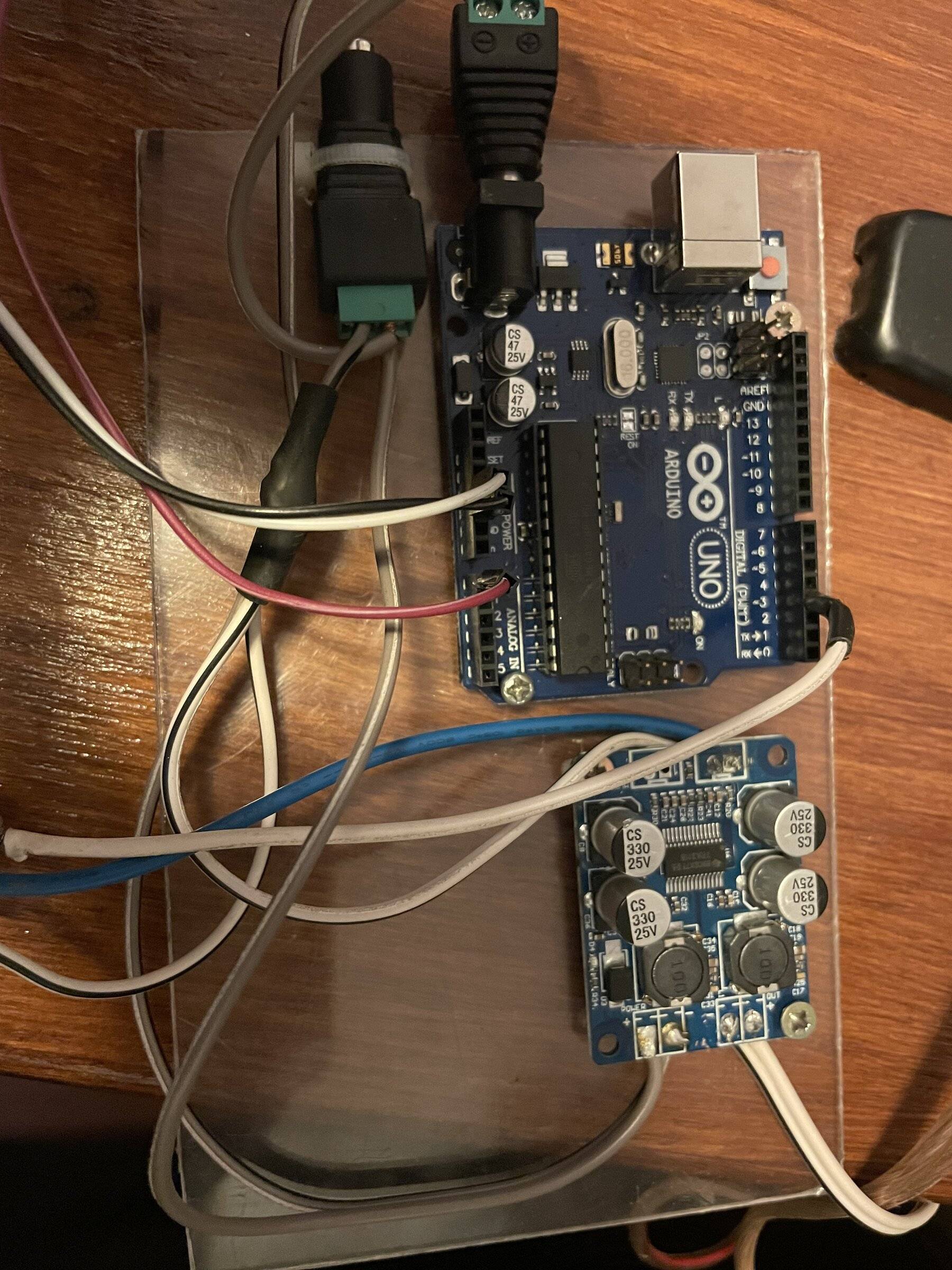

Meanwhile I am busy with the project. For now I have a mockup, very simple, with a microcontroller that replicates some exhaust sound on a piezo speaker. It's just a test.

Thank you! I should post a recording from inside the cab winter time. However, your reply gives confidence in case I will not succeed. Idle sound is easy … revving is also easy, making it sound ok on throttle deload is tough! Anyway, I am engaged in this project regardless of the outcome. As said in the beginning, for me it’s always the path.

I am looking to start a project to add a fake exhaust tone to my truck. I know … I can’t believe I am actually doing this as a purist gearhead myself, yet audis and maserattis have it too.
There is nothing I can do to my small diesel as it has a cat and a DPF with an aftermarket exhaust that would still be compliant in Europe.
I can buy off the shelf systems like Maxhaust that connect to the OBD port to read the RPM, yet I want to build one myself with an arduino, an amplifier and a ported box speaker enclosure.
I need a simple way to read RPM without CAN decoding or … to read the throttle, and I am looking for ideas.
The pedal is a potentiometer, I guess I can read the voltage or resistance, either would work. Any thoughts in this?
The fake noise will be outside, not inside.
