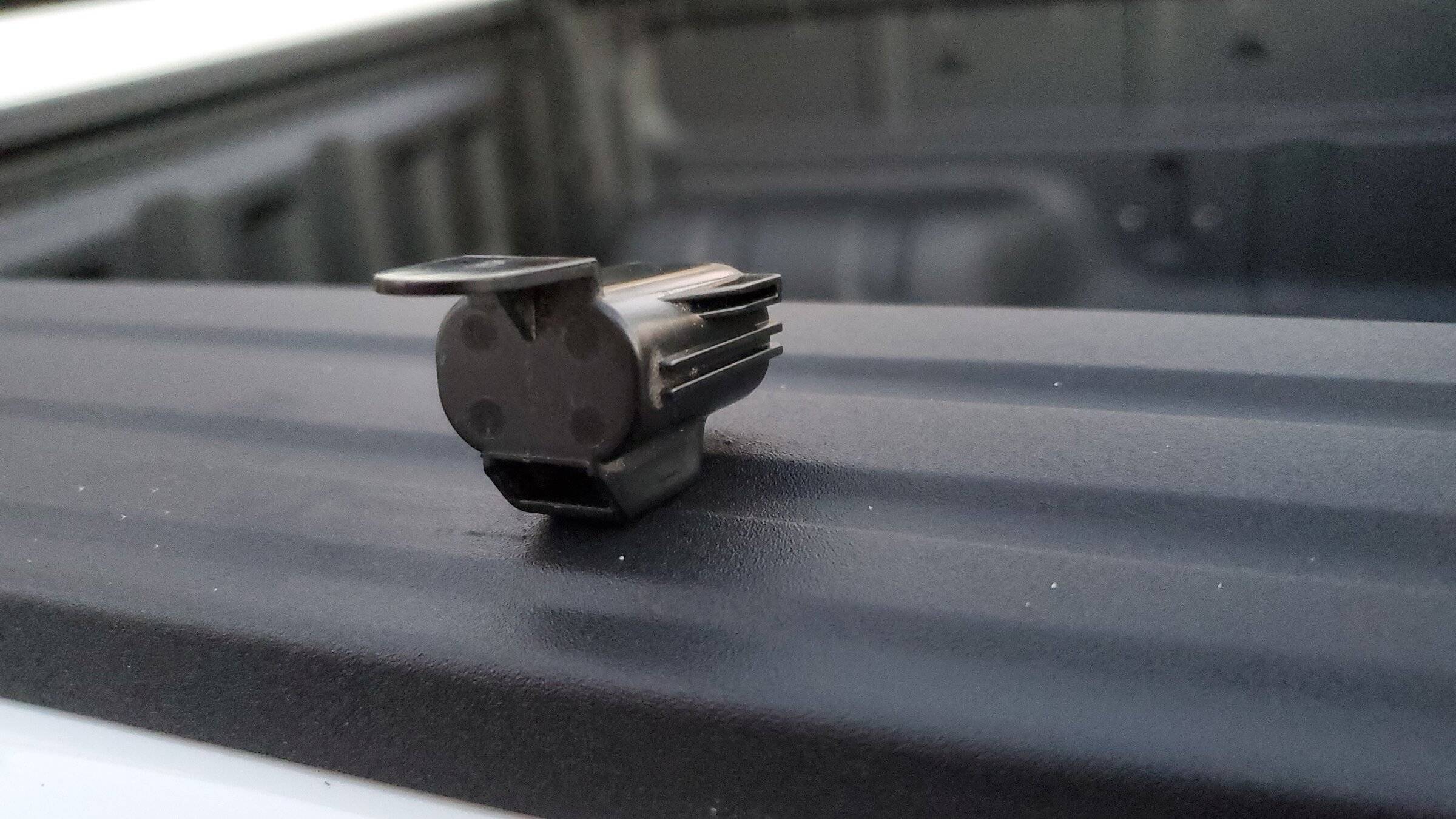

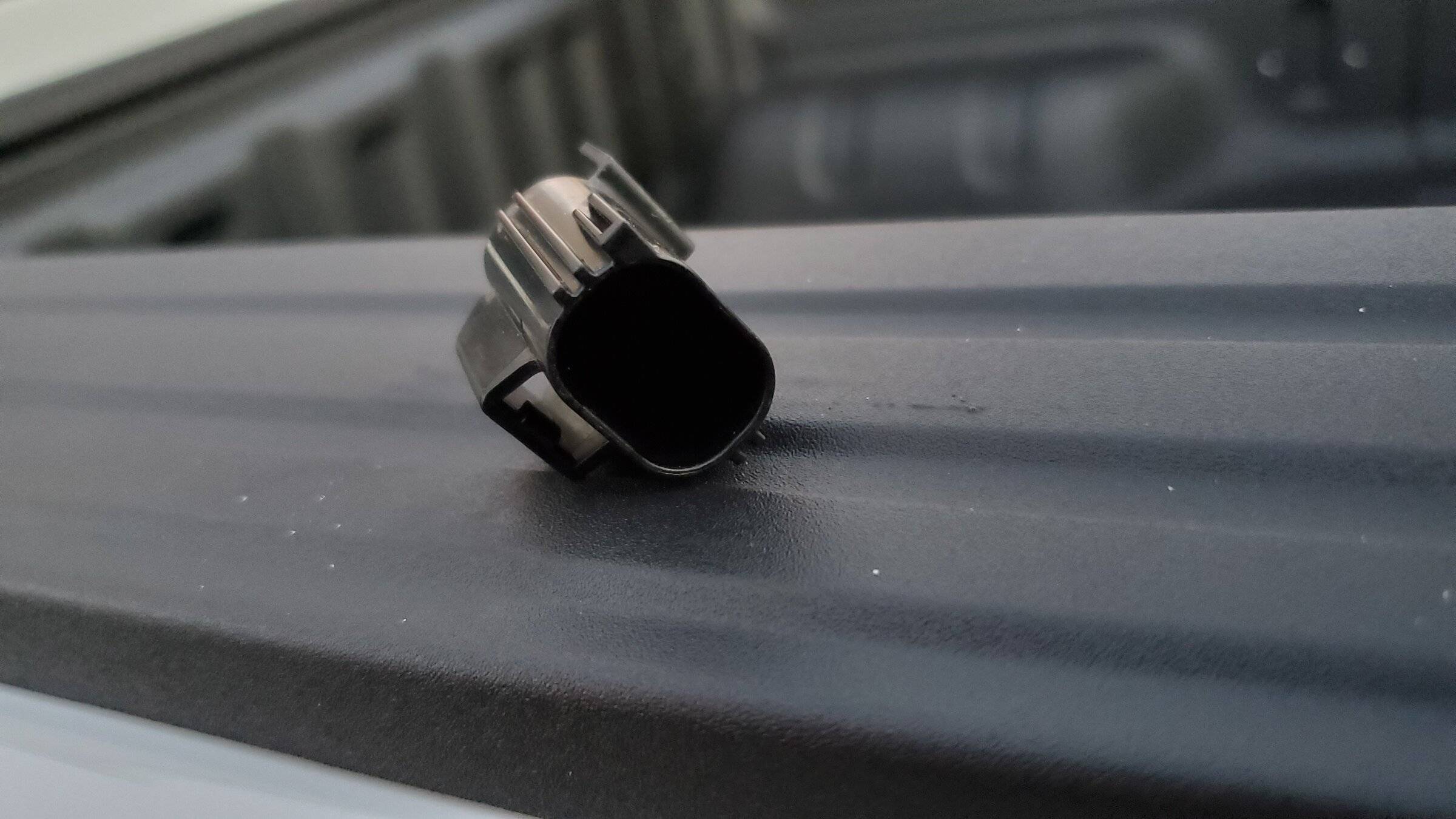

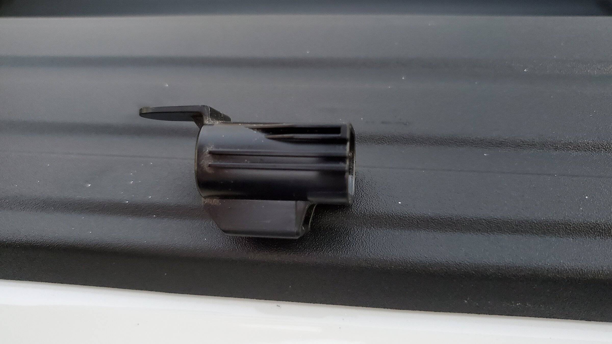

So I was planning on converting the dummy plug with silicone inserts into a working plug for some bed lights as I've seen others here do and unfortunately it looks like Ford has changed the dummy plug.
All I have is a hollow shell. ( See attached pics)
Anyway I'm I'm not paying the $35-40 that the specific Ford pigtail for this location is going for these days nor do I wish to pay a similar amount for the wolfhaus version that currently has an unknown lead time.
I'm fairly certain Ford wouldn't design a new plug for that application, but just picked an off the shelf 2 pin male and female..... Has anyone else figured out other part numbers, or industry standard plugs that work? Ideally I still want to avoid cutting into factory wires on a brand new truck.

It's likely used from another Ford harness. Either way I would say just spend the money. It's a small price to pay and you don't have to worry about the quality of it. A lot of those cheaper harnesses you find on ebay corrode or the pins are loose, etc. Not worth the headaches and time just to save maybe $15
Agreed. I thought the wolfhaus option with the extra lead was a no brainer. Nice quality, OEM-like bed power port and the guy doing them is great to deal with as well. If I was to do it again I certainly wouldn't hesitate and would wait for availability if that was an issue. I wouldn't bother wasting my time trying to cut corners, but that's just me.

Wound up finding a motorcraft pigtail for $15 on ebay, should be here Tuesday along with my week late BAKflip MX4 ( Thanks FedEx for sending it to CA instead of AL )
So factory plug at a reasonable price. $30 for a pigtail is insane and you're better off cutting the factory wires at that point
