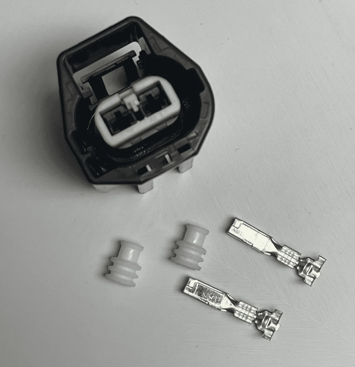

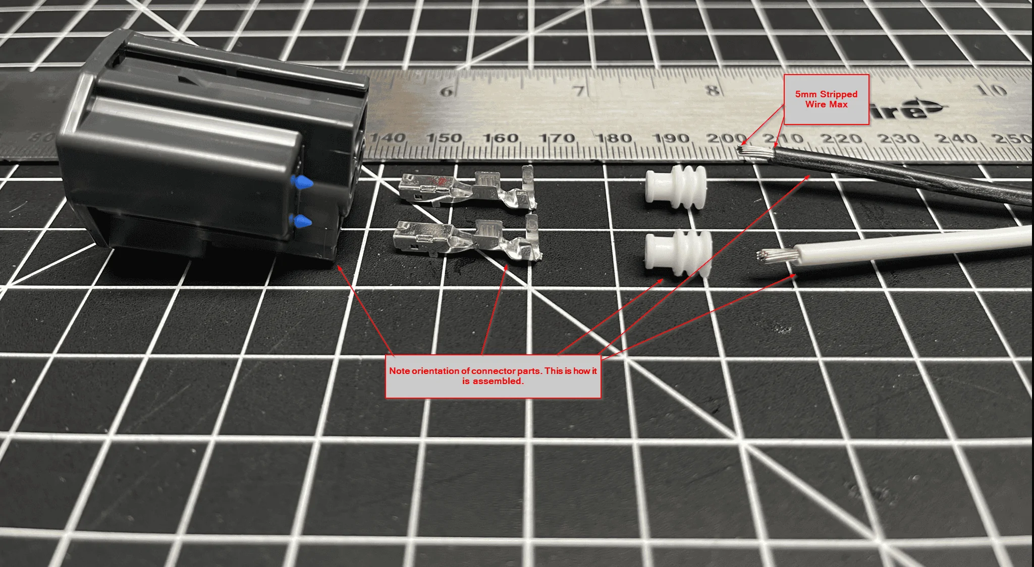

And FINALY, I have a bunch of the FEMALE connector kits available. This is the OEM side connector that's mounted to the frame of the truck. So if you want to do your own direct battery wiring, you can get that connector, some wire and a fuse, and DIY it to my current kit.

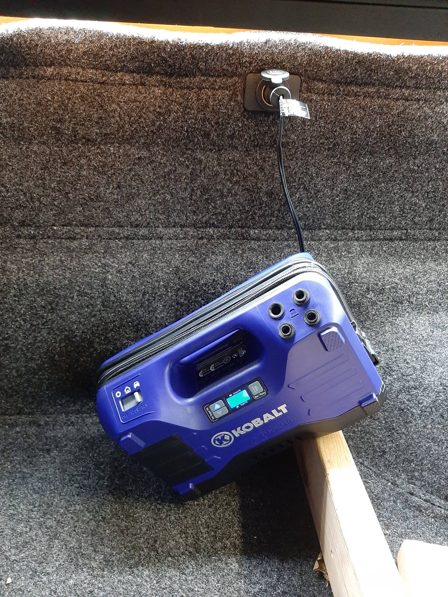

Instslled my outlet from G5RP today. The hardest (and scariest) part was cutting the hole in my Bedrug bedliner to fit around the outlet. I think it looks pretty good IMHO.

Thanks! I started out just cutting a hole the same dimensions as the opening in the bed side. However, the outlet would not clamp on due to the thickness of the liner. I then cut the opening a little wider all the way around. I stopped cutting at a very snug fit around the outlet.
Great tip! I was going to try to sandwich it but now I know better, thanks to you. =)
