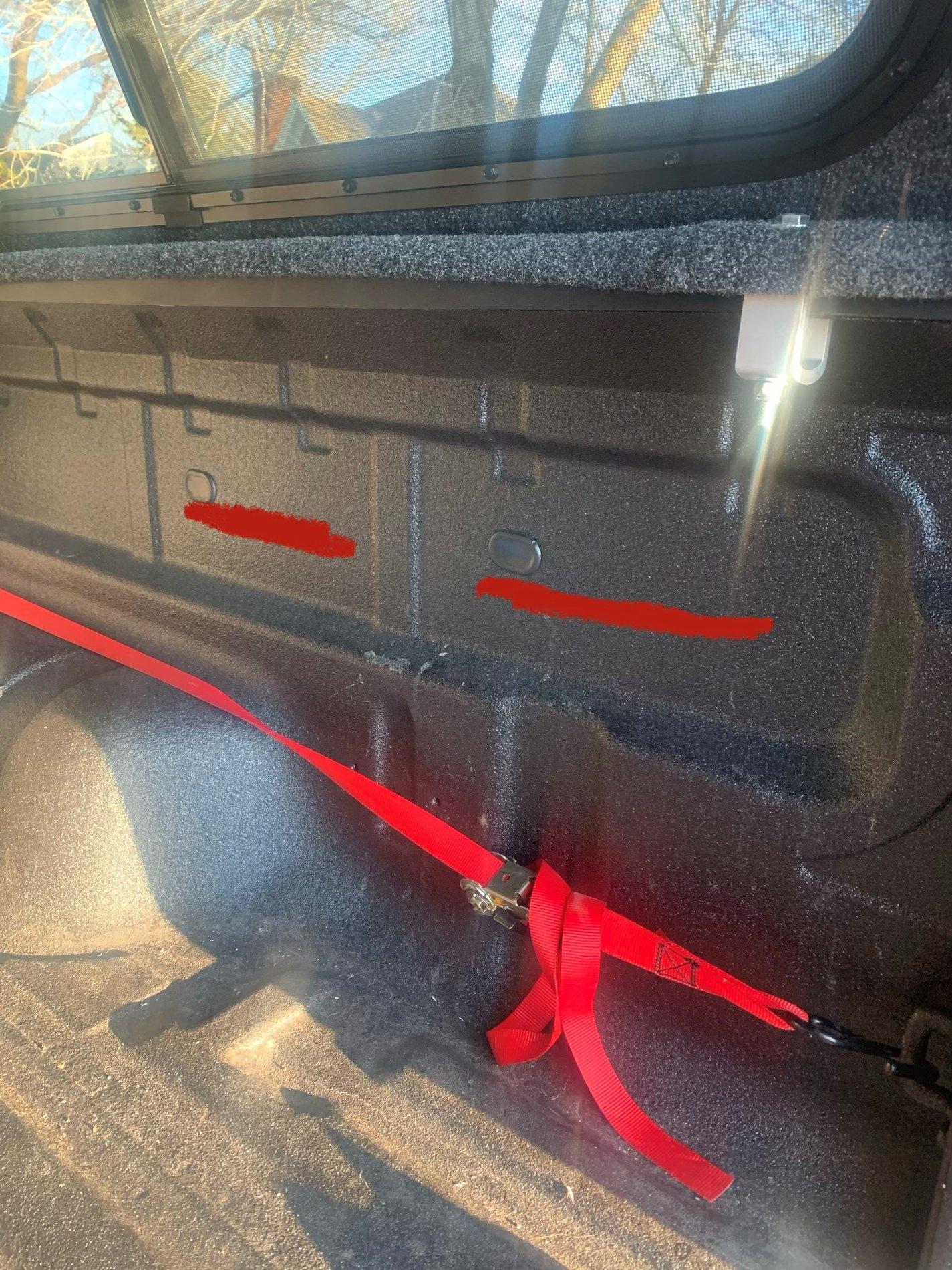

As long as your just attaching items such as the shovel shown, no worries.
I believe the initial concern was that you would be strapping cargo, lets say... something like hauling home a kitchen refrigerator, and strapping it down to the sheet metal wall of the bed, via a small rivnut. That would be scary.
My concern would be any corrosion starting points from exposing the metal of the bed. If you wet installed/sealed/painted the holes drilled then it should be fine. Especially since the bed on this truck is steel and not aluminum or composite.

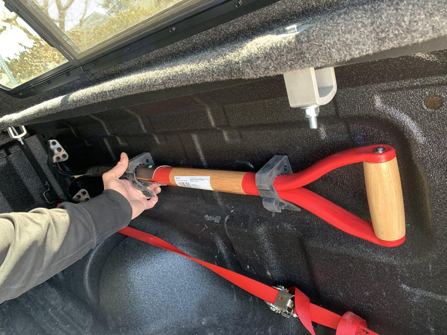

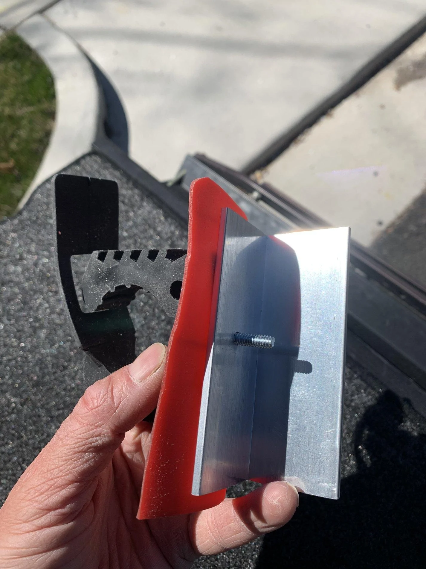

Well, you told me not to, but I did it anyway. If this fails in the long run, I'll at least be happy to have this serve as a clear warning to others. Anyway, in the end, I decided to mount the QuickFists straight into the bed using JackNuts. This option was chosen for two reasons: 1) I couldn't easily remove the splash guard thanks to a few steel rivets that i didnt want to dill out and 2) I could never figure out how to connect the L-track to QuickFist. So here you have it: A few progress pics and the final product.
I think this was the best option. also, if you ever sell the truck or remove those mounts, just throw a little black paint over them and you'd never know they're there. BUT, you might end up wanting to put a washer on the screw side of the quick fist, looks like that phillips head could pull through the rubber. I know the last time I used these they came with little black plastic square washers that fit perfectly into the recessed area.
Sorry to bring this back to life after all this time, just curious as to how the rivnuts are holding up? Looking to do a shovel/axe mount in my bed and was thinking of doing this exact thing.

As far as I can tell, the rivnuts are holding up just fine. And the combination with the quickfists has made for a very secure shovel mount that can still be accessed easily. I should note that I do live in the great basin, and automotive rust/corrosion (my main concern in the long run) is far less of a factor than in coastal regions. But, if I were to do it over again, I would have done a few things differently to try and reduce that risk even more. Someone suggested to wet-drill the pilot holes, and I think thats a great idea. Plus, I definitely scraped the crap out of the metal when removing the factory bed liner from around the holes.... not sure how I could have done that any better, but be careful and try to do it as cleanly as possible if thats in your future. I did use some nail polish to try to seal things back up before the final install, but who knows how much that will really help. Good luck!
