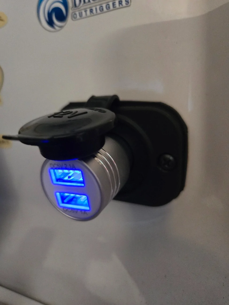

I went to my local Marine supply store and purchased a 12V Cig. outlet. Ran a wire straignt from the battery to the bed (added a fuse) and it works great at low cost. Plug for USB is marine quality also. The Gen6 Ranger has a 12V AND the 120V plug in the bed. Who thought it was a good idea to put the 120V plug in the back of the center console:crazy:

If you're asking me, I used the 15a class PowerPole (also fits the 20a kit, etc), and compatible wiring. Don't recall what the Ford wiring harness is rated for. So, I'd say 15 amps, maybe a little more for short duration. You can use the PP connector, or wire it to a 12v round socket, etc.
If you look in the background you can see that I wired and installed a second outlet in the forward hole.
