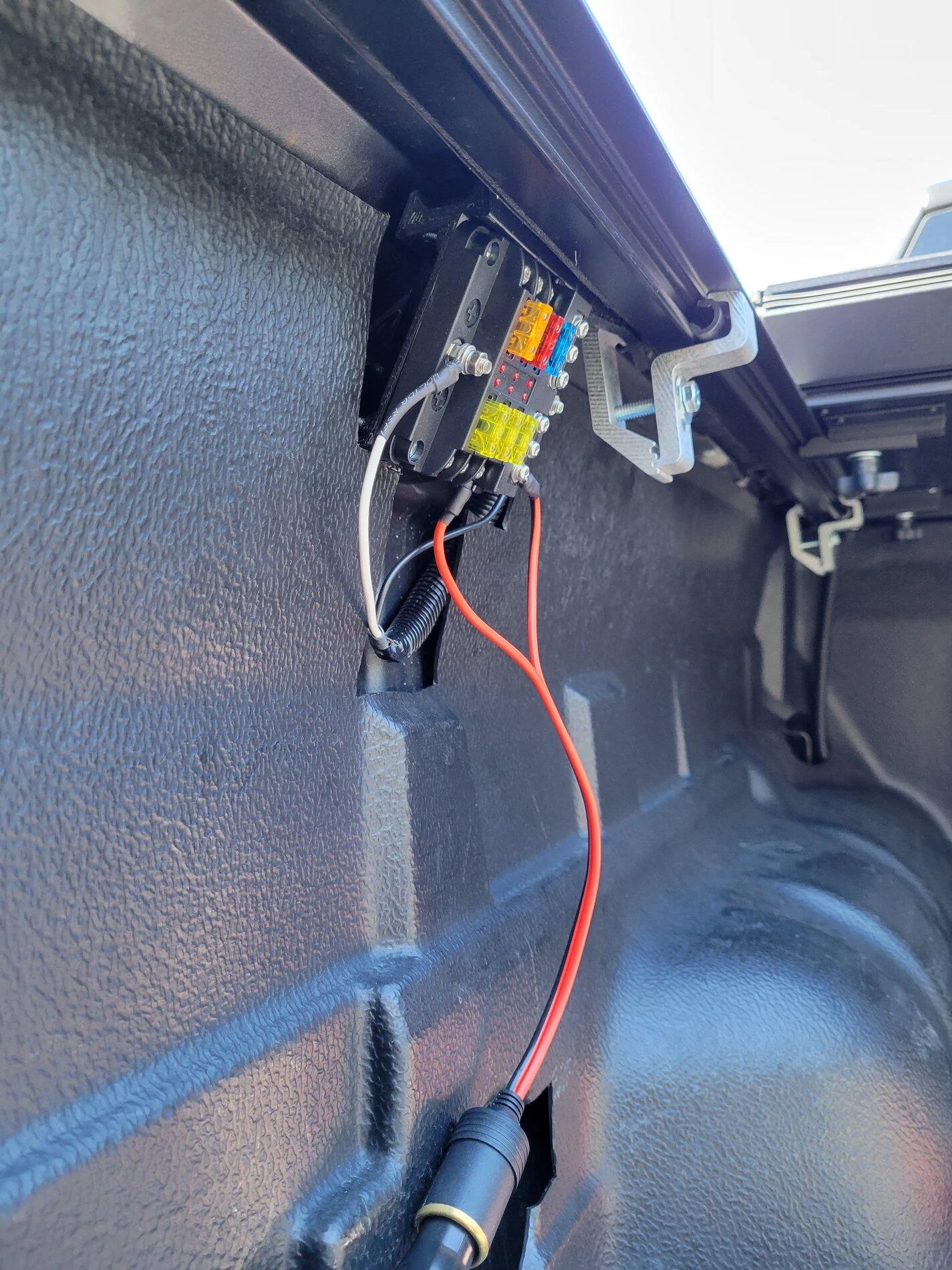

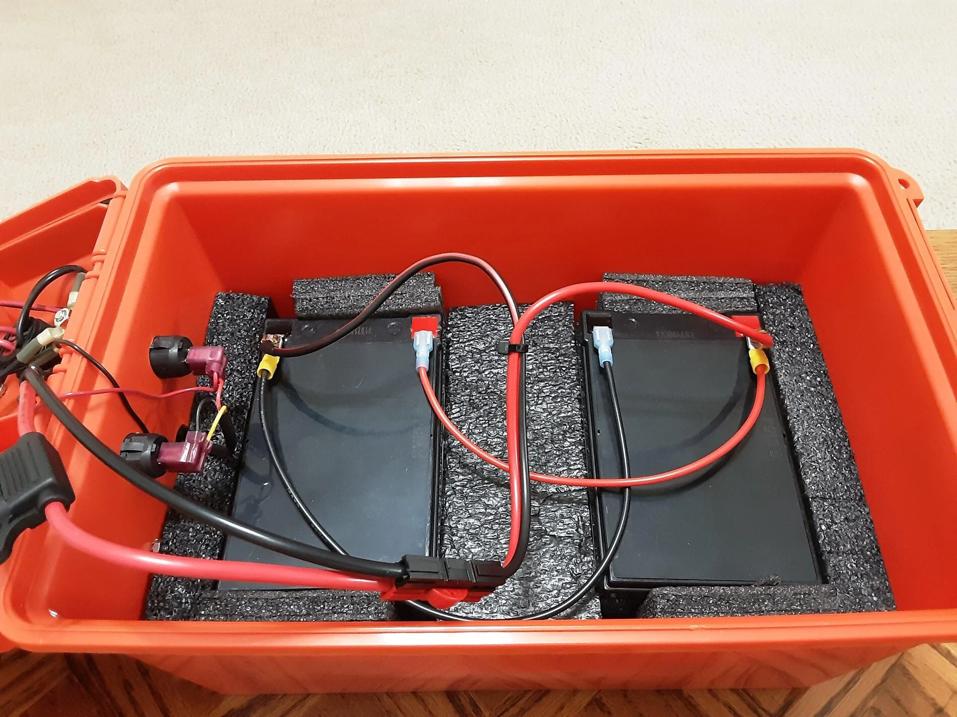

Yes, there's 2 batteries inside running parallel. The Powerbox is designed to run off of Lithium Iron Phosphate batteries. But they are VERY very expensive. ( one is nearly $700) So I did some modifications so it can use lead acid batteries. All I did was remove the large power adapter and placed the smaller Anderson powerpoles. All I want to do is charge up my phone and use the light for emergencies.
Head to this site. ----> https://powerwerx.com/ You'll be like a kid in a toy store!! :p
Here's a direct link to the powerbox.
https://powerwerx.com/megabox-portable-power-box-bioenno-batteries
If you want to build your own, There's a few on Amazon I recommend.
https://www.amazon.com/gp/product/B003DJUXES/ref=ppx_yo_dt_b_asin_title_o00_s00?ie=UTF8&psc=1
That one above has a lid to hide the panel mount USB ports. And it has a tray inside.
This one below is smaller. It comes in many colors.
https://www.amazon.com/gp/product/B07BWTMC6J/ref=ppx_yo_dt_b_asin_title_o02_s00?ie=UTF8&th=1

No, it can not jumpstart the Ranger. It's not designed for that.
Here is a picture of the modification. You can pretty much see what is needed.

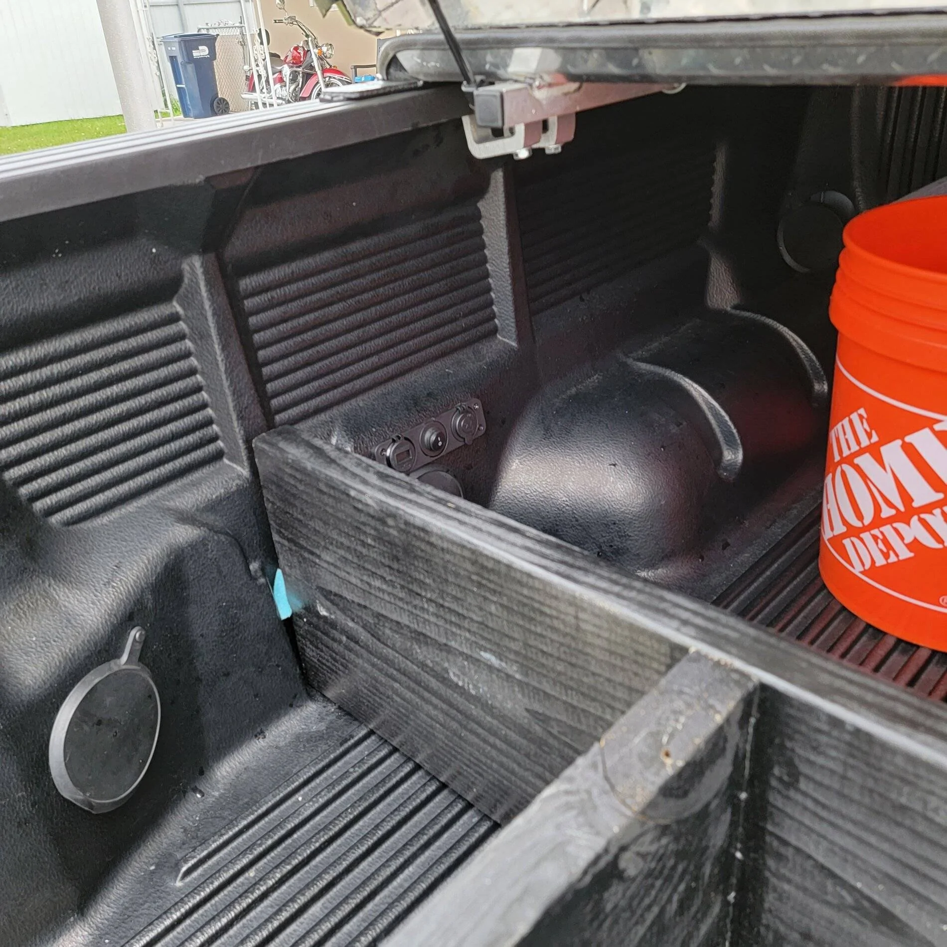

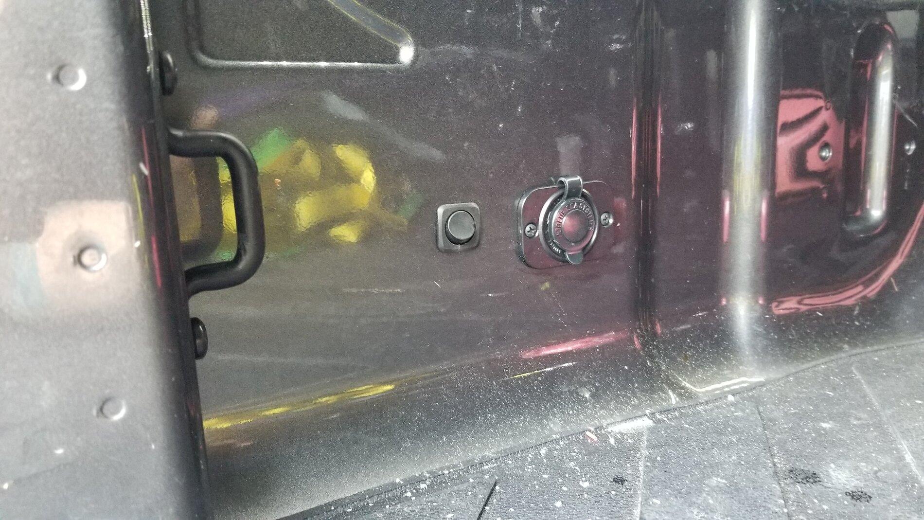

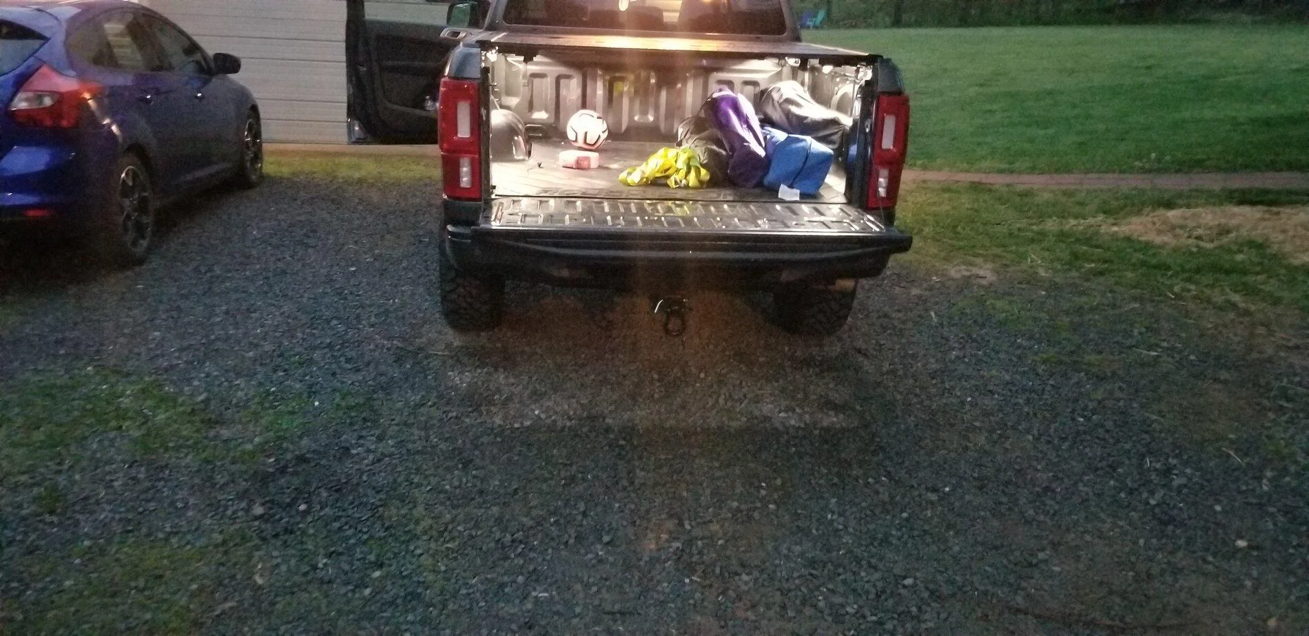

Finished a little DIY bed lights and 12 volt outlet. Used some leftover stuff from work. Turned out nice and the price was right free
Sorry soccer stuff for kid still in back.
Awesome, thanks!

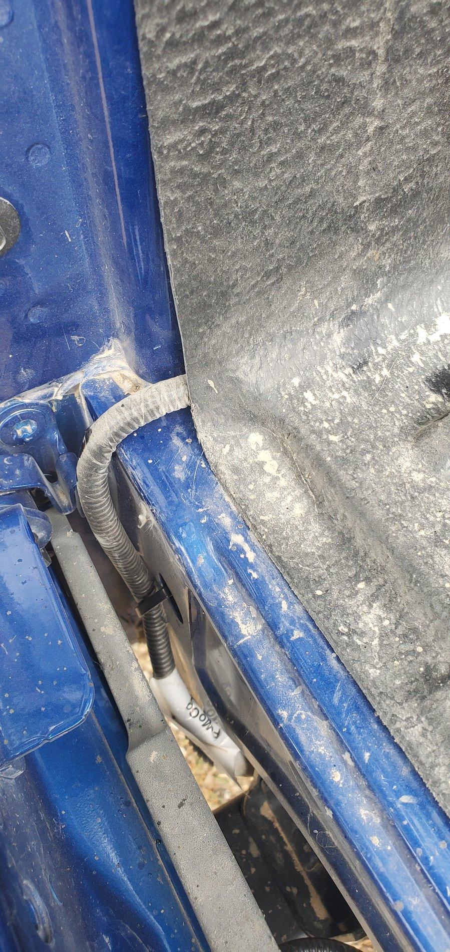

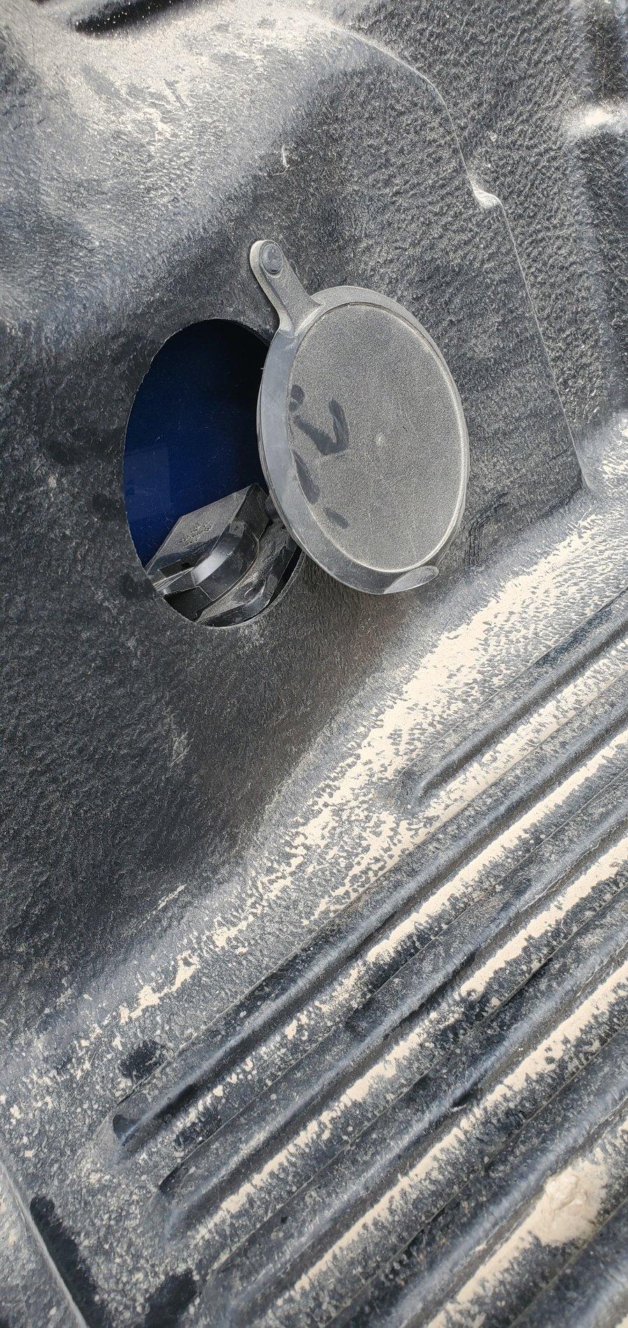

I didn't want to put any holes in my bed, and I have a drop in bed liner so I just rerouted the wires around instead of through. I think there is enough room to mount the socket in the bed liner itself under the access hole for tye downs.
Have you mounted this on the plastic yet?

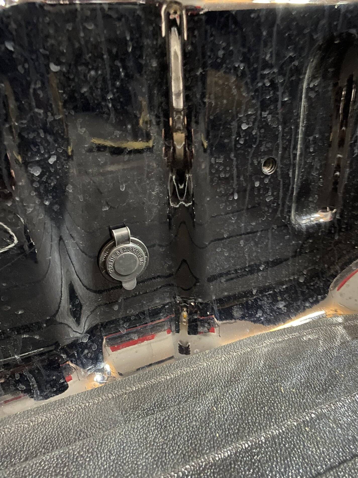

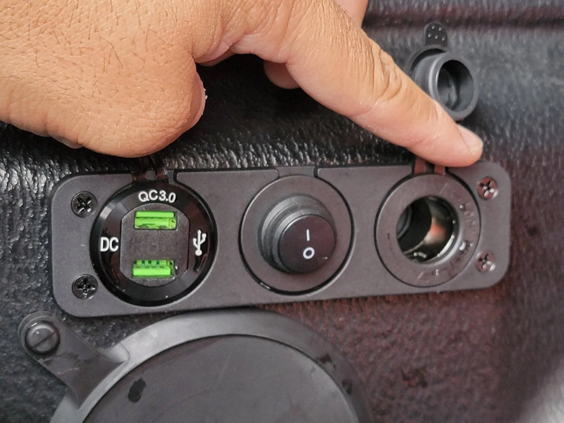

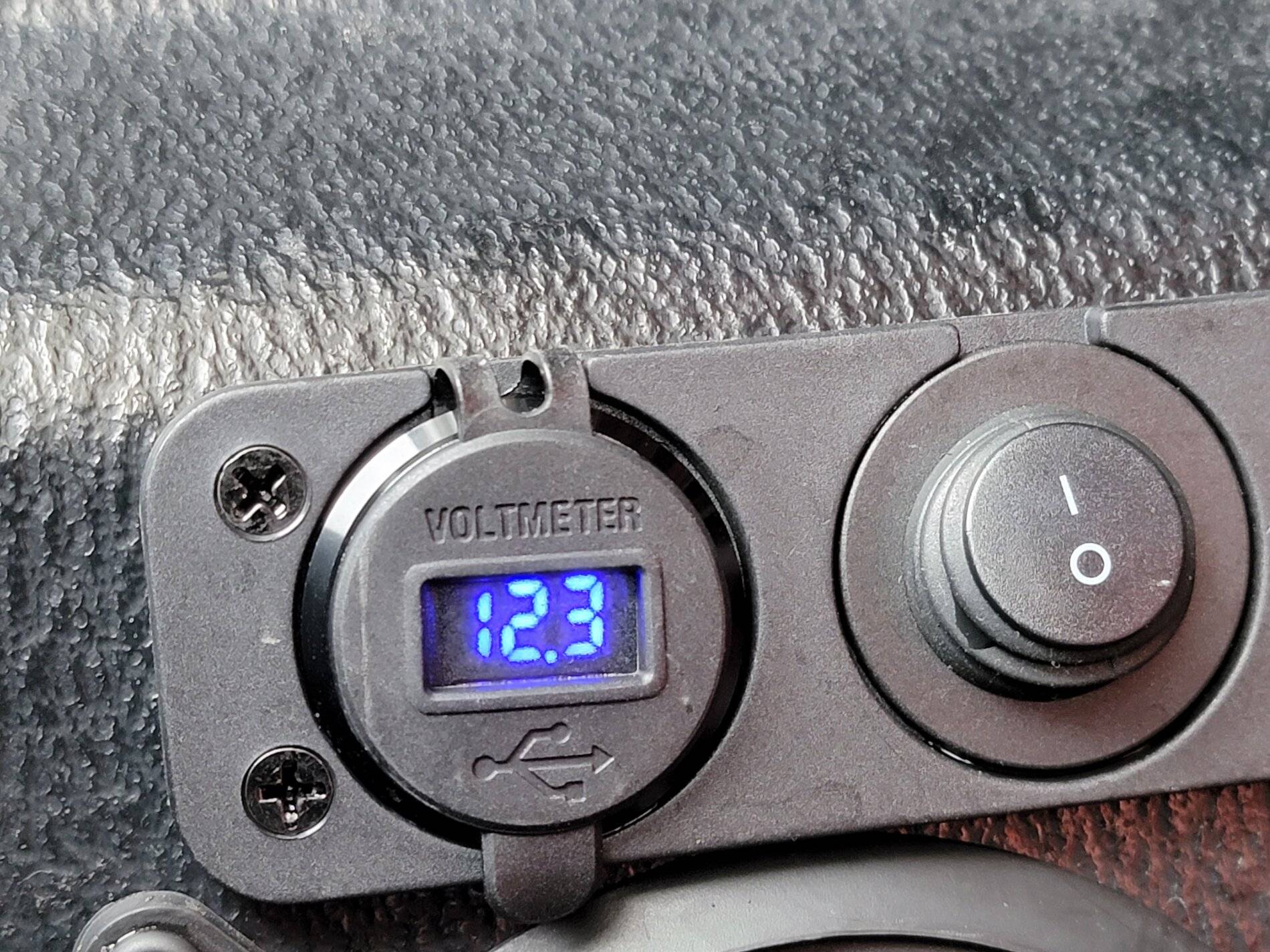

OK so finally I got my setup. I bought and returned the Ford 12v outlet ($35-$50), I bought the cabling, cut the end off on one side and wired this. Seemed the Ford outlet was super huge and really wouldn't fit anywhere unless you had no bedliner and cut out a hole in the metal of the bed.
I decided to go with placing the plug there, because there is a space for a tie down (fuse easily accessed through rubber seal), it will never be used because with the diamondback Toneau I can toss stuff on top of the toneau up to 1600lbs or the full weight of what the bed can hold and if I did for some reason need to tie something down inside, there are hooks on the 4 corners of the bed and they aren't obstructed.
For those that said the switch only works with the truck on, I can confirm that isn't true. It shows 12 when truck is off and 14 when truck is on.
If you decide to go with something like this, I recommend switching out that glass fuse. Also know that you don't need to install the panel you can put the outlet plugs where ever you want,I almost did it without, might have been a cleaner install and I could have probably put the switch on top with the 2 plugs below if I did such.
First off, Nice install and LOVE that cover.
But the power WILL time out - its controlled by the same Forscan setting that sets the interior USB ports. So unless you changed this setting in Forscan it will turn off after 1.5 hrs.
Try and see if you have power 1st thing in the morning.
Thanks, and yes you are correct I forgot to put that part. I just meant it can be powered without the car on, some were stating its off as soon as the car is off.

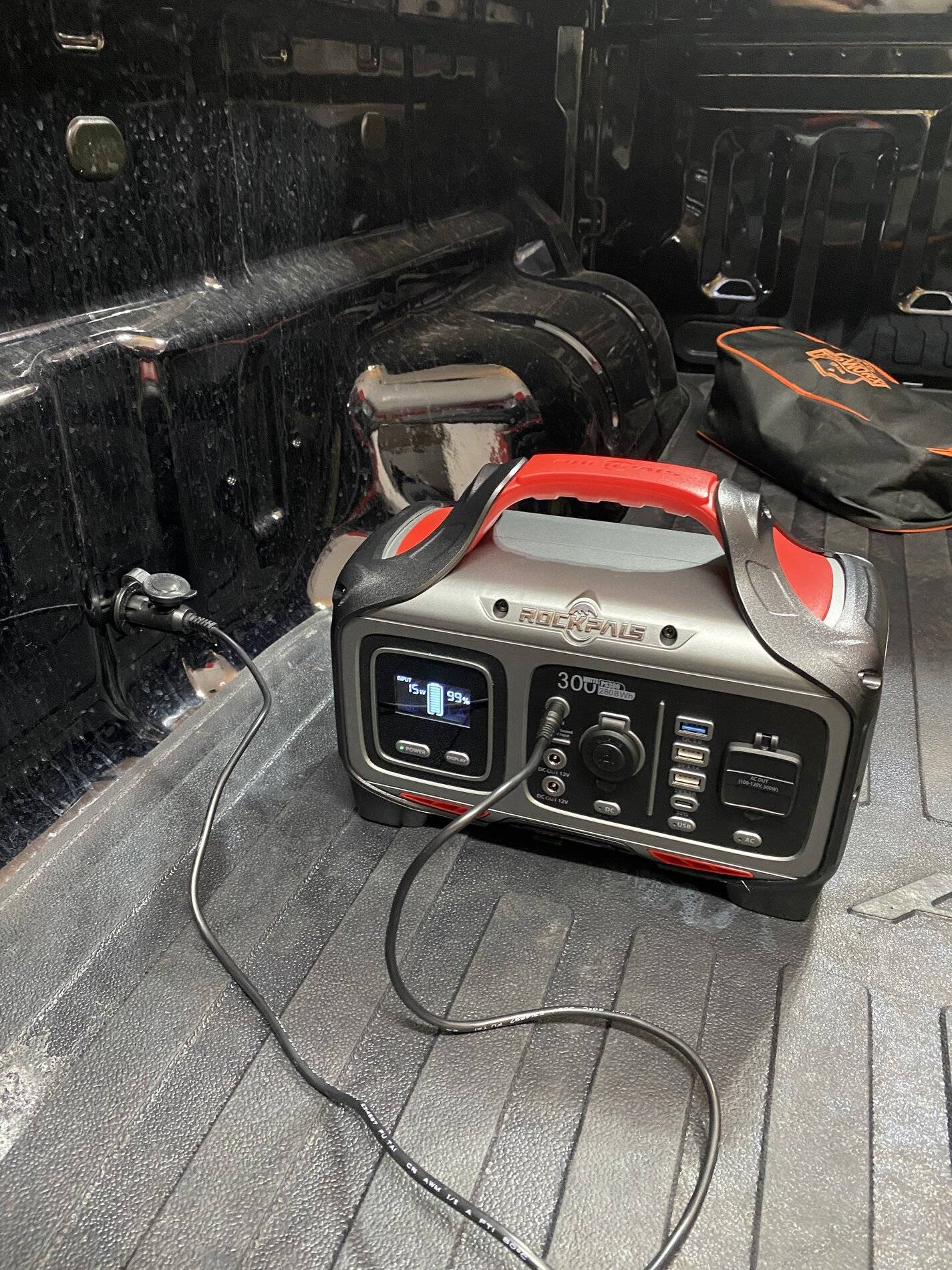

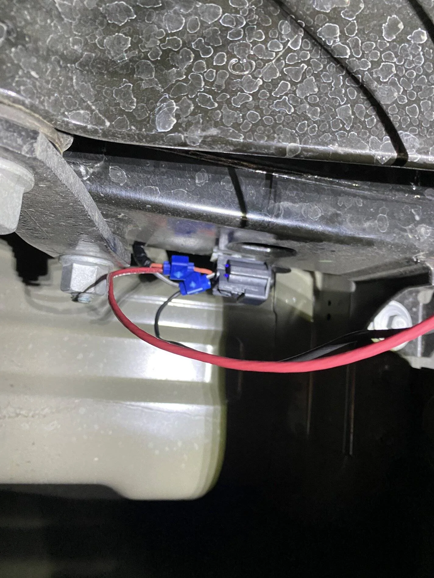

I completed mine today. Best of all, it was free since I had all the parts already from a previous project I never completed. Works great. I just tapped into the existing wiring. I did cover the wire taps with electrical tape after the picture was taken. Easy job.
If anyone is wondering, the fuse for this is 20A and it’s the number 17 fuse in the engine compartment.

Any comments on that power station? I’ve had a Jackery 300 in my wishlist for a while, but yours is a bit easier on the wallet.
