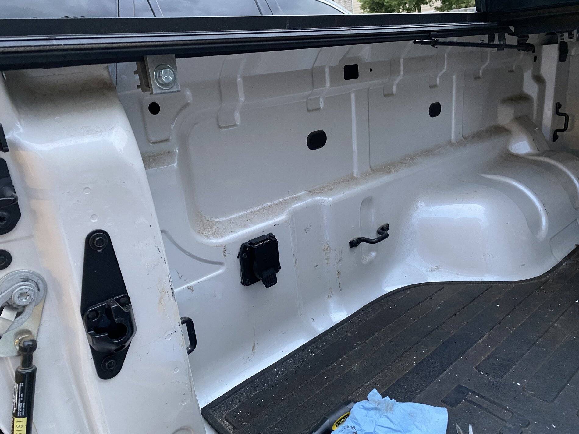

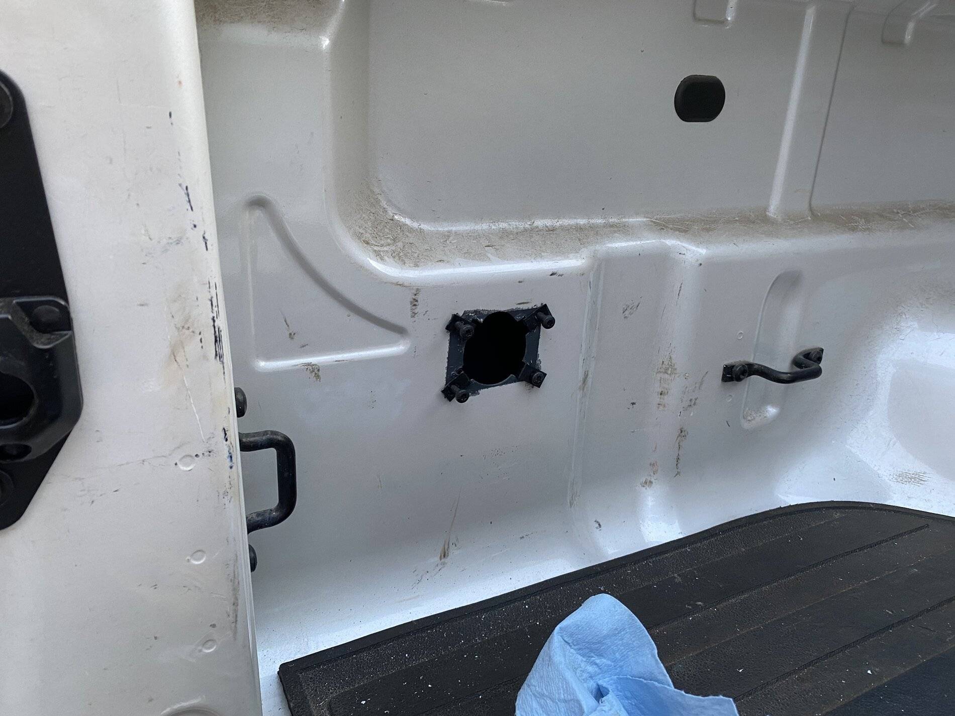

Ok for the install you will need a 2-1/8” hole saw, 5/16” drill bit, flat and round file, Rust preventative paint of your choice.
Drill a 2-1/8” hole in the side bed wall near the left rear cleat. (See photos below) Use caution when drilling or you will end up with dings protruding from your outer fender. You can position a block of wood or stuff a bunch of rags up into the cavity from below to orevent damage.
Insert the power port body into the opening and mark the location of the 4 screw holes. Drill 4- 5/16” holes. Debur all holes using a round file.
Using a flat file, in the large opening, create 4 flat areas adjacent to the 5/16” holes. Insert the 4 captive nuts into the body with the threads inboard the fender. Paint all exposed metal with rust preventative paint.
Install the sub-harness onto the socket and feed the wire down the inner fender well. Install 4 retaining screws.
Under the truck, remove the dummy plug from the body harness and insert the power port sub-harness. There is one large hole on the sheet metal pillar opposite the tail light cavity for the “christmas tree style” zip tie retainer that is included on the sub-harness.
I ended up adding a few extra zip ties to secure the wiring.
Thats about it. Time-about 30 minutes.
Pics below...

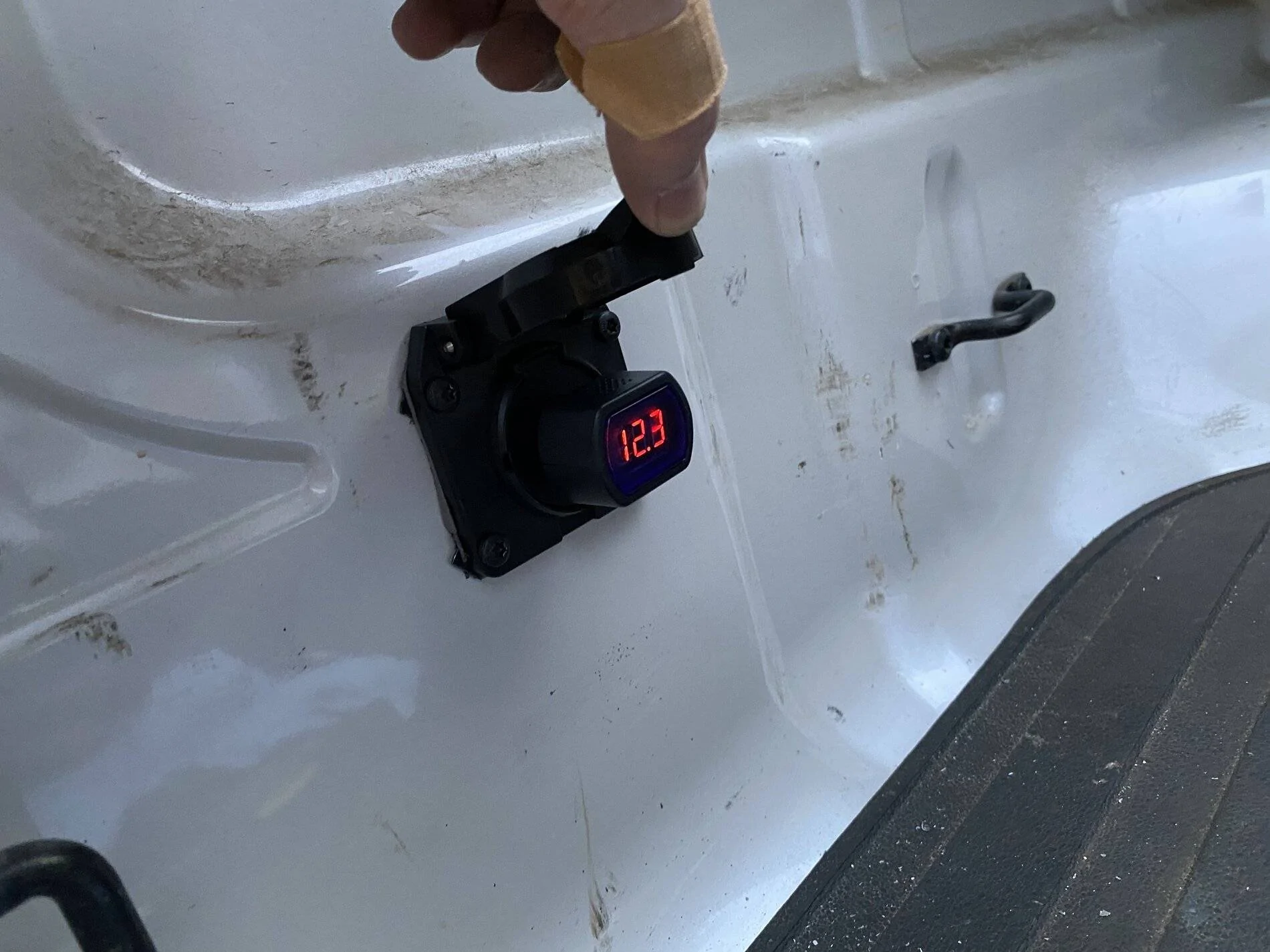

I completed mine today. Best of all, it was free since I had all the parts already from a previous project I never completed. Works great. I just tapped into the existing wiring. I did cover the wire taps with electrical tape after the picture was taken. Easy job.
So looks like you just tapped in before the outlet. I was thinking about rigging something to use the existing pins, but your approach is simpler. Something that threw me is that the wires look like they are 14 gauge or there about. For reference, my aux battery box came with 6 gauge and my solar input is 10. (It's becoming clear that my overland battery setup is probably waaay overkill, lol.)
Anyway, the chart below seems to indicate that for that length of run you'd want 10-12 gauge.
